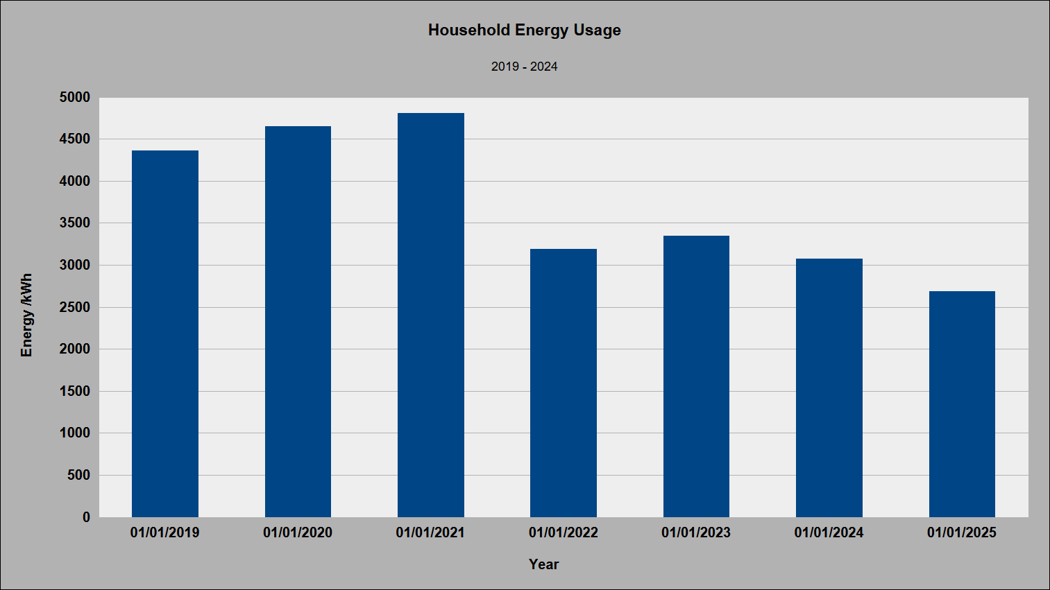

I have done it.
Take me 20 years, but very little cash to to reduce my household energy use to below 3MWh.year-1.  When I first moved in, it was around 11 MWh.
This last year, I used 2,780 kWh.  That is 335 kg of CO2.
Feeling pretty chuffed about that as I have been warm, but never too hot, fed and bathed.
If you are wondering why there was a big drop from 2022, that is because I fitted my home made secondary glazing (making my windows triple glazed).
Good effort @SteamyTea using around a quarter of what you used to consume in the same gaff is no mean feat.
What was the main driving force? CO2 emissions or cost reduction?

Mainly the challenge and CO2.
The grid intensity CO2 is outside of my control, but then I started it was around 0.7kg.kWh-1.
Initially I saved 30% by just managing my usage better.  That was a no cost option.
Changed to LED lighting (less than £30).
I then started by spending some money, mainly £60 on some digital timers to limit my E7 window better (heat up in the last 4 hours rather than the first 4 hour).
Then extra loft insulation (still got some more to add).
Then I started the miserable job of draughtproofing, cheap to do, but time consuming.
Then the secondary glazing (less than £200 for all but 2 windows, so 12 windows in all.  Left 2 windows for escape routes).
I also reduced parasite loads.  This really involved making sure any standby loads were very low.  Getting rid of a desktop PC and using laptops has made the biggest difference.
There were setbacks, mainly my lodger who, until I beat her with a pointy stick, would stand under the shower till the water went cold.  Eventually she learnt her lesson.
