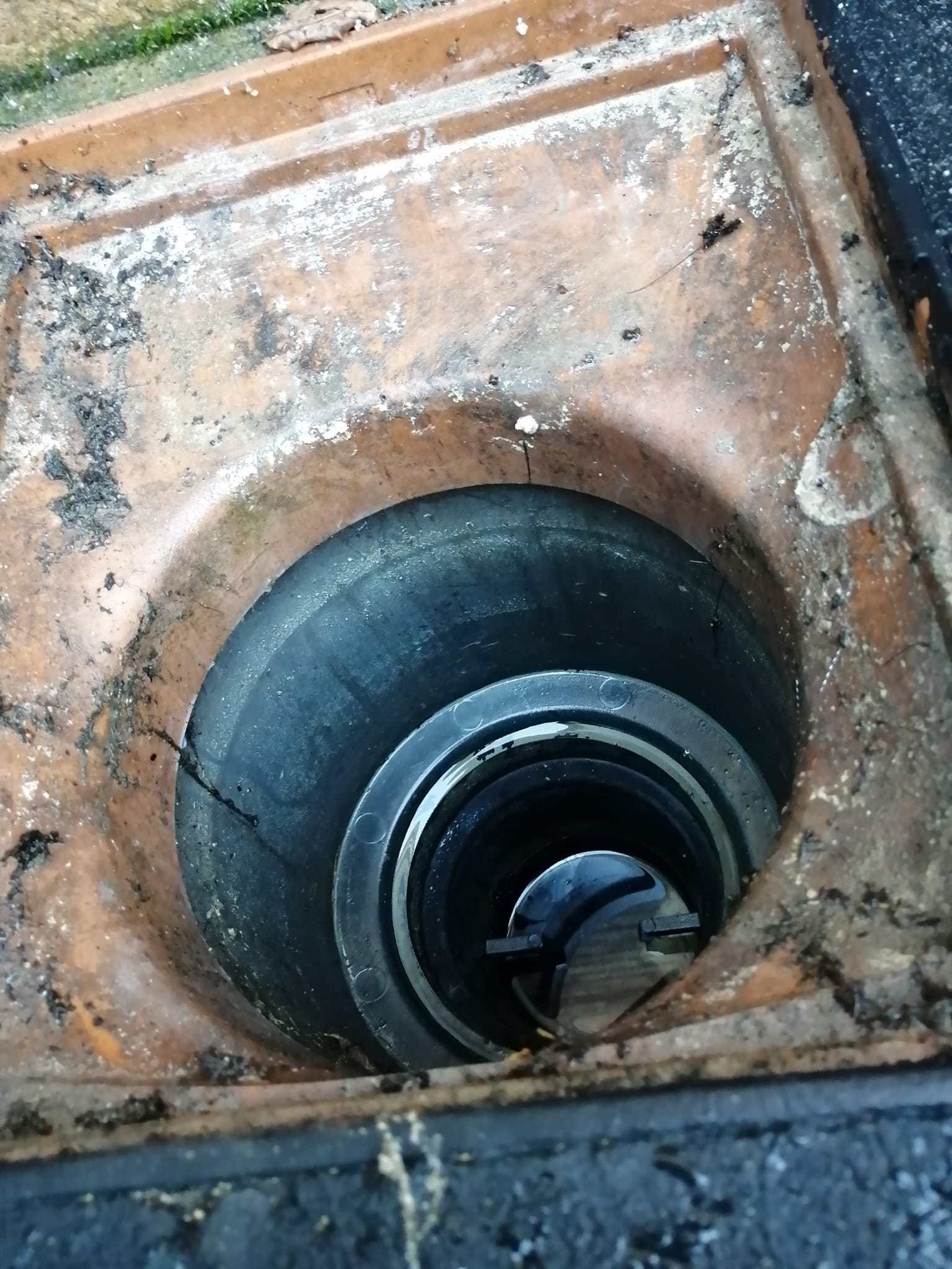

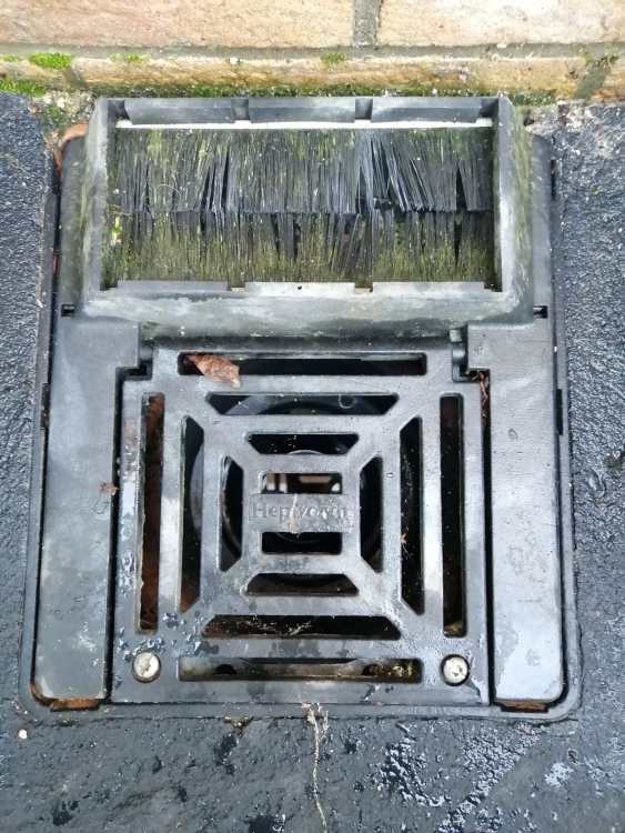

Egnaro Posted 19 hours ago Posted 19 hours ago Had a Boxing Day blockage from the kitchen sink gully. Gully was fitted in 2002 and no longer available, I can find no info on this gully. Pic of cover and under cover if it helps.
Russell griffiths Posted 14 hours ago Posted 14 hours ago Stick your hand down it and yank out that black thing, I think it comes out. 1
dpmiller Posted 4 hours ago Posted 4 hours ago yep, that is the "bucket" that makes the gully a trap. 1
