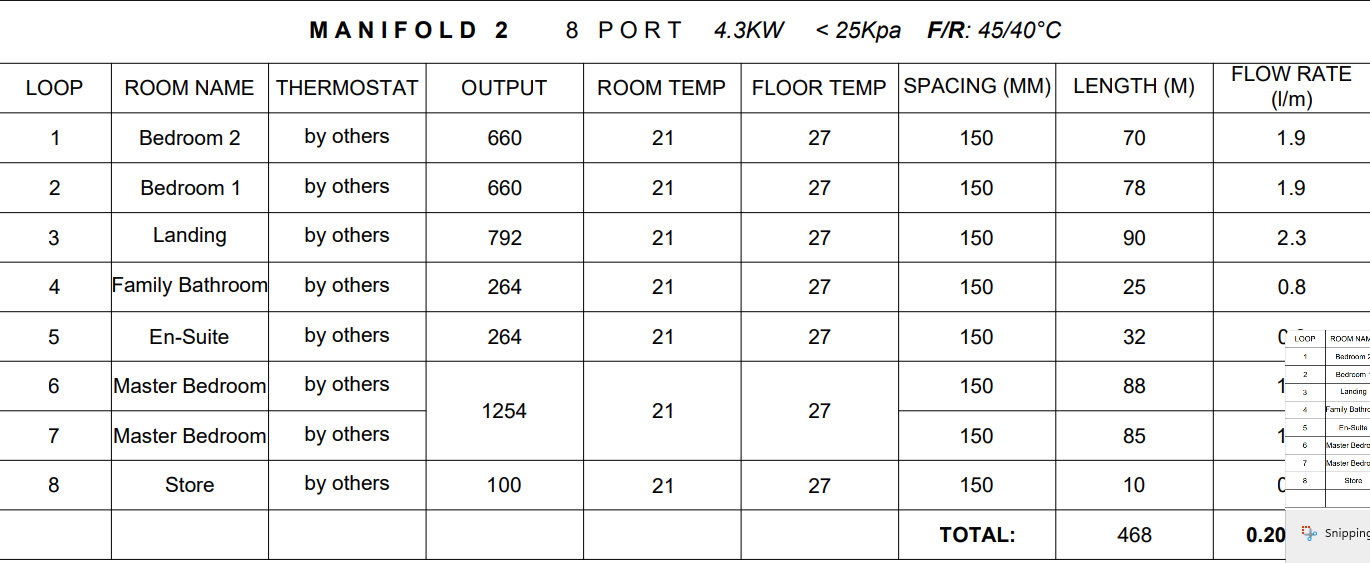

Just to resurrect this thread. I am going to pay more attention before I go any further with the install. I am going to go back to the suppliers for more information but to get me started, I need to make sure I understand what I have to establish.
To take the figures from the UFH supplier:
If I add the output column for this floor I get a total of 4026. Is this 4kw of heat output? With similar for the second floor that is close to 8kw. A house with a supposed heat loss of 3.2kw this seems too much. But I presume this is with a flow temp of 45 deg (45/40, is this flow temp and DT?)
I guess I am going to have to calculate the output with a flow temp that matches my heat loss? This would presumably determine the flow temp of the heat pump and therefore the required size of the heat pump.
Am I on the right track or wildly mis-understanding things. Let's start with this given that everybody is so helpful.
I need to look closer at how the heat loss was established, the SAPS printout doesn't help me because it is hard to decipher but I am working on a 3.2kw heat loss for the house at the moment which I guess is about right.
Yes, you're almost there.
1. You must confirm your calculated room-by room heat loss - this is the foundation of everything.
2. You then take each room's floor area and divide the room's calculated heat loss by the area. This gives you a W/m2 value.
3. You would then normally use this W/m2 value to determine the pipe spacing and output for each room, getting the flow temperature as low as possible
Unfortunately, the UFH has already been installed in your ground floor, but you can work around this using both mean water temperature and flow rates through the system.
At present, assuming the 3.3kW heat loss is the correct value the UFH system you have had designed and partially installed would output this at a mean water temperature (flow temp+return temp/2) of around 27C - obviously this is just an averaged value as it just divides your heat loss by your total floor area of 158m2. This gives about 21W/m2 that the underfloor heating needs to produce.
The advantage you have here is that the spacings are pretty close and this means you have the opportunity to run your heat pump at low flow temperatures.

48 minutes ago, jimseng said:
Where do I go from here?
 Here's a single sheet spreadsheet you can use that covers all the basic heat loss calcs. Should be fairly self-explanatory. I built it using open document format so it runs best in LibreOffice or similar, but excel will be fine even if it then throws up compatibility errors. For the whole room losses you need to calculate all walls, ceilings/roof and floor and then air change rates. If you have a solid ground floor, room temp - 7C for design temp difference should be fine although some regions say 10 is fine. For any part walls, which I assume you may not have, use your target room temp - 10C.
For your air change rates, with MVHR, 0.5 is the max you want to go for.
Internally, with a well insulated home with MVHR, you can assume no difference in temperture between rooms so those internal walls/ceilings/floors can be set to 0 losses, unless you want to have different temperatures, then you need to input U-Values and temperature differences between those rooms.
Have a crack at it and let us know.

So what are the individual room loss the installer calculated?
This is what I had in the initial estimate. But, under advice from my plumber I decided to go with another UFH supplier and this is probably my first mistake. Having never built a house before or had an ASHP before I was ignorant of the calculations necessary or how necessary and involved the design process is. That is why I am here getting help trying to figure it out. I should have paid more attention at the beginning! I am thinking that these heat loss calculations probably aren't way off the mark.
However, it is obviously a different UFH system that has been installed. I suppose if I can work out the heat output for each UFH loop in a room at a given flow temperature, taking these heat loss figure for now that would help me pin down a target flow temp for the ASHP. Is that a reasonable approach?
Really wouldn't to hung up on the UFH that has been installed, you will have ample output.  Just follow some basic steps to commission it
Set all flow meters at full flow. Start with a WC curve something like 20 flow at 15 outside and 30 at -3. Once you have the heating on leave to heat soak for 24 to 48 hrs. Any areas that are too warm, trim the flow rate down for the loops in those areas.  If everywhere is too warm, trim back the WC curve at the cold outside end. If everywhere is too cool, add flow temp to cold outside end. Just a bit of a balancing act.
