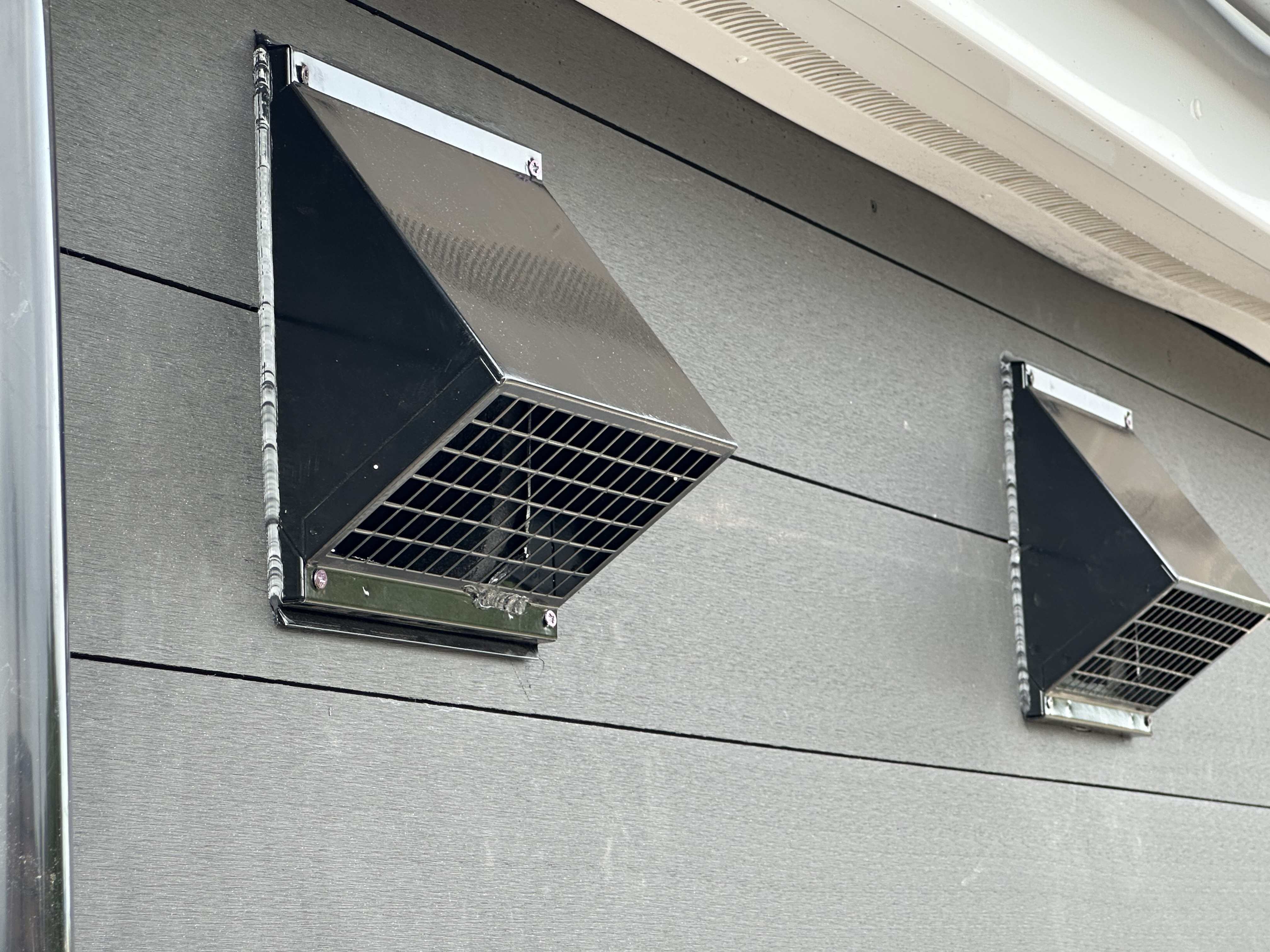

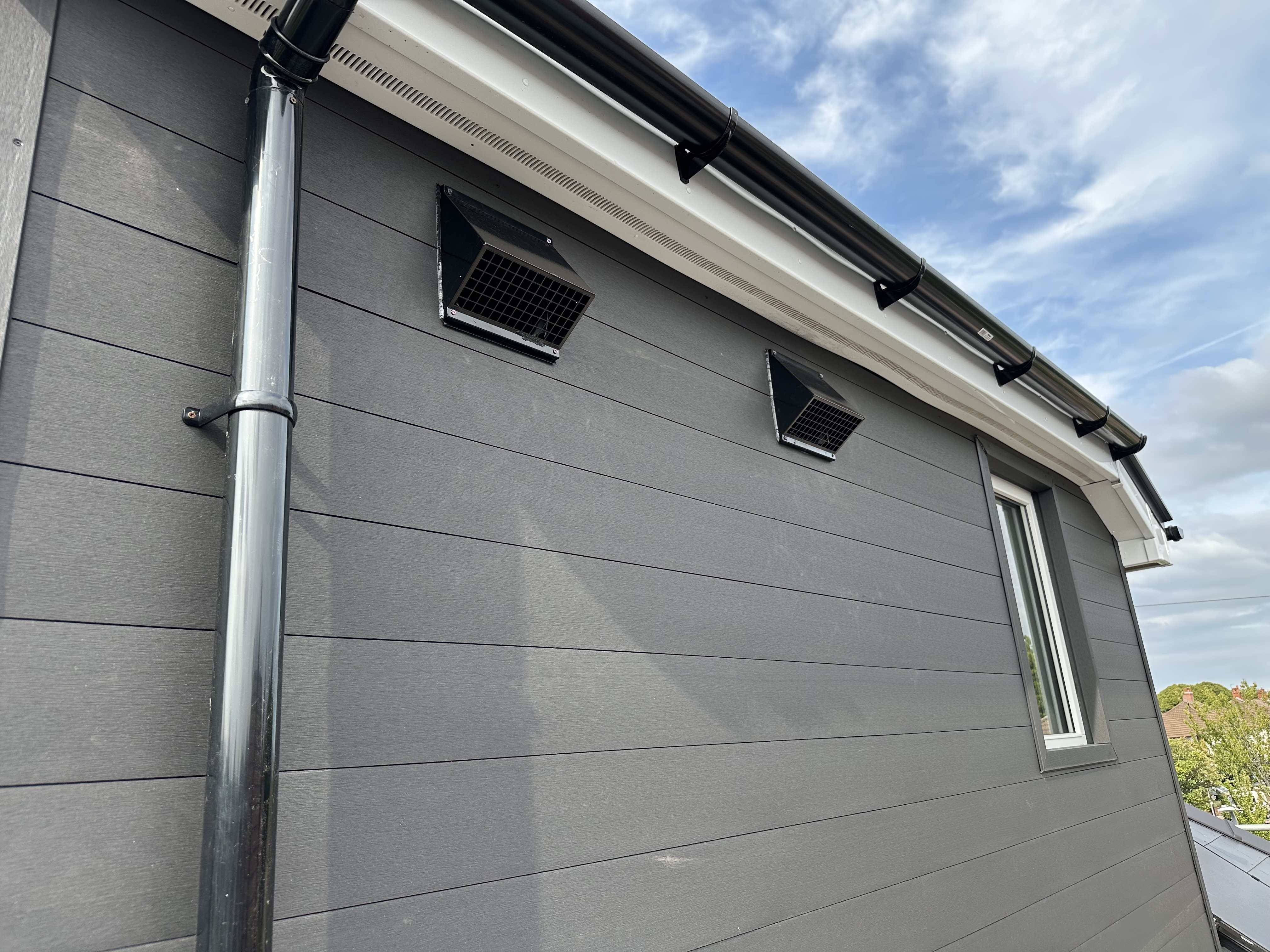

Nickfromwales Posted 13 hours ago Posted 13 hours ago Fitted these on a good few jobs where driven rain was expected to be a factor to mitigate against. These were for 180mm ducts.
Nickfromwales Posted 13 hours ago Posted 13 hours ago And before the crowd mobs me, that was the size of the plant room and the designer confirmed that those being close was a non issue (considering these can be in one dual terminal).
