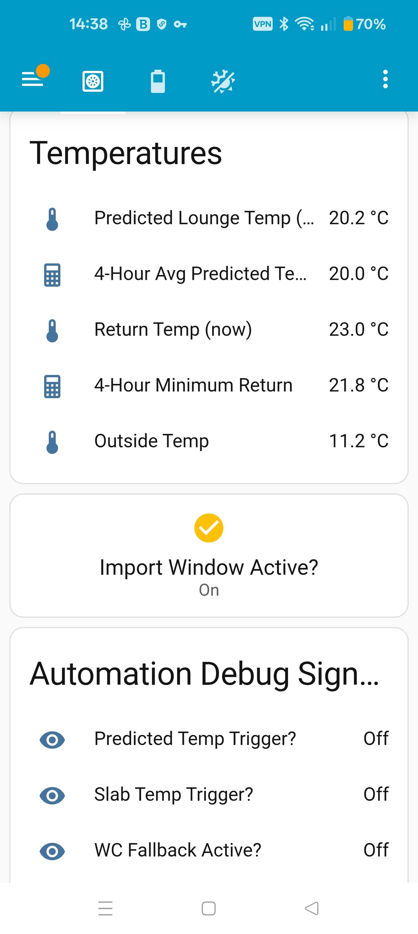

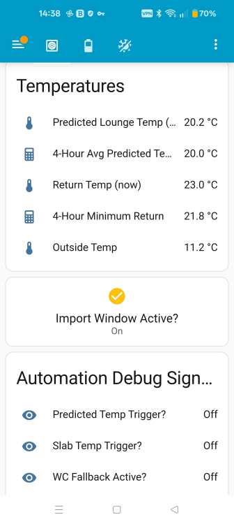

JohnMo Posted December 9, 2025 Author Posted December 9, 2025 So this is the small dash board on home assistant. I have a target temp set at 20 degC. The yaml code for the prediction automation, this just sends a notification to me if we are running to cool.in the house to see how it works. If connected to an output devise and house was likely to be too cold, ASHP would be started at a flow temp higher than the normal WC curve. alias: ASHP Batch Charge Based on Prediction and Slab Temp description: Batch-charge UFH during cheap windows using predicted + slab return history triggers: - at: "04:00:00" trigger: time - at: "13:00:00" trigger: time actions: - choose: - conditions: - condition: time after: "04:00:00" before: "07:00:00" - condition: or conditions: - condition: template value_template: | {{ predicted_min_4h < (setpoint - 0.35) }} - condition: template value_template: | {{ (return_now - return_min_4h) < -1.5 }} sequence: - action: notify.mobile_app_cph2449 data: message: "Batch heat started test " - delay: "03:00:00" - action: notify.mobile_app_cph2449 data: message: Batch charge finished test - conditions: - condition: time after: "13:00:00" before: "16:00:00" - condition: or conditions: - condition: template value_template: | {{ predicted_min_4h < (setpoint - 0.30) }} - condition: template value_template: | {{ (return_now - return_min_4h) < -1.5 }} sequence: - action: notify.mobile_app_cph2449 data: message: "Batch test " - delay: "03:00:00" - action: notify.mobile_app_cph2449 data: message: Batch charge finished test mode: single variables: setpoint: 20 predicted: "{{ states('sensor.lounge_predicted_temperature_in_1_hour') | float }}" predicted_min_4h: "{{ states('sensor.4h_min_predicted_lounge_temp') | float }}" return_now: "{{ states('sensor.emoncms_emoncms_org_heatmeter_returnt') | float }}" return_min_ 4h: "{{ states('sensor.4h_min_return_temp') | float }}"
JohnMo Posted December 9, 2025 Author Posted December 9, 2025 Details of some of the template sensors This is the import windows defined - have only use morning and afternoon slots binary_sensor: - name: hp_import_window state: > {{ now().hour in [4,5,6] or now().hour in [13,14,15] }} Predicted trigger state sensor: - name: hp_predicted_trigger state: > {% set p = states('sensor.lounge_predicted_temperature_in_1_hour') | float(99) %} {% set setp = 20 %} {% if (p < setp - 0.3) and (is_state('binary_sensor.hp_import_window', 'on')) %} on {% else %} off {% endif %}
