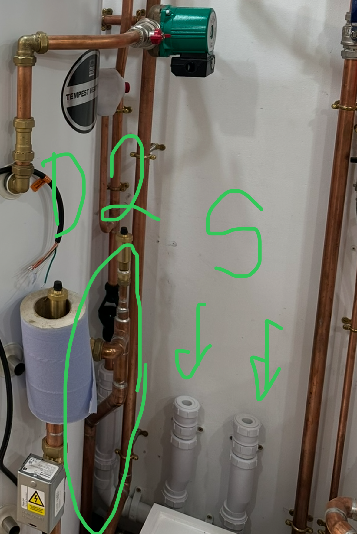

Yes that makes sense. So "b. be a separate branch pipe with no sanitary appliances connected to it;" means (not implies) the D2 pipe is a branch pipe itself? Hope that helps @Nickfromwales :)
I only ever do a pair of D1 max into one D2 and that goes to one trap on one branch off the stack where practicable.
Theres no problem if its a 40mm pipe coming off that picks up more than one trap, and the other traps collect water from appliances.
See here where D2 is on a 40mm run that picks up both discharges from the softener that sits in that chair.
Nowt wrong with this setup.
