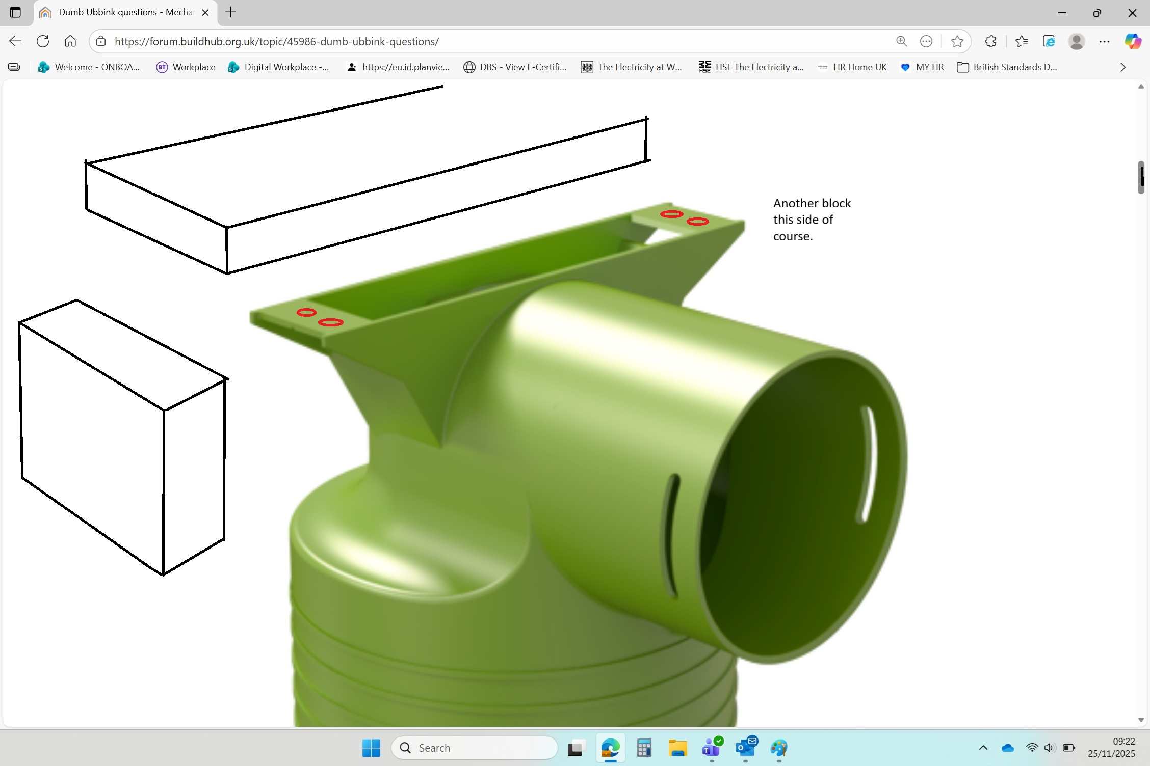

+ This valve adaptor. It doesn't have obvious fixing points or instructions. Do people cut it off at one of the annular rings and mastic it into position or use that odd horizontal piece on top somehow? Both?

Yeah it's a weird design, isn't it? I'm sure I saw a bracket at one point, into which those flat bits at the top would slide. But I can't find it now. Maybe I dreamt it?
Anyway, I just drilled holes in the flat bits!
I think it's designed to fit the other way round, so a floor rather than a ceiling and then just gets screeded in place.
Ah
Ah, yeah, now you point it out, it looks likes it designed for that way up. They might have said... or had a picture like that on their web site. Maybe their marketing people didn't understand it either.

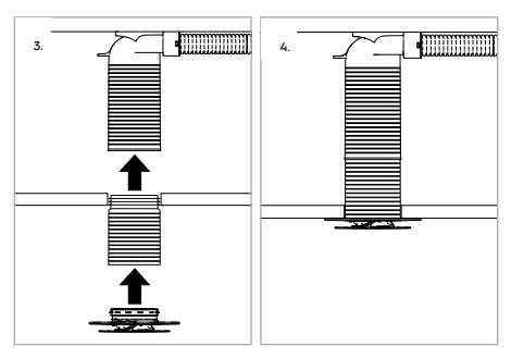

I see that the Valve Adaptor Extension says 'Simple to cut to desired length for seamless customization' so presumably the ribs on the Valve adaptor are meant to indicate that you can cut it to length. And, hey presto, it has a picture of the valve adaptor hanging from a magic support above the ceiling and ending up flush with the ceiling plasterboard. That's clear then...

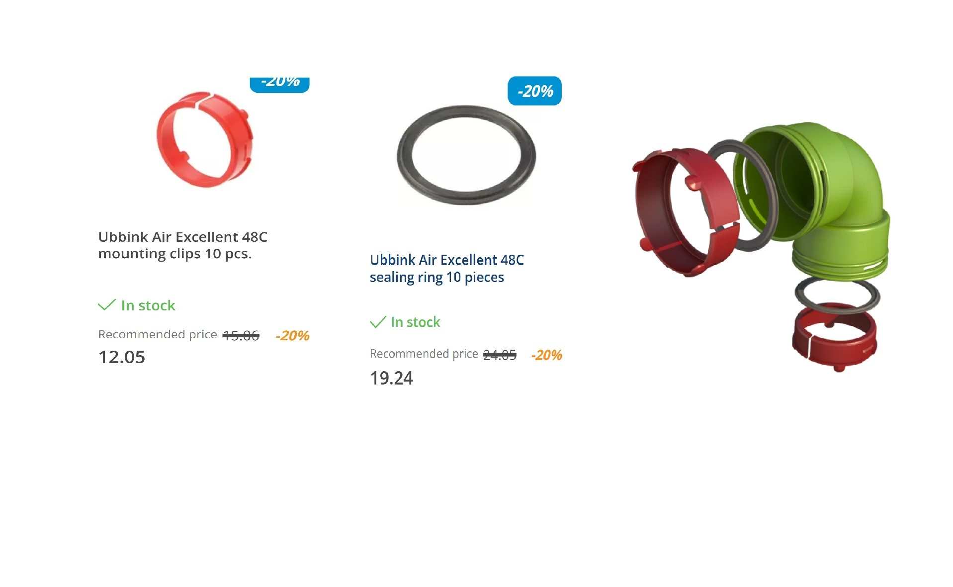

I have just been through this pain most of this year while installing mine.
For the first floor ceilings i had to build a wooden 'bridge', screw the piece to it and then mount between the rafters. In my case the blocks were 85mm tall. I chose that height so that the opening at the bottom was either flush or 1-2mm up inside the ceiling plasterboard.
Dont forget the gaskets around the Ubbink part for your airtight seal. They are not cheap.
I have 250mm posi joists downstairs so there was more room to play around. Still had to screw in a mounting block for the piece to screw up into though.
Most of my orders for bits took about 3 weeks to arrive from Holland. I was not organised enough to plan out and remember all the other bits i needed so multiple orders were needed.Ubbinkmod.thumb.jpg.5cf614d3988611144f09f6bc602043e0.jpg
It all fits together like this.  Its a very positive and secure 'click' when it goes together.   I have used an adjustable ceiling grill in my house which i hope will allow enough adjustablilty  to mean i dont need to use the restrictor rings that come with the distribution box.  If you think about it, using those means you need to open the distribution box for every minor configuration tweak. All of your ducting will be connected to the box and i imagined this would be a nightmare.Ubbinkputitalltogether.thumb.jpg.2e50e802f00033fa89786401714820be.jpg
Yes, those ribbed sections are 1cm apart, so you can cut it to length. I ended up doing this all over, with good results!
I even used one of the off-cuts to extend another section where I needed a longer section, joined with a regular metal-with-rubber-rings piece, as the 125mm plastic pieces fit together perfectly with the 125mm spiral ducting pieces.
