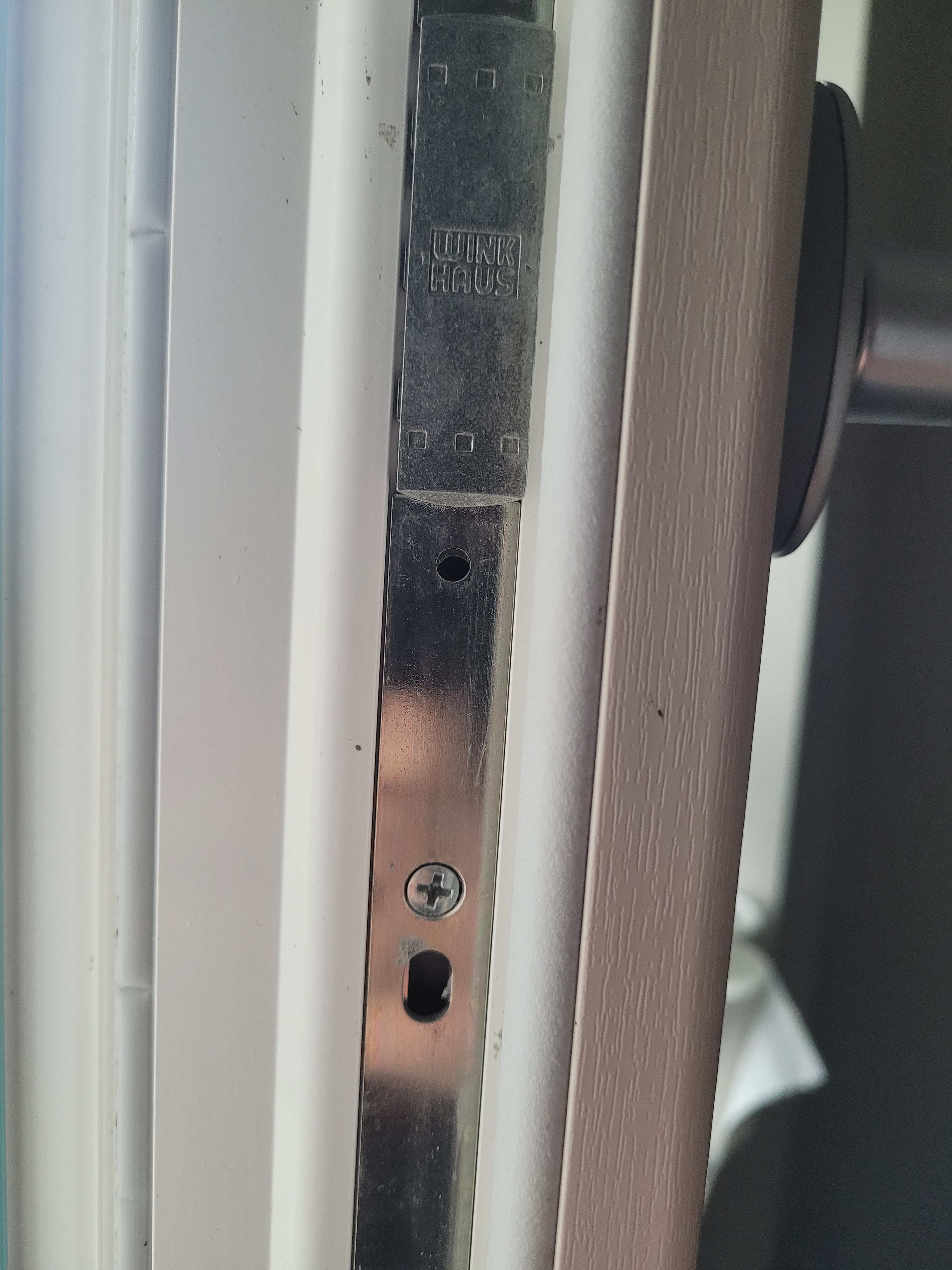

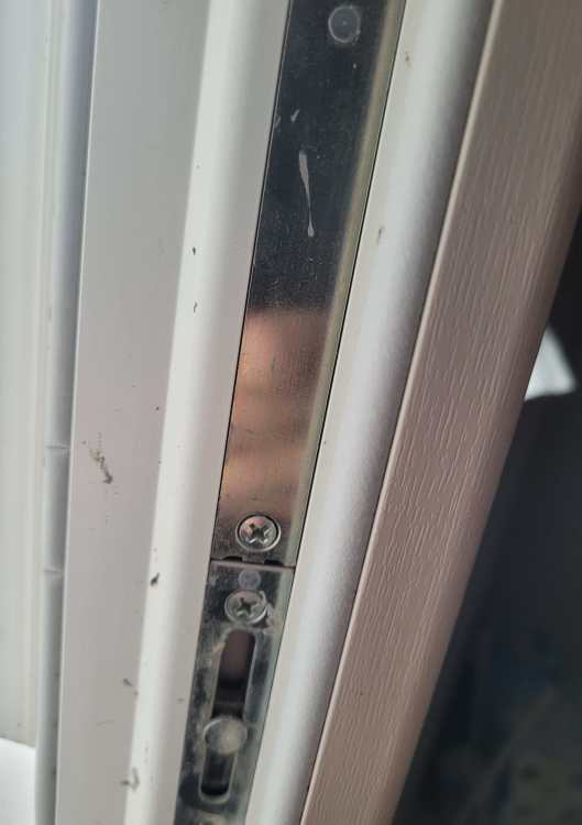

JackofAll Posted November 24, 2025 Posted November 24, 2025 Hi all, Anyone with internorm windows notice the seals appear to have pinch marks on them like below grey seal.
craig Posted November 25, 2025 Posted November 25, 2025 I don't see any seals on the pictures supplied but I do see the gearing mechanism and in particular the mushroom pin on the first picture. It "may" be that the sash is needing adjusted in width/height as the pin is to close to the locking keep.
Mr Punter Posted November 25, 2025 Posted November 25, 2025 What is the problem? Are they letting in air / water?
craig Posted November 25, 2025 Posted November 25, 2025 2 hours ago, craig said: I don't see any seals on the pictures supplied but I do see the gearing mechanism and in particular the mushroom pin on the first picture. It "may" be that the sash is needing adjusted in width/height as the pin is to close to the locking keep. Numpty was on his phone and couldn’t see them for looking at them and they’re grey. So it is clear I now need glasses. Still reckon to low or too much to the side, meaning a slight adjustment required.
JackofAll Posted November 26, 2025 Author Posted November 26, 2025 @Mr PunterNo issues regarding leaks, it just doesn't look right. @craig can't see anything that would cause the seal to be pinched, will look into adjustment. I know every openings vary, is there a normal distance between the pin and the locking keep that you've noticed?
craig Posted November 26, 2025 Posted November 26, 2025 The adjusment is usually +/-3mm, the distance varies on system but HF410/HF510 you're look at 13.5mm distance between frame and sash (timber to timber), the keeper is roughly 8/10mm in height and the mushroom sits inside the keeper when locked. 1
