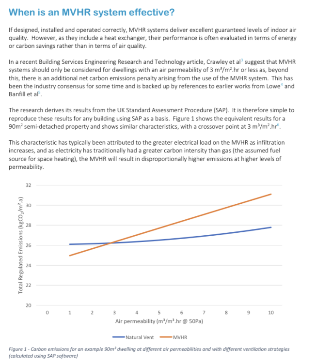

timhowes Posted 4 hours ago Posted 4 hours ago (edited) Noob here - please be patient! We are renovating an already-modernised 1949 rendered brick construction bungalow, adding 4 bedrooms and a bathroom upstairs. Timber construction first floor. Cold tiled roof. New windows. Major job. We had originally hoped to install MVHR, but I doubt we will be better than 3m3/m2.h - however, I have no idea really and this is purely guesswork. We aren't enveloping in a membrane and don't have PH ambitions (though will be generally attentive to minimising leaks). My latest plan is dMEV with humidity-actuated wall inlets, which will save money and, I imagine, perform adequately given the likely level of air-tightness. Our builder has suggested we can't assess this until the build has got to a point at which it can actually be measured - however, at this point I imagine it would be very difficult/impossible to re-design for MVHR if we found we were better than expected. I suspect dMEV is the best option, but please contribute if you think I've got this wrong! Many thanks Edited 4 hours ago by timhowes
JohnMo Posted 4 hours ago Posted 4 hours ago If you don't need to airtest I wouldn't, you end up boxing your self into a corner. Especially if you live in Scotland? I would progress the way you are planning. Tried a couple of dMEV fans in our summer house - Greenwood were head and shoulders better than other fans I tried. And cheap enough on eBay. Remember you need to have all internal door under cut at the bottom for dMEV to work correctly. I would add a co2 sensor to main bedroom as well so you can fine tune your system.
