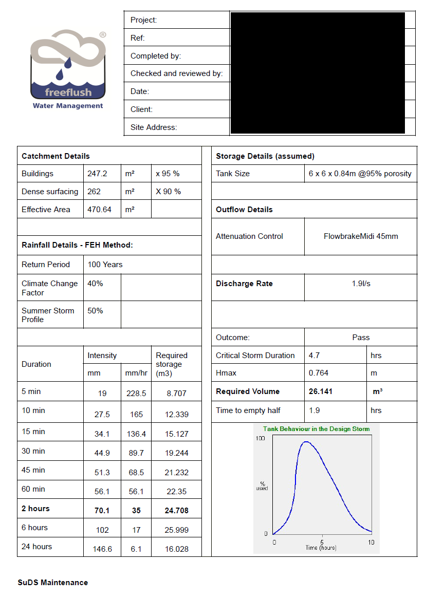

January 9Jan 9 OK this is fairly easy, although please take care to give the key relevant info when asking a question, otherwise you're asking us to write very long mostly irrelevant if-then-else replies. The most obvious questions are what is your drainage situation / what soil-type do you have / where will this drain to?. So: Pay 'Freeflush' £100 for the SUDS calc. You need to supply the plan area of your roofs and non-permeable hard standing and your location. Hint: make your hard-standing permeable and draining (using say, MOT3) to vastly reduce that requirement. That gives you your tank volume. Figure out whether you (a) want to use crates, tank, pond, swale, lake or Versailles-like water feature and (b) where it eventually drains to - ditch, culvert, soakaway, drainage field. You will need a soakaway test for the last two. Draw a simple drawing showing the arrangement. Check the levels and drainage fall if you're not sure. Add a short narrative written in the language of a 5-year old for people who don't understand numbers or drawings. Example calc below and no, you can't use those numbers.
