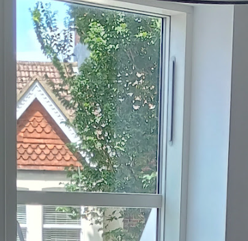

Mr Punter Posted November 16, 2025 Posted November 16, 2025 The Velfac and IdealCombi trickle vents are very similar. They are not visible externally. Internally they are metal and flush with the sash when closed and protrude when open.
allthatpebbledash Posted November 16, 2025 Author Posted November 16, 2025 2 hours ago, JohnMo said: If you have trickle vents replace for humidity activated ones. Click vents or any other manual vent will just get closed at some point in time and never be reopened. Humidity activated ones will be almost closed all the time, only when required for they open. While your at dump the intermittent fans and install dMEV one (Greenwood CV2 or 3) You should only have trickle vents in dry rooms not wet rooms, as they allow a short circuit of air flow if installed in a wet room Are you saying they will remain closed a in user wouldn’t remember to keep on top of operating them? I will bear this in mind regarding the dMEV units in wet areas and no trickle vents. 1 hour ago, Mr Punter said: The Velfac and IdealCombi trickle vents are very similar. They are not visible externally. Internally they are metal and flush with the sash when closed and protrude when open. Are these the IdealCombi ones? What do they look like from outside, thanks.
