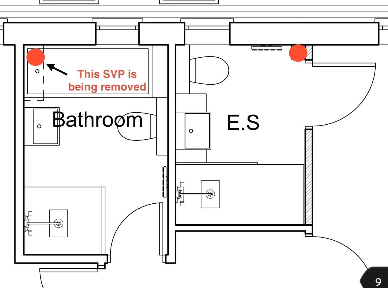

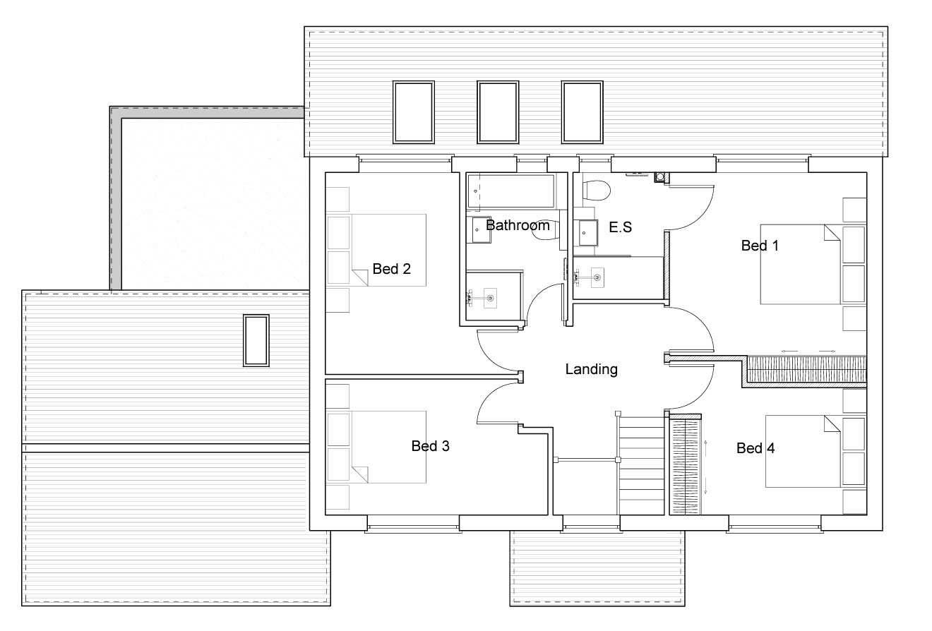

Hi all. First time poster. Currently renovating our 4 bed house, built in 1988. We’ve just finalised our architect plans for our extension and downstairs reconfiguration. As part of our plan, we need to get rid of one of our SVP’s, the one that currently serves the main bathroom. The plan is to then have both the main bathroom and en-suite, use the existing SVP in the en-suite. Although our architect says it will be fine, I have serious concerns that this just won’t be possible, due to the distances involved and due to everything coming from the same side. Please can I seek the advice of you wonderful professionals so I can decide a way forward.

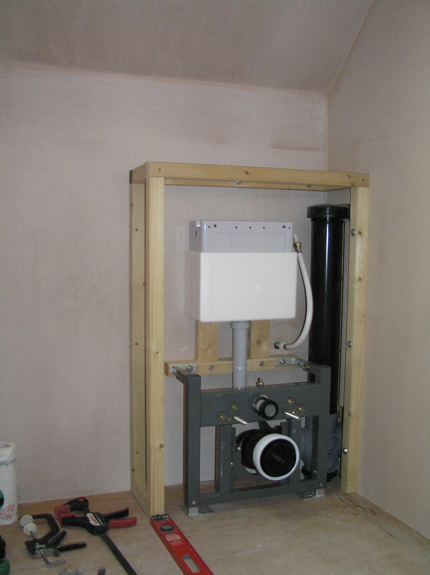

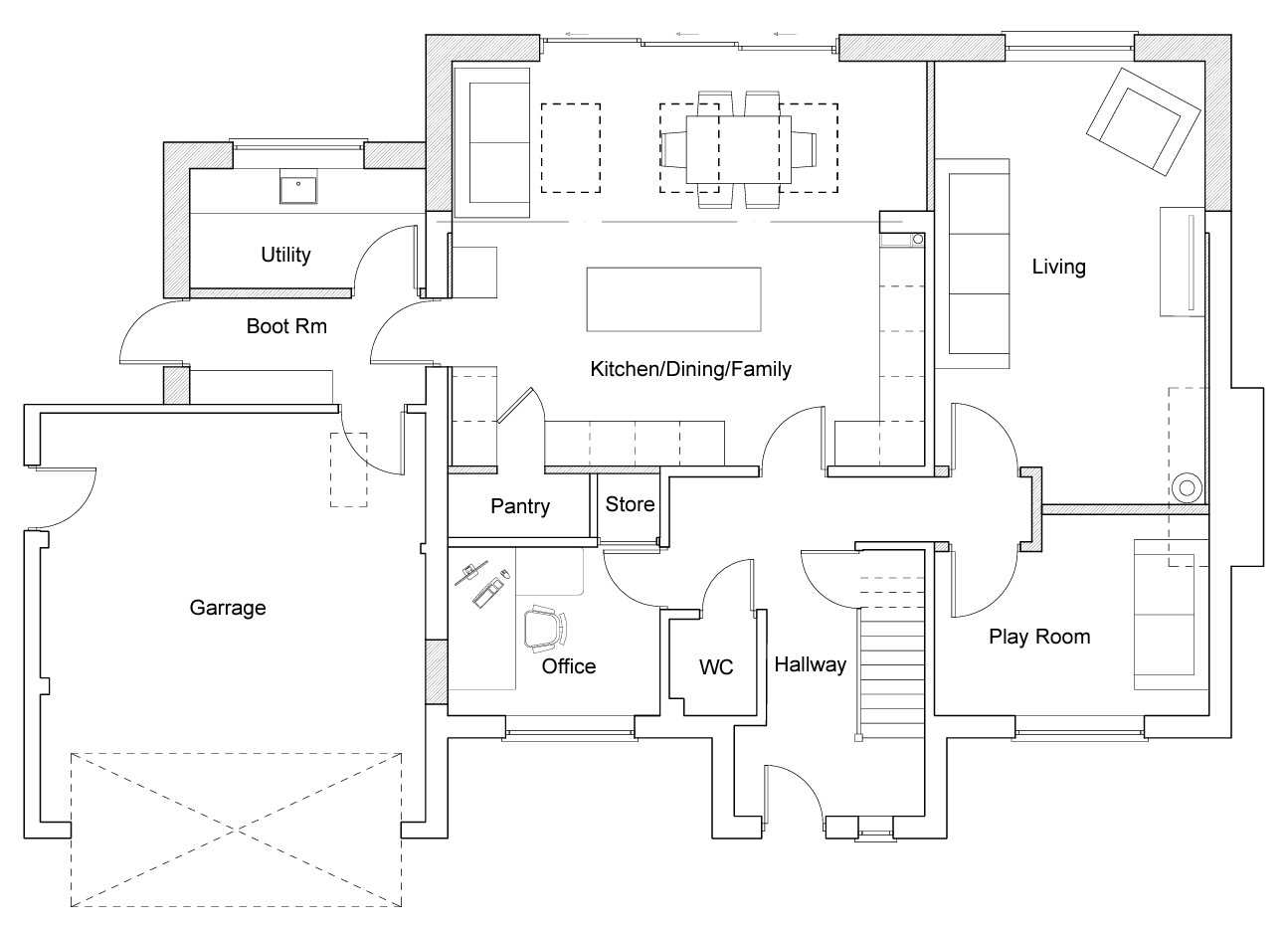

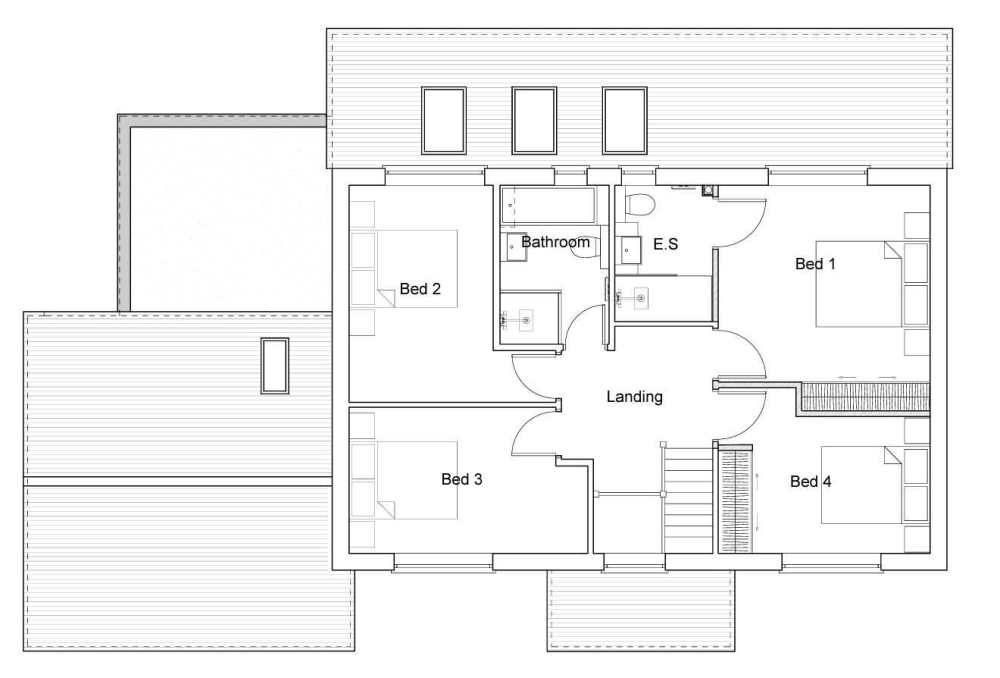

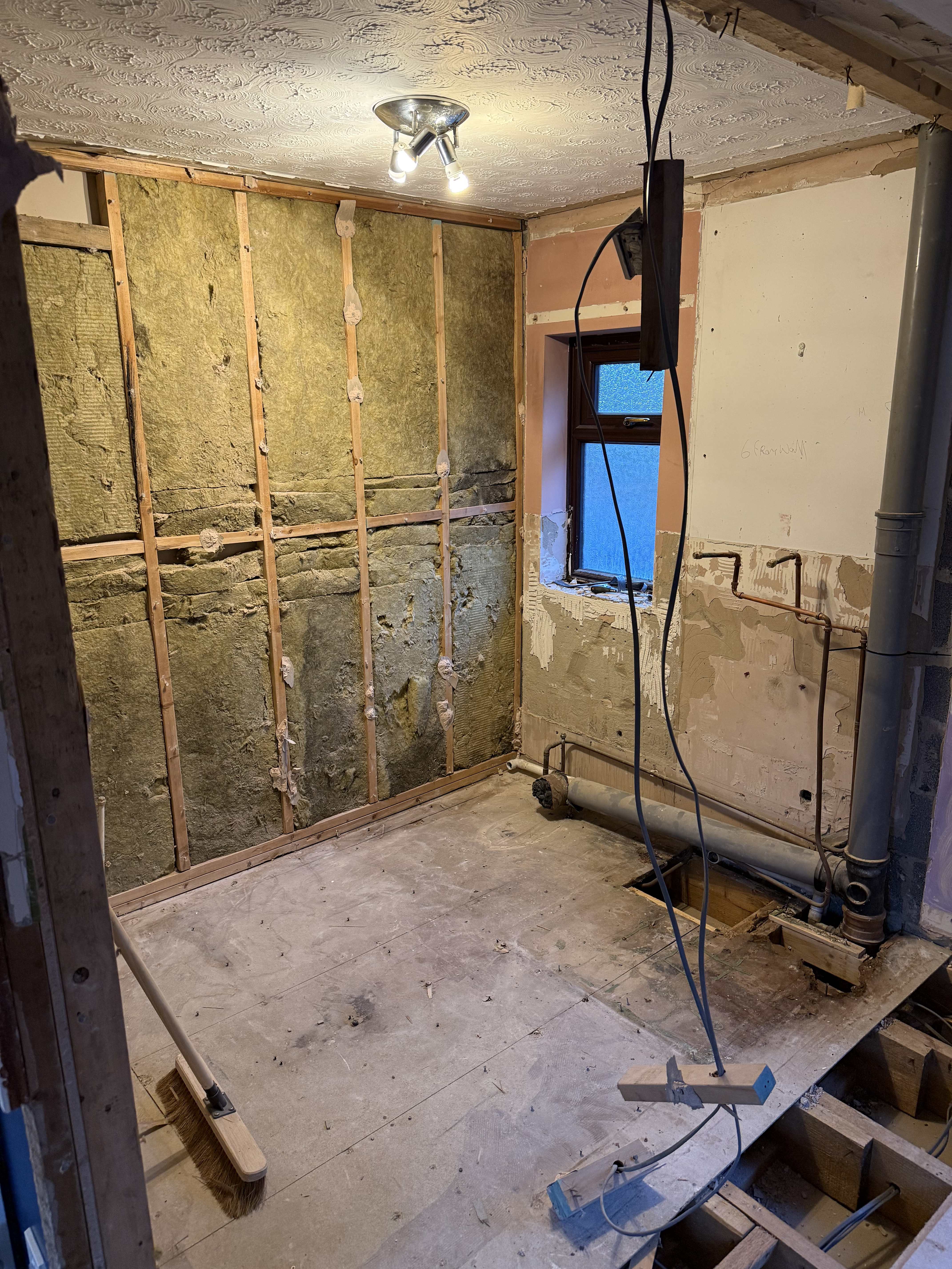

I’ve attached the architect plans for proposed ground floor and 1st floor. Screenshot of proposed bathroom layouts has existing SVP’s marked in red, including showing which one is going. I’ve also attached a photo of the en-suite now that it’s been ripped out so you can see the SVP that’s staying.

You’ll be fine.
Done plenty of bathrooms back to back like this on one stack and sometimes no SVP at all, just an AAV (air admittance valve) to ensure functionality.
Green light from me, and I’ve been joining pipes together for 35 years. ;)

Hi Nick, thanks for your reassurance. How exactly will it work? Will I extend the horizontal soil pipe through the wall into the other bathroom, and then have the second toilet connect into it? Are there issues when connecting 2 toilets to the same horizontal pipe?

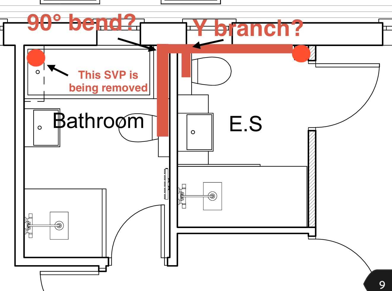

Hi Nick. Thanks again. I think I understand you. I have thrown a rough sketch together to ensure I understand. 90° turn in main bathroom to start the horizontal pipe. Horizontal pipe remains straight, through the wall, to the SVP, with the en-suite toilet connecting via a Y Branch connector? Is that right? Obviously maintaining a fall on the horizontal pipe.

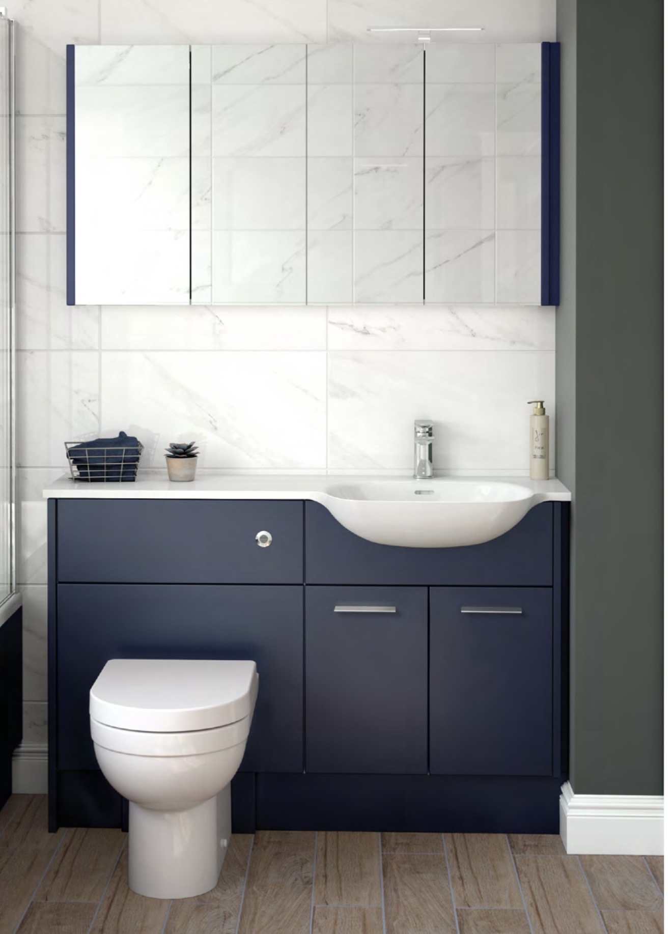

Regarding toilet type, attached is what we’re going with for the en-suite. Main bathroom is undecided, but likely to be a freestanding toilet.

You don’t have 2 WCs in one 110mm line so my previous about Y branch can go away. All good with 90° bends (bent pan connectors) and straight runs.
For the double corner branch, just order a cleaning / rodding eye (access cap) to push into the top outlet to close it off.

I’m saying you don’t have one run with a WC on the end and another further down the same pipe, you have 2 pipes, one in each room.
Therefore you can ignore my corner branch as I mistakenly thought you dropped in the corner that side.
Can you dril through the wall and connect the WC closest to the SVP into the horizontal run of the other WC?
