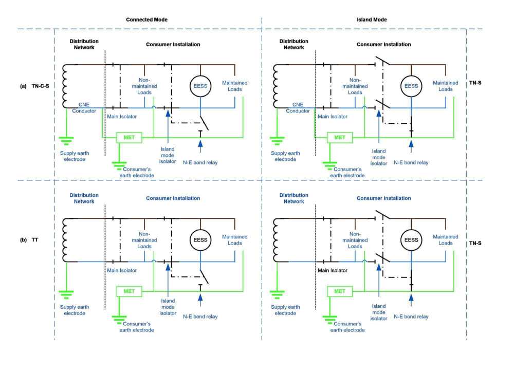

jimseng Posted November 15, 2025 Author Posted November 15, 2025 (edited) Quote Yes we used their earth bonding. I added the earth rod when we installed the batteries and backup gateway. I'm sorry to keep banging on about this but it is a complex subject without a definitive answer and easy to get wrong (and I bet many professionals get it wrong despite their qualifications). @kelvin. When you added your earth rod, did you leave the SSEN earthing permanently in place? It seems to me that inverters in islanding mode probably leave the existing earth in place, which potentially is fine until there is a local cabling fault. However an additional earth rod would surely introduce a ground loop if the DNO earth isn't disconnected in islanding mode. Maybe I am over thinking it but it seems this isn't a settled subject yet, and it should be simple to get right with the correct information. Edited November 15, 2025 by jimseng
JohnMo Posted November 15, 2025 Posted November 15, 2025 We had to add an earth rod in addition to the the SSEN one, for running in island mode. But if you make some basic assumptions 1. Mains is off and cable is broken or in your case not there. 2. You no longer have a safe proven earth path. So a fault in house has no earth route in island mode. So you need to add an earth spike for that condition. No earth spike no ground route except via you. Doesn't sound that safe to me. So install earth spike for island mode and be safe, would be my answer.
jimseng Posted November 15, 2025 Author Posted November 15, 2025 @JohnMoI get that. I think I am being really pedantic, and I am considering the long term. Again, probably over thinking it but there are a couple of scenarios. And I am talking about where I am on grid and there is a power cut: 1. Power cut downstream of local earth point. DNO earth still remains so local ground spike creates and earth loop. -Bad 2. Power cut due to cable fault. No DNO earth. Local ground spike is necessary, no earth loop. -Good It seems a simple thing to fit a double pole relay to create the local E/N bond and at the same time swap from the DNO earth to local earth rod. But I haven't seen a single mention of this being done anywhere, which, in my experience, doesn't mean it shouldn't be done, just that it is a detail that is ignored/ nobody cares/ hasn't been discussed.

jimseng Posted November 15, 2025 Author Posted November 15, 2025 Quote The earth rod is there for when the house goes off grid and you lose the DNO earth in case you have a fault in the house. This is the last piece of the puzzle for me and the bit I have been obsessing over, perhaps unnecessarily, but obsessing I am. I believe that when the house goes off grid the inverter disconnects the live and neutral but not the earth. That is certainly what the it shows in the Sunsynk and Growatt manual. Which means installing an earth rod gives two earthing points and therefore a permanent ground loop except when there is a specific DNO cable fault and you lose the DNO earth. And it isn't discussed anywhere as if it has been completely overlooked. Quote It's a more unusual requirement and a lot of real sparks won't have thought about it and the regs probably don't cover it well. Indeed! But I'm thinking about it. And I can deal with it by installing a relay with an extra NO contact to swap the earth from DNO to ground spike. That means whatever the fault is that caused the grid failure, there is a bonded earth in the islanded house but never a ground loop. But since I have never seen this mentioned then either I'm fussing about nothing, nobody has noticed, which they should have, or I have got it completely wrong. I'll move on from this subject once somebody convinces me that I am an idiot or that everyone else except me is an idiot. It won't be the first time. (I'm not saying which way round either)😀

Peaklander Posted December 3, 2025 Posted December 3, 2025 I'm late to the thread. I have a pair of Sunsynk 3.6kW inverters in parallel. They provide the 'signal' for island mode across a volt-free contact, if you have also ticked the box in the settings to enable the feature. You monitor this with the external contactor that has been mentioned, letting the contactor couple the N & E when island mode is signalled (during an incoming power loss). On some Sunsynk inverters I believe that the VFC closes on island-mode but on my smaller inverters it opens. Therefore I need to use a normally closed contactor pair, so that when the contactor drops out, the N-E connection is made. As for providing a local earth, you need to supplement the DNO's earth because during a power loss you can't assume that their's will remain. So assuming that you aren't already on a TT system with your local earth rod in place, you need to provide one. This can stay in circuit and does not need to be switched out in normal operation. This IET article refers but here's a diagram from it... https://electrical.theiet.org/media/1549/earthing.pdf
