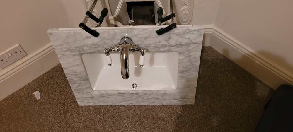

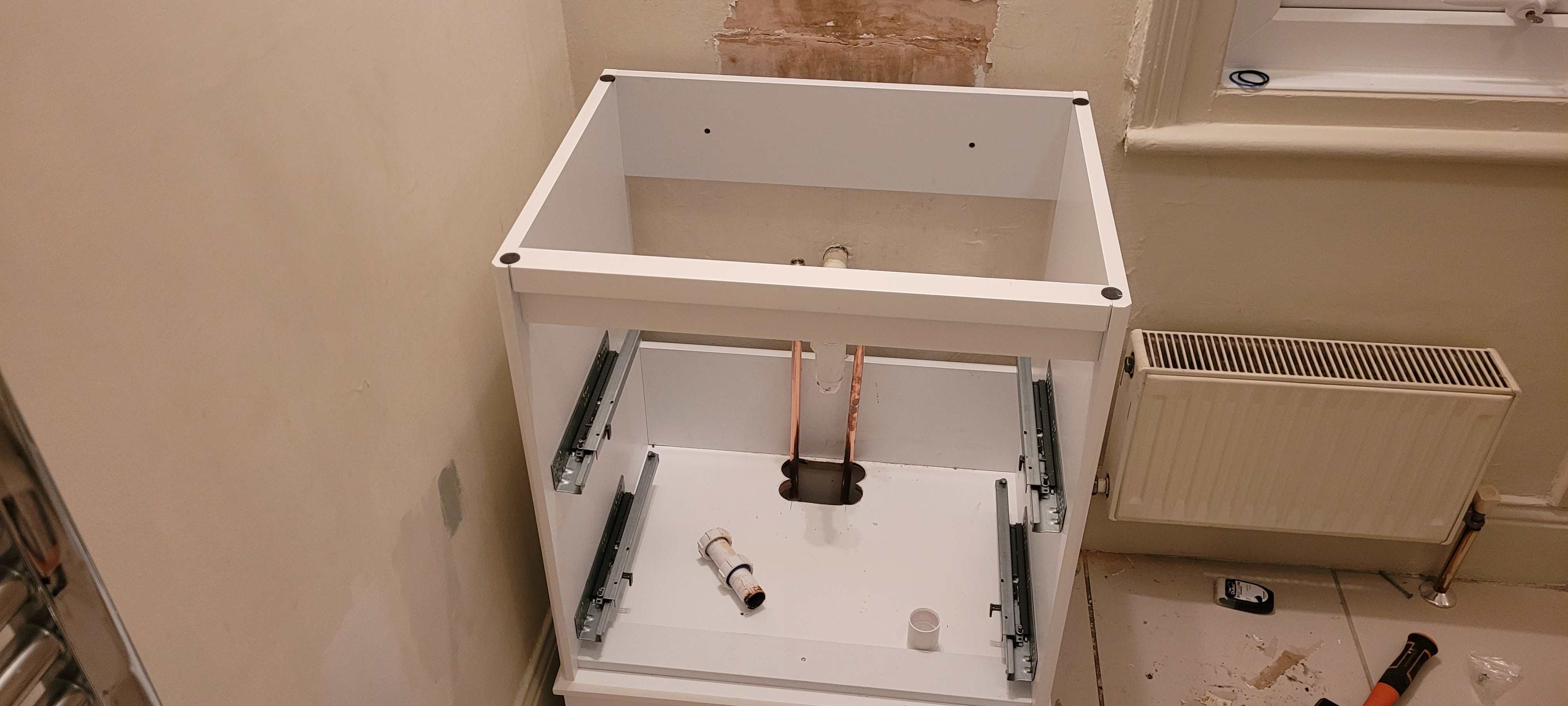

MikeSharp01 Posted November 9, 2025 Posted November 9, 2025 See pics. Our boy has given me the job of fitting their vanity unit. Getting there is a mission but I have hit the problem of fitting the basin to the cabinet. There are no fixing points on either without some form of fixing the sink slides about! How is the connection made in these circumstances I ask myself and so the team here. Silicone? Mirror pads? Velcro pads?
Big Jimbo Posted November 9, 2025 Posted November 9, 2025 4 small blobs of silicon. Dont go mad, just incase it ever has to come off.
BotusBuild Posted November 10, 2025 Posted November 10, 2025 How about Command strips. Our daughter used these at university to hold a largish mirror on her rented room. Stayed up all year, no problems
