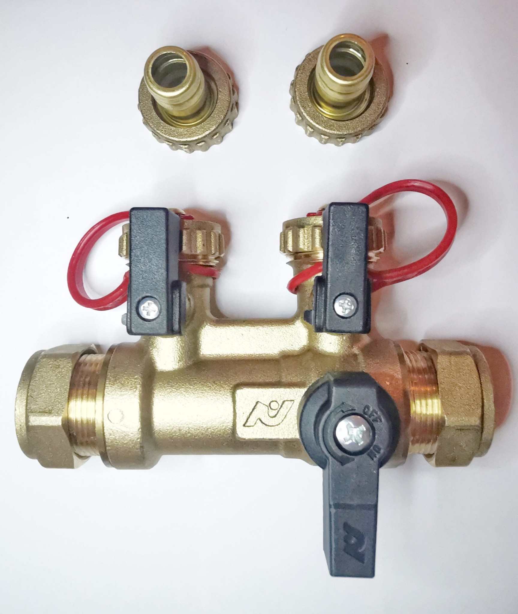

Potatoman Posted 2 hours ago Posted 2 hours ago Hi, how do you eliminate stubborn air in the heat pump system when you have a single zone system.
JohnMo Posted 1 hour ago Posted 1 hour ago Having air traps at all high points, then you have no stubborn air traps. UFH loops blast them with tap water one by one.
