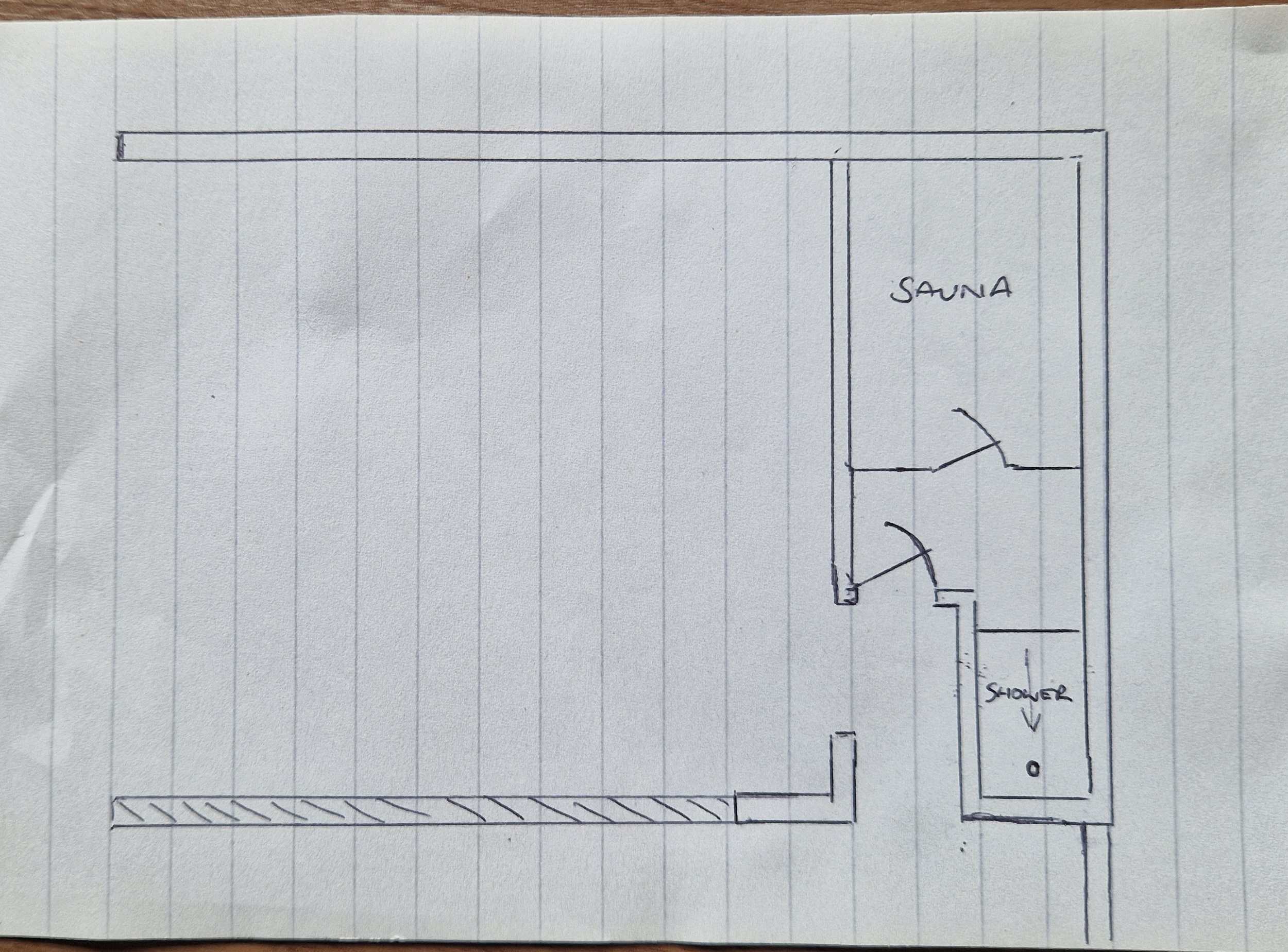

Mulberry View Posted October 28, 2025 Posted October 28, 2025 We have a Car Port in our design that's linked to the house via a covered walkway. The Car Port itself it open. We are really fond of having a Sauna within our scheme, but not enough room in the house and so I decided to increase the length of the Car Port in the hope of incorporating a Sauna within a partitioned structure at the rear of the Car Port. On further thought, I would really like to include a small shower and changing area but space is pretty tight as I don't really want to compromise on the 2m x 2m internal size for the Sauna. Does anyone here have a Sauna? Do you have anything to add in terms of sizing? This is my "fag packet" sketch (not at all to scale, yet!) The external walls of the Car Port are double skin with an uninsulated Cavity. The partition walls are likely to be 100mm facing bricks with a proper sealed door into the Changing Area. The Sauna itself is a separate discussion, but that will be built and insulated according to Sauna best practice. I'm interested in the Changing and Shower Area at the moment, which I want to make comfortable to use (not necessarily luxuriously warm, but usable in Winter) and so I am thinking of applying some insulation to the walls. What thickness of insulation (PIR?) should I consider for this? 50mm? The structure is somewhat shielded from the prevailing wind by the house itself and I can insulate the floor and ceiling.
SteamyTea Posted October 28, 2025 Posted October 28, 2025 Have made thousands of them. As long as you can lay down in it, it is big enough. Don't get an infra red heater, they are truly dreadful.

SteamyTea Posted October 28, 2025 Posted October 28, 2025 58 minutes ago, JohnMo said: plunge pool Would be my choice. 39 minutes ago, Mulberry View said: sweating everywhere Sit outside for a few minutes, towel off, then pop your Crocs on and walk into the house. You will need water there, or at least a hose pipe for cleaning, so make sure you fit a drain in the floor. Then you can just hose off in the sauna. If you sauna properly, your neighbours will be the sweaty ones watching your naked antics. 1

SteamyTea Posted October 28, 2025 Posted October 28, 2025 I would be worried about using PU/PIR. It is not really designed for prolonged high temperatures. Mineral wool is what we used. Commercial installation had a number of quite strict electrical and fire rules. There is a section about 'hot boxes' in the wiring regs. If building it inside an existing structure, you need to consider forced ventilation and humidity control. A bathroom fan does not last long at 100°C. (A lot of saunas are only run up to 80-85°C, but they are for fairies, did a few for jockeys, they slept all night in them if they were overweight) 1
Nestor Posted October 28, 2025 Posted October 28, 2025 (edited) 23 minutes ago, Mulberry View said: From my own knowledge, be careful if using normal PIR inside the Sauna, I understand it can emit Cyanide gas under high temperatures. There are some specialist versions on the market which I'll be looking at. I've done a fair bit of research on the Sauna itself, there's a lot to learn to be honest! And @SteamyTea Thanks for that, will have a read and could replace with rockwool. I read that some type of aluminised vapour control membrane needs to be fitted. I will look for a drawing. Edited October 28, 2025 by JamesP
SteamyTea Posted October 28, 2025 Posted October 28, 2025 1 hour ago, JamesP said: I read that some type of aluminised vapour control membrane needs to be fitted. We fitted it, but then the MD of the company used to be a photocopier salesman. Looked good, but like most multifoils, really is pointless. A sauna is full of slots, holes and badly made doors, so vapour moves about pretty quickly. 1
