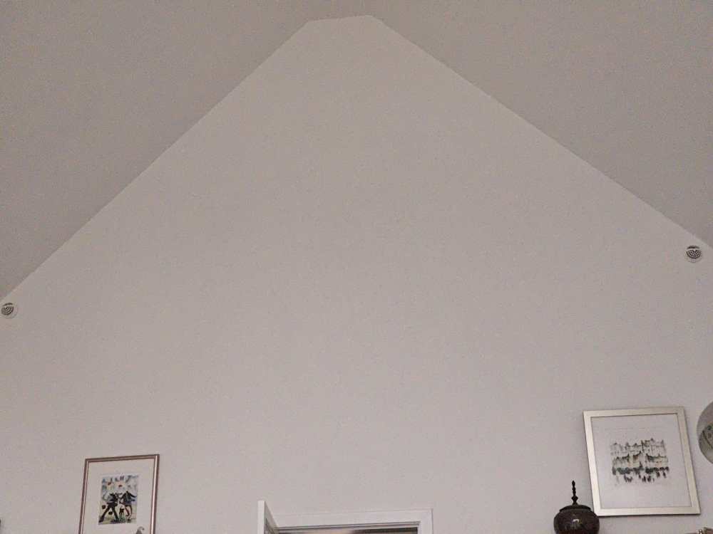

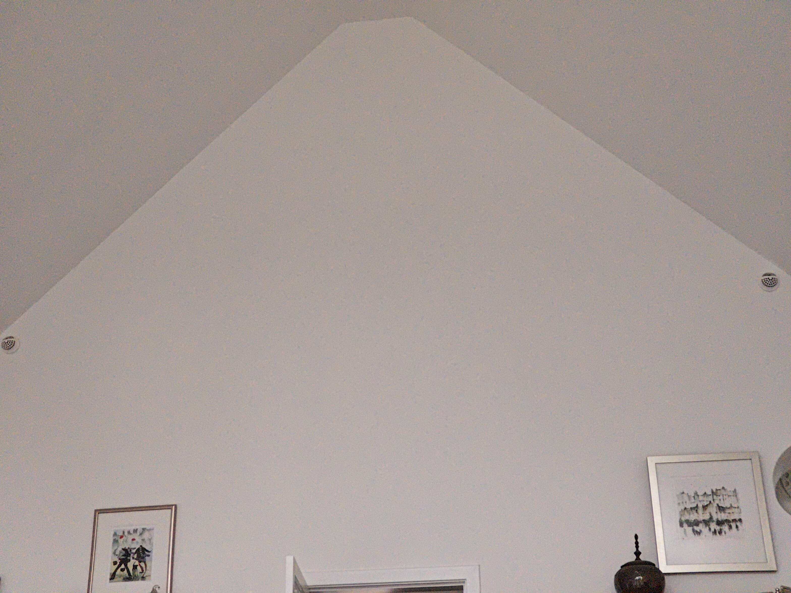

I have mine in the wall and use coander nozzles to throw the air across the room. Used in 3 bedrooms, lounge and long hallway. Lounge two dots at extreme edge of the image by ceiling.
Air comes out following ceiling and drops about 7m later. All heated to room temperature, so you don't feel any air movement.
In the bedrooms the supply valves are high on the walls. In the bathrooms, the extract valves are again high on the walls.
In the main kitchen/dining/living, they are on the vaulted ceiling. So 2 supply at the living end on one face of the ceiling. 2 extract at the kitchen end, one on each face.
