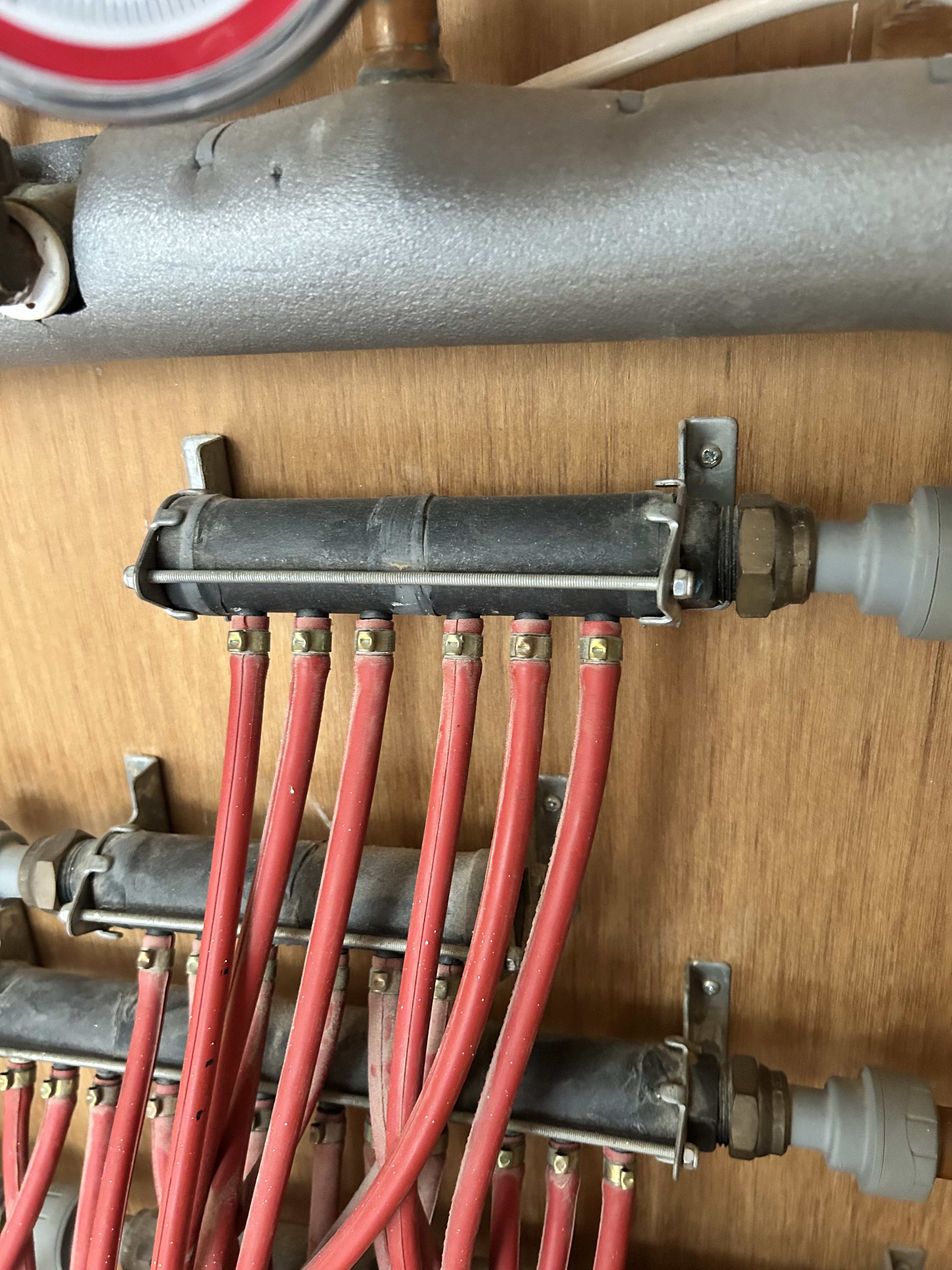

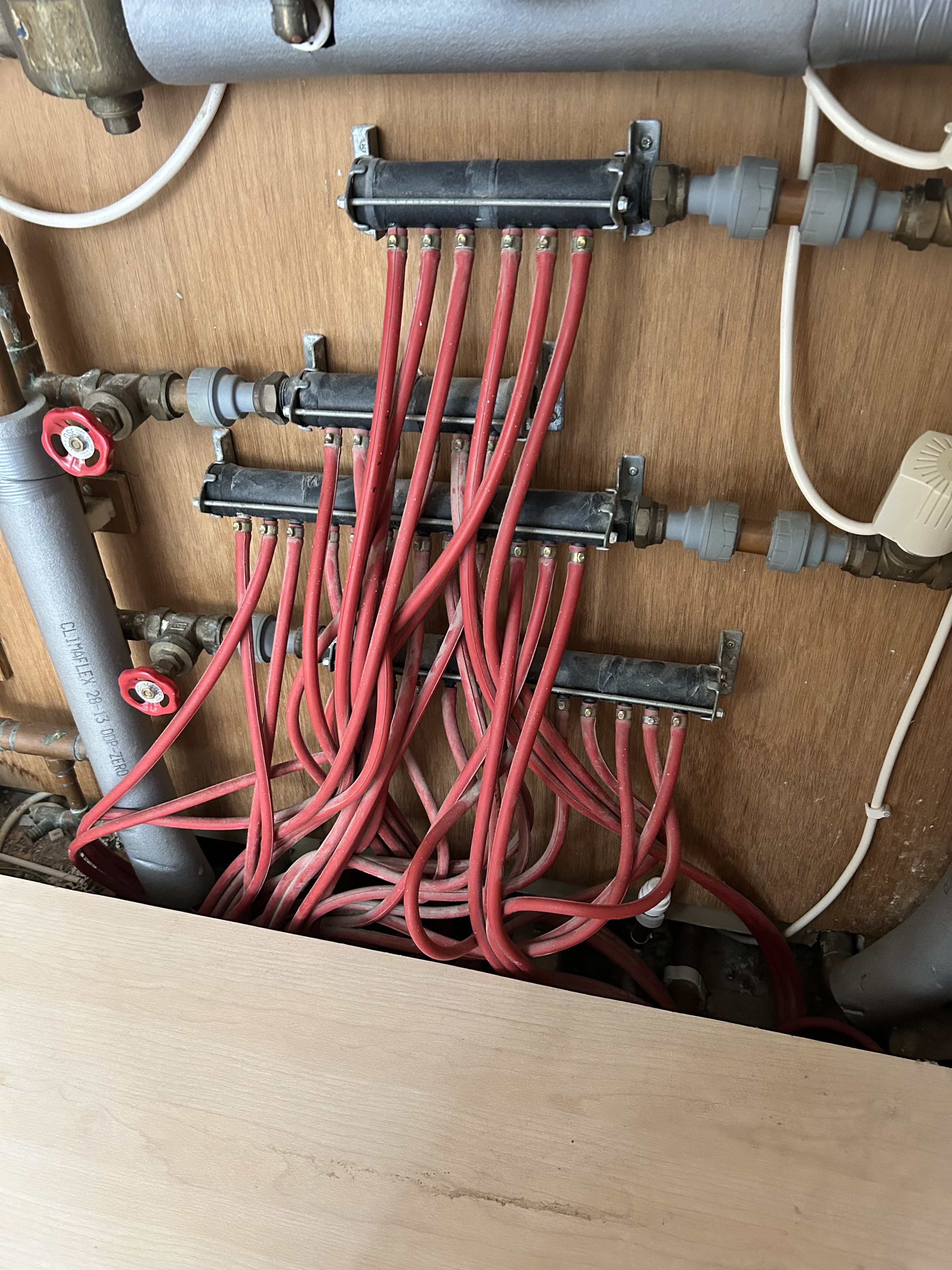

Md666 Posted October 23, 2025 Posted October 23, 2025 Hi The property we are renovating has underfloor heating ,but has no information or make on it ! Is there any chance anyone here recognises this particular system? Any help would be very much appreciated Many thanks Mark
Bonner Posted October 23, 2025 Posted October 23, 2025 No but it looks at least 30 years old so unlikely to be any back up. Does it work? Obviously the critical part is the piping, is it rubber tube?
JohnMo Posted October 23, 2025 Posted October 23, 2025 Did an image search - nothing found. Looks like a simple manifold without individual loop control. If it's working do not touch it. If it's broken chuck it, in favour of better control of a modern manifold. Would suspect the tube is the week point of the system.
Gone West Posted October 23, 2025 Posted October 23, 2025 The grey fittings look like a Hep2O MK1 reducer that was first introduced in 1991. I used the MK1 Hep2O system in 1994, it was updated in 1998.
