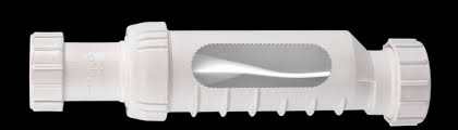

Nick Laslett Posted October 13, 2025 Posted October 13, 2025 (edited) Here is the page from the installation manual for the floor standing unit. Source: https://shop.dhps.nl/Article/DownloadAsset/Installatiehandleiding Panasonic ventilatorconvectoren P-FAL serie (Engels).pdf?documentId=assets/1043/d4cdab92f98c4a15b453b97b9addb49e Basically you route the condensate pipe to a soil vent stack. Use a waterless waste trap between the condensate pipe and the SVP connection. Like this: https://wavin.com/gb/p/c5d3a02d-0d50-4ebb-a3a7-ff44fe446e57/osma-hepvo-waste-valve-32mm-white The condensate pipe will need an adapter to convert it to 32mm for the waterless waste trap. I did find a smaller 21mm trap here. The condensate pipe diameter is 14mm. https://www.greenmillac.com/Waterless-Trap-3-4-inch In an ideal world you will be able to access the waterless trap, as eventually it will need replacing. Edited October 13, 2025 by Nick Laslett

Dave Jones Posted October 14, 2025 Posted October 14, 2025 yes i have both the new and old model. the drain can be brought out either side on the new model (its wifi controlled). Had our plumber put a waterless trap for it to drop into to be on safe side. amazing bit of kit, couldn't live without one in the summer now. 1
