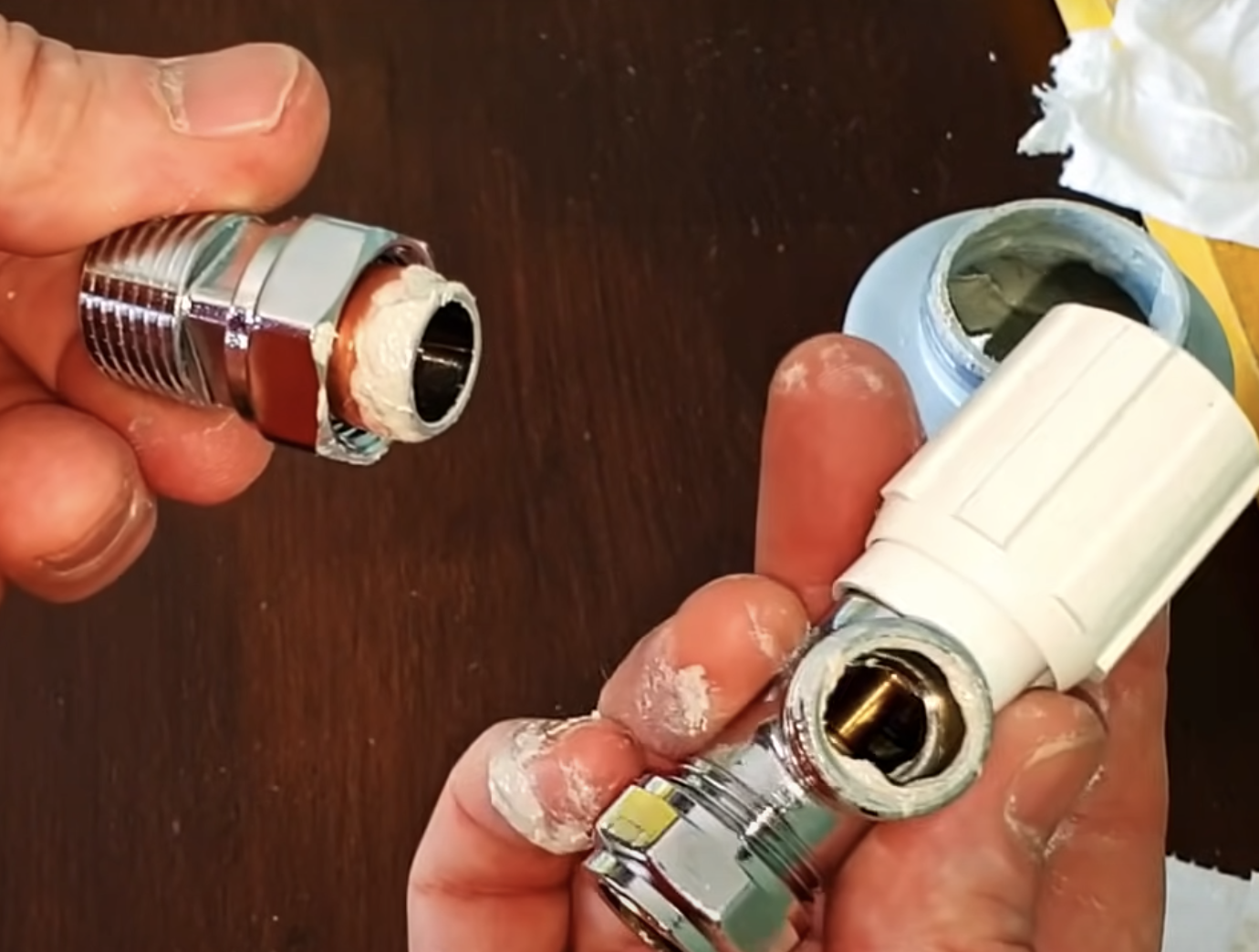

11 hours ago, Nickfromwales said:
When the pressure is zero on the boiler gauge, the system and radiators will still be nearly 100% full, if they are not on the next floor up above the boiler.
You need to drain down the radiator you’re working on. Get one of these LINK and a radiator key LINK to open the vent at the top of the radiator. Until you open that, the water will stay in the radiator on vacuum.
Drain out until there’s no more water to come out.
Then fit the new valve. You need to get some PTFE tape LINK to go around the olive on the pipe (where you fear you’ve ’broken’ the pipe). You know when you’ve done this as the leak goes from bad to very bad. ;)
Applying this tape (10 turns) is to cover you from the olive having been crushed a little too much by over tightening with a spanner.
Smear some jointing compound over the threads, over the olive (after tape) and this will mean you get a good seal without having to go Hulk on the spanner again. For the next tightening up, go easy, and try it first. Then go tighter just a 1/4 turn at a time if a small leak begins to show.
The you close the vent at the top of the radiator.
Then you go to the boiler and test fill the system back up to 1.5 bar on the gauge to check for leaks. If all good after 30 minutes, then bleed the radiator vent to get the air out.
Then top the pressure back up (letting air out will make the pressure drop again on the boiler gauge) and run the radiators up to max temp for 30 mins and keep checking.
If all good, select a nice shirt and get to the pub to celebrate. 🍾

I've done the same before but I think there are a couple of points to think about
1. The condition of the olive
2. Possible need to PTFE tape or remove and replace the olive
3. Miss match on old nut to new fitting
4. First time..................
I'd drain down

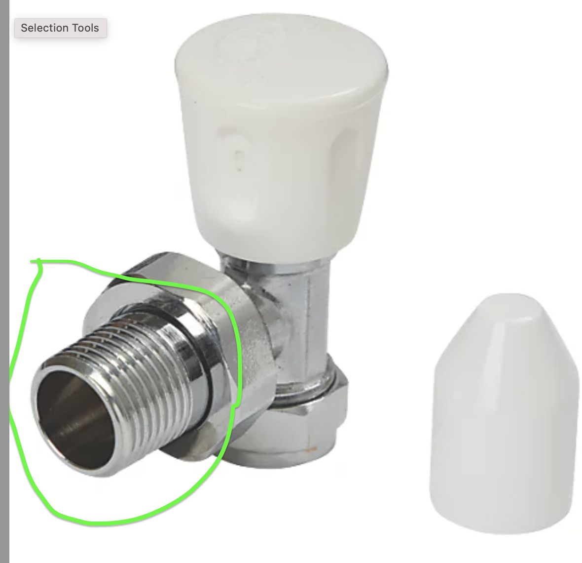

thank you, just one question, i plan to buy this one, but if you look at my radiator, seems the part in his left hand will not be used? the one i plan to buy is this one, https://www.screwfix.com/p/flomasta-15mm-x-21mm-white-chrome-angled-modern-manual-radiator-valve-head-body/901fw seems the same, should i remove the part in circle? from my radiator, seems that part is not needed. also the nut, is it the right position? sorry this is my first time to deal with boiler, just want to make sure buy the right one.
image.thumb.png.c2b9cf222341f240fbeccc59e53b17f2.pngimage.thumb.png.a6501e667186cd0e6b3b61b52ac489e8.png
had a look of the video again, i think the green circled part is the part connecting with the radiator, I probably do not need to replace this part, so just use the part in his right-hand in the figure.
Yup. 👍.
Put some jointing compound on the faces that meet together of the two parts, and a little on the threads.
Joints should tighten smoothly, and not squeak like brass on brass does when dry.
I’d drain down and take your time to do the repair. Prob only adds 2-3 hrs more messing around but a more relaxed job then ;)

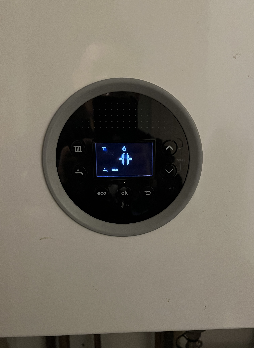

Hi Nick, I have followed the suggestion replaced the part, it works well and no leaking so far! I got hot water but heating seems not working properly, i can feel a bit warm on the radiator close to the boiler but the temp is not as high as expected, seems the boiler is not burning the heating or working at a very low power, there is a sign shown on the screen, can you please tell what does it mean and how to fix it? image.png.1f26d049c6b48fb11bf32d4db22c94a8.png

Just read the manual again, seems this is a standard procedure, it says "When the symbol appears alternately with the flow temperature, the siphon filling program is active. The condensate siphon in the appliance is filled"
Yup.
It’s doing an automatic “purge” of the air.
One of WB more annoying features as when we were all tired and fed up after fitting the bastard things we had to wait for “it” to “decide” when we could go home lol.
Sit and wait. Won’t be long !
