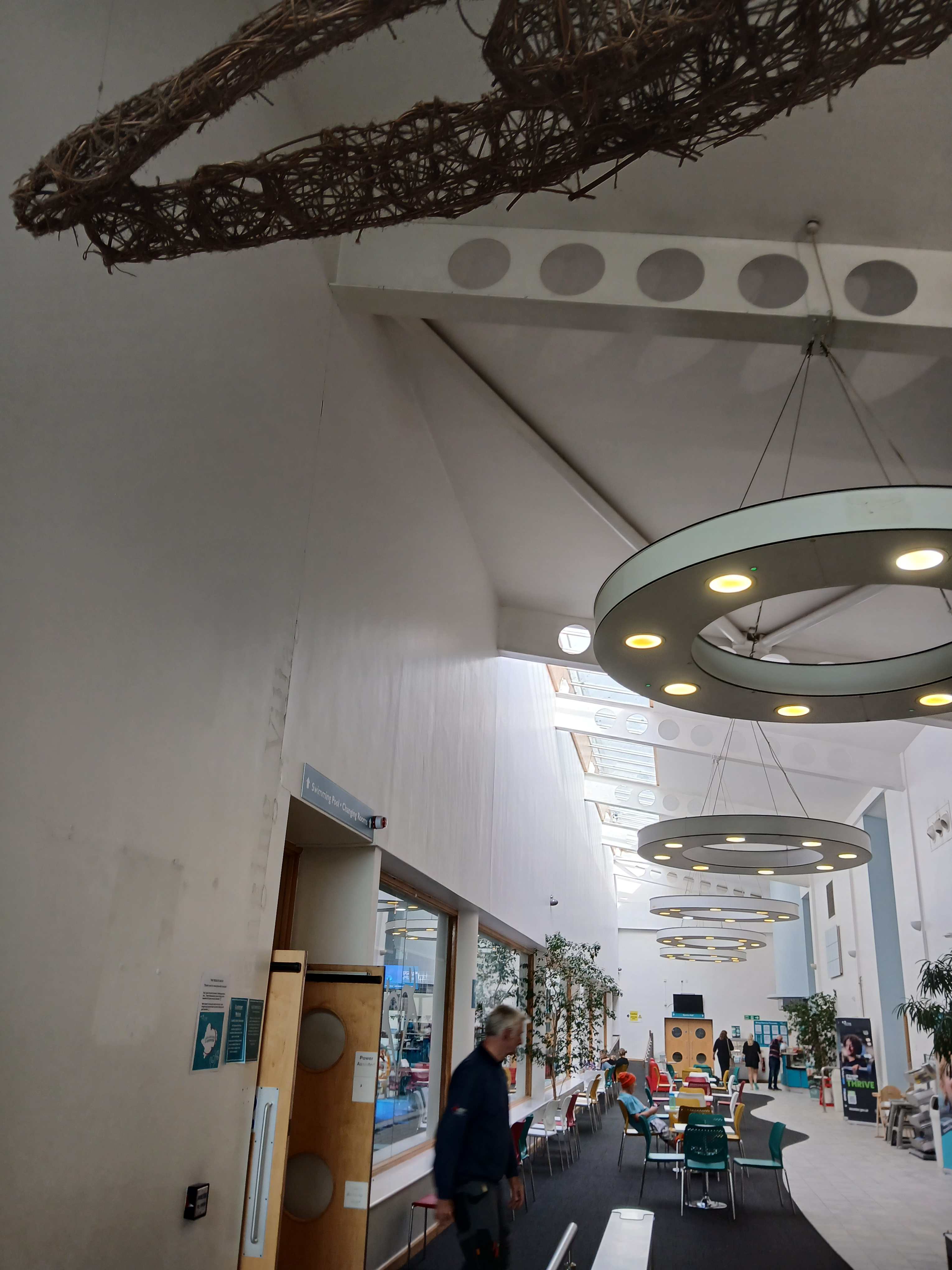

scottishjohn Posted October 7 Posted October 7 19 hours ago, Nickfromwales said: Pole sanding will be your friend. Apply about 5 generous coats of Leyland high opacity Matt white paint and leave to dry for a week. Then when you sand, the paint acts as a surface filler. You’ll almost instantly see plaster pop through here and there, where the highest of high points are, and you just then avoid those thereafter. The more you repeat this process, the better it’ll get. Don’t sand in one place, you need to do long random strokes. Good news is you only really see this where the sun is an enemy and not a friend. we used to use spray can matt black when going filler jobs on cars trying to get large panels flat just half a mist then a gentle flat with a long bed sander --longer than a pole sander if you can if its flat you want you ,ll soon see everywhere that needs filling no body does much in repairing panels now --same problem no skilled staffand insurance don,t want to pay no door skins fitted now --new doors --same reason I suppose my claim to fame in painting was the customer who complained that back to bare metal the paint job on his rotten old silver shadow was too shiny RR panels are never straight thats why they use lots of lead filler and need 20+coats of cellulose from factory he took it to derby to get some mechanicals done and they chipped the door where the two tone join was they rang me up and I gave them the colour codes and offerd them the paint I had left over from the job "we don,t want that we want you to quote us to repair it " needless to say I hit them hard for what was a half days job, "when you see a stick --cut it" as they say round here I never made money on full job ,as I underestimated the work -- It was 1980 - £5000 for main job RR quote_ hit with £500 for the minor repair 1
Nickfromwales Posted Wednesday at 16:27 Posted Wednesday at 16:27 2 minutes ago, Oz07 said: Been gym tonight not as bad there That looks to have been taped and jointed vs skimmed?
Oz07 Posted Wednesday at 16:30 Posted Wednesday at 16:30 Dunno wasn't there when it was built. Probably skimmed but with tapered edge boards else the flats of boards wouldn't look so wobbly?
