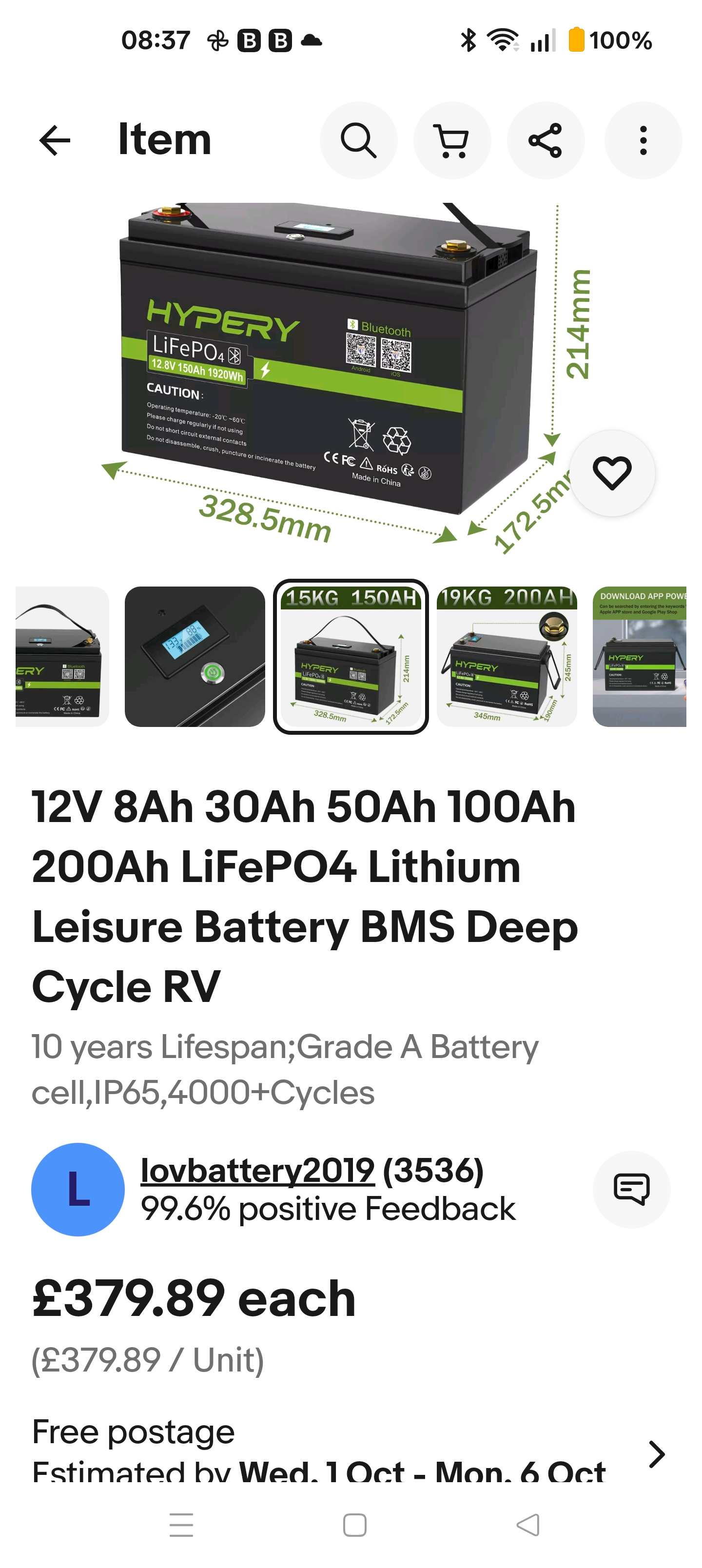

Now I have seen a cheap battery and charger combo that would fit my initial needs.
I usually buy the cheapest, until I can justify the best for my needs, and I have never been a believer that paying a higher price automatically buys quality.
So has anyone had any experience in buying something similar, baring in mind that this is just an experiment for fun.
The battery will be stored outside of the house for safety.
The safety factor is my biggest concern, not worth burning my house down for a couple of hundred quid.

umm, that's probably more like 3.5Ah. I've just bought a motorcycle battery about the same size and weight..
That is something that did not occur to me, mislabelling.
So maybe Plan B.
So battery and separate charger/BMS.

You would pay nearly that for a bog standard car battery. Similar offering from other companies many times more expensive.
The battery is tiny compared to similar offering on eBay (150Ah version)
