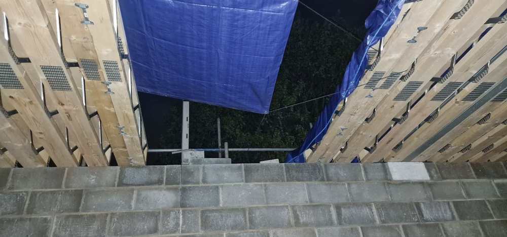

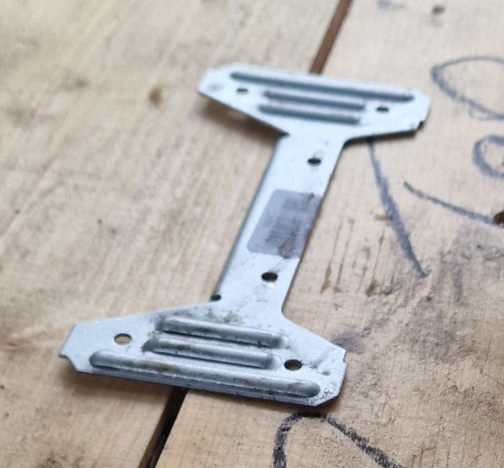

WoodpeckerDentMan Posted September 28, 2025 Posted September 28, 2025 Currently on with installing EasiJoists on the first floor. The plan says the 2 PLy joists need joining together on site. I'd prefer to glue and screw them together, but they have supplied these wacky little brackets. Anyone used these before on EasiJoist? I've got 2 x 2Ply joists that are supposed to be joined together and they've supplied these brackets. Not entirely happy using them as it will mean the top face is no longer level. Any alternatives anyone? I'm of a mind to glue them and strap them together until dry. Unfortunately, it's Sunday and LincFrame aren't working today!

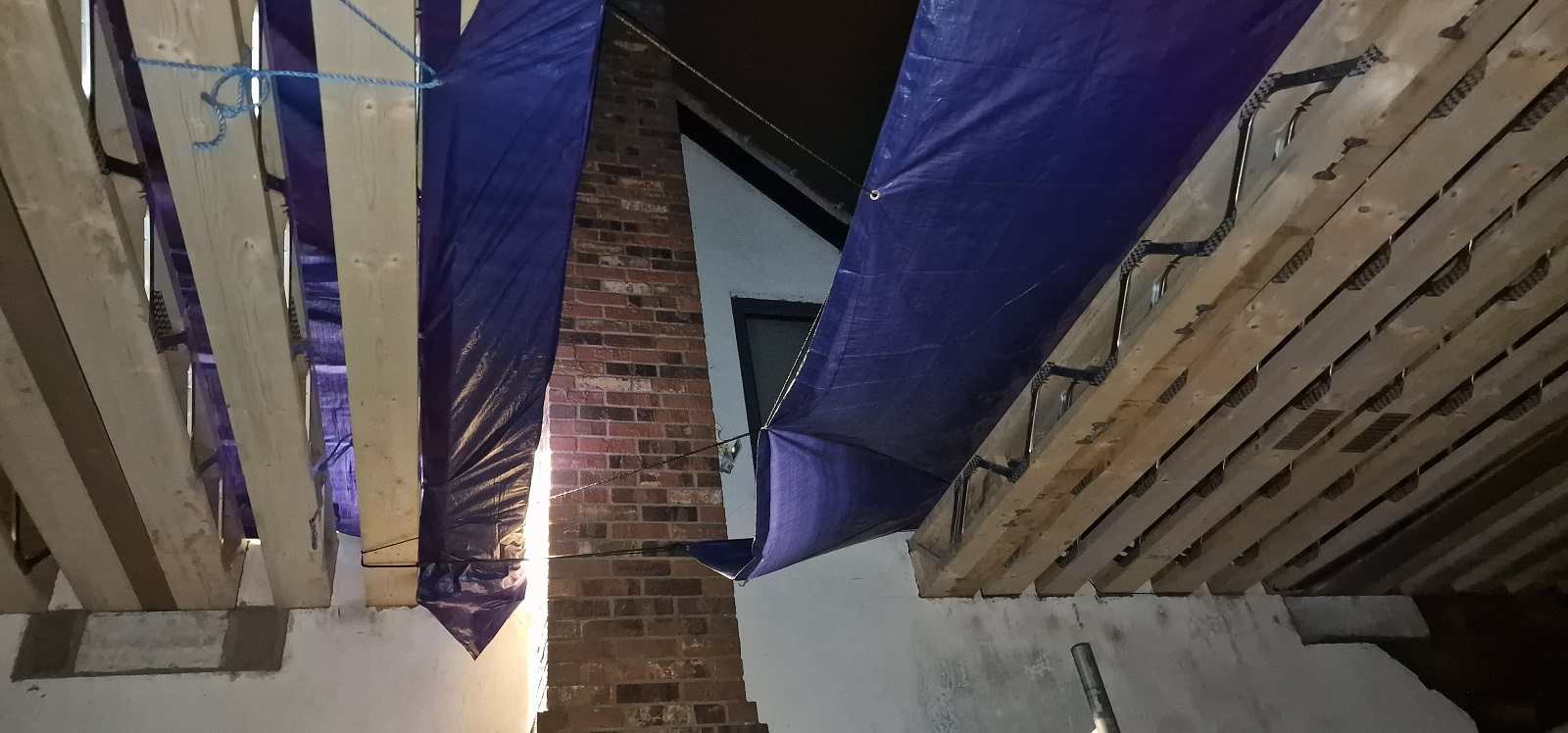

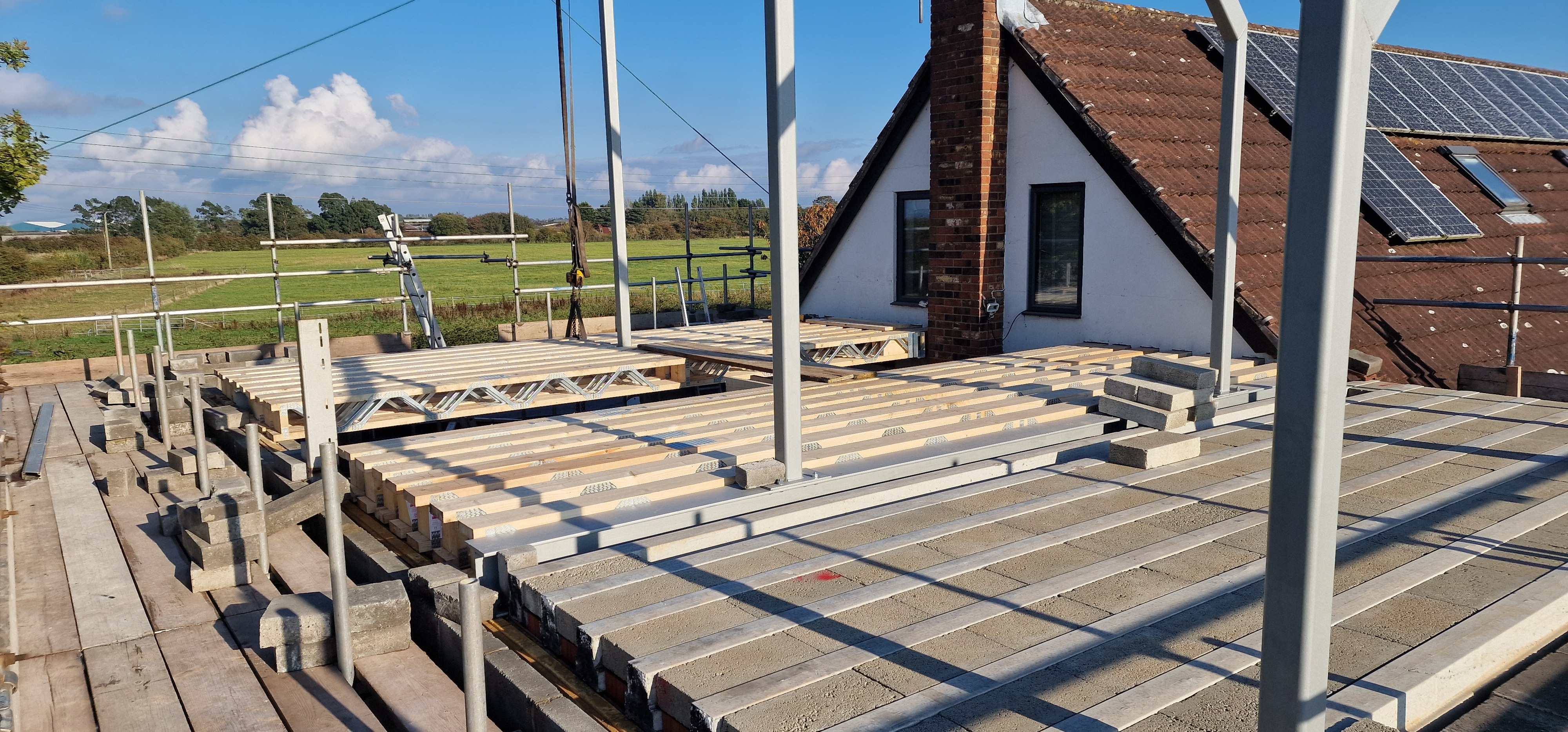

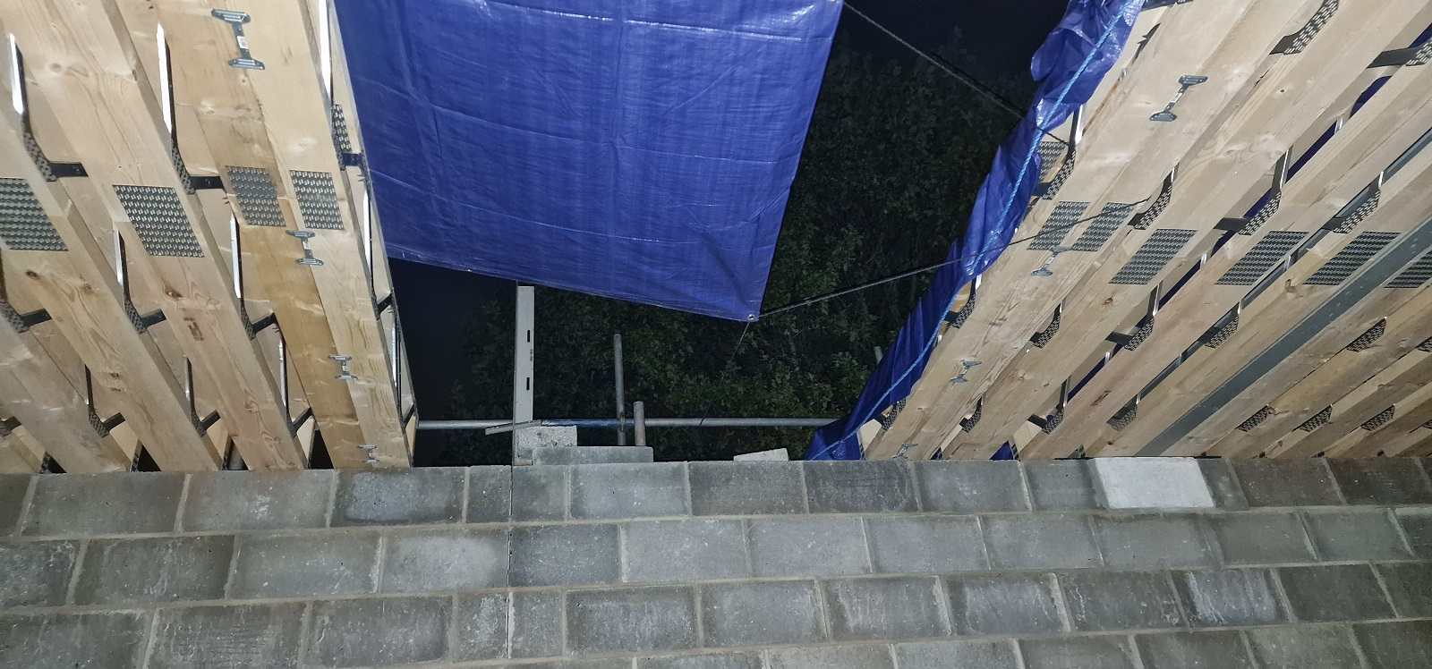

WoodpeckerDentMan Posted September 29, 2025 Author Posted September 29, 2025 LincFrame got back to me this morning, and that IS how they're supposed to be joined together. Definitely not easy getting them brackets screwed up tight to the corners then inserting the second beam between the two sets of brackets, but using a thin wide bladed scraper to ease the edge of the timber into the brackets a little at a time got us where we needed to be. Having use of the steel ridge beam to hang a block and tackle off to lift them up made installation a lot easier. 1

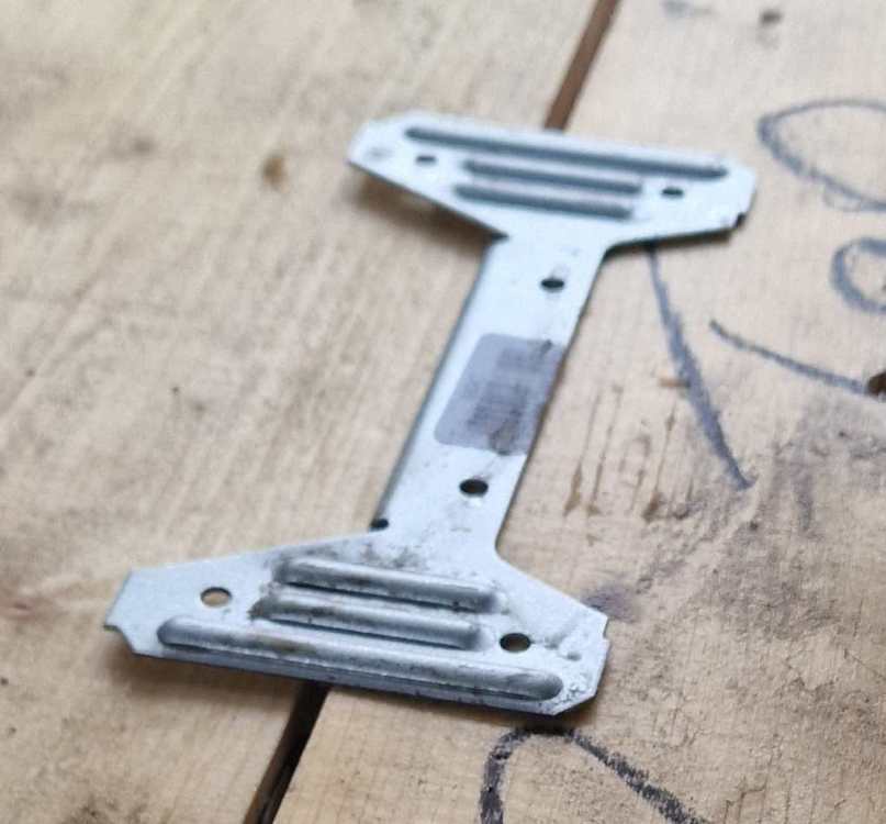

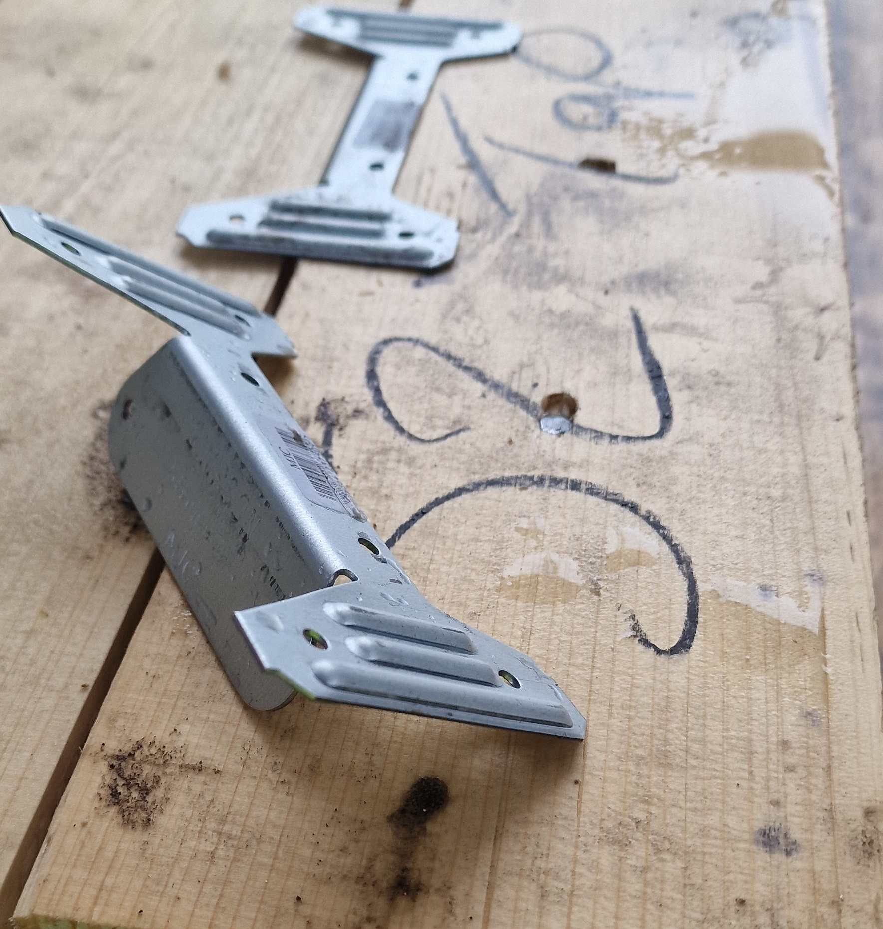

WoodpeckerDentMan Posted September 29, 2025 Author Posted September 29, 2025 Thought I'd attached photos of the little brackets to the original post, but can't see them now.😕 Here they are in case anyone in future comes across them...

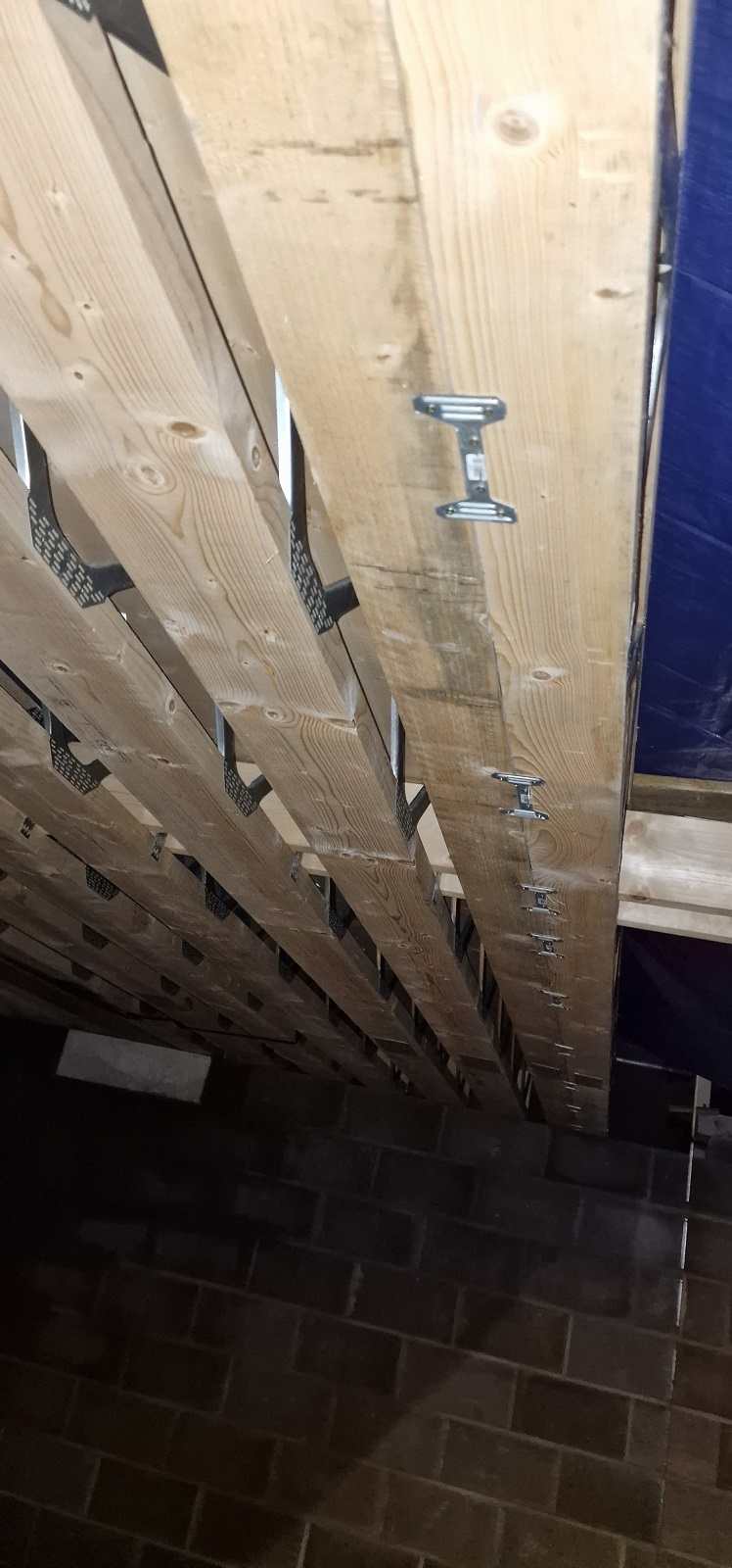

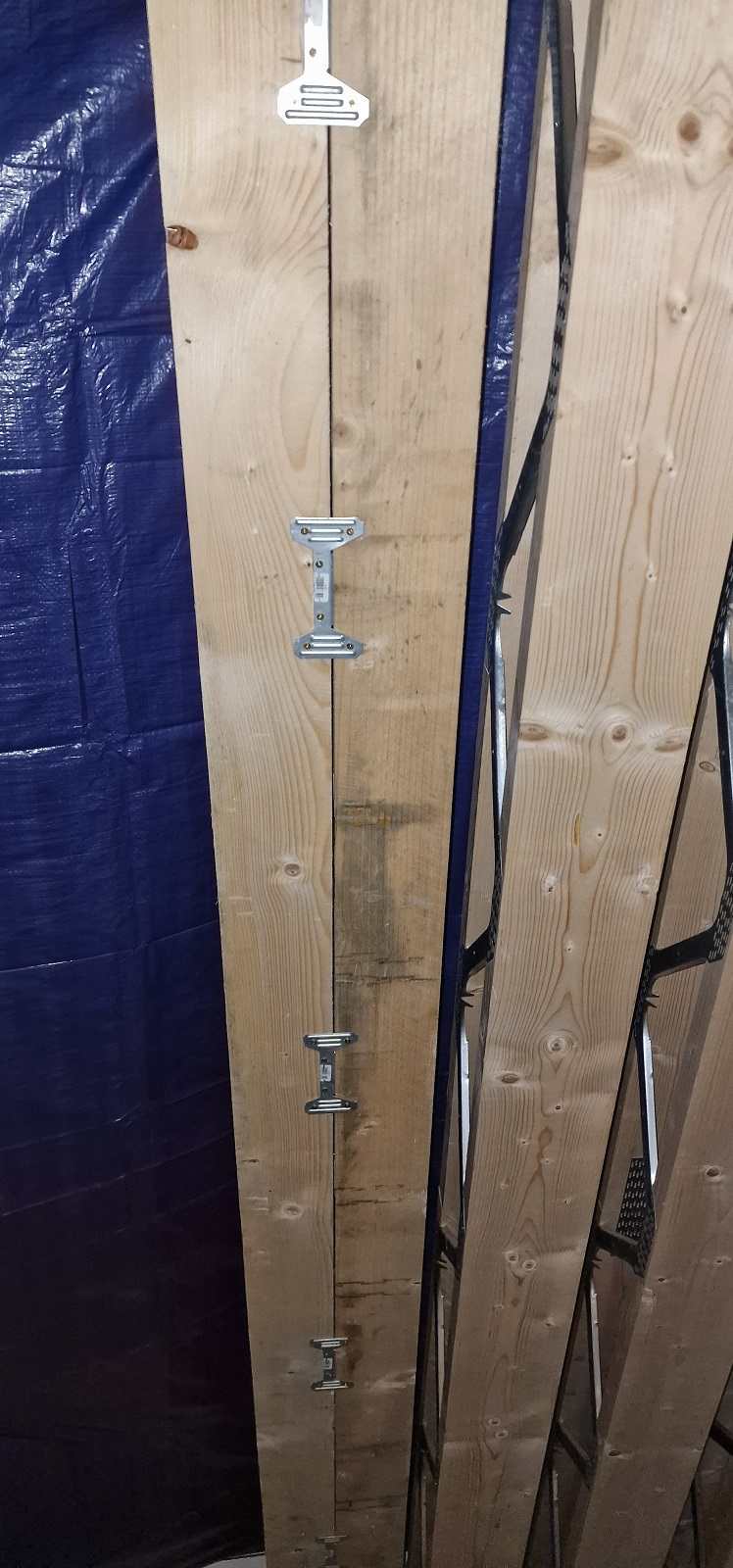

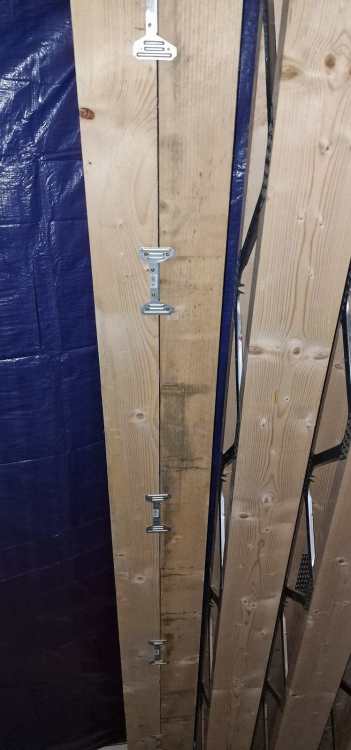

ProDave Posted September 29, 2025 Posted September 29, 2025 Can you show a picture of a pair of joists fixed together with these brackets? I am struggling to understand exactly what they do?
WoodpeckerDentMan Posted September 29, 2025 Author Posted September 29, 2025 Yeah, sure. Basically, the face of the bracket facing the camera on that bottom pic with 2 screw holes goes into the side of the joist, then the two holes on the top get 2 more screws into the same joist. That leaves 4 holes (2 either side of where the bar-code sticker is) to go into the second joist, but as 2 of the screws go into the first joist on the side, you have to put those in, and all the brackets on both top and bottom edges, BEFORE you put the two joists together. They're only small skinny brackets, with 3.5x30 screws in them, but there's about 36 of them on each pair of joists! The 2-Ply joists are specified for either side of the chimney and stairs that will come through from the existing house. A big chunky trimmer will next be hung between the two 2-Ply joists and then 5 more shorter joists hung off the trimmer. It's a lot of wood for a floor, but it's a huge span, so it is what it is.
