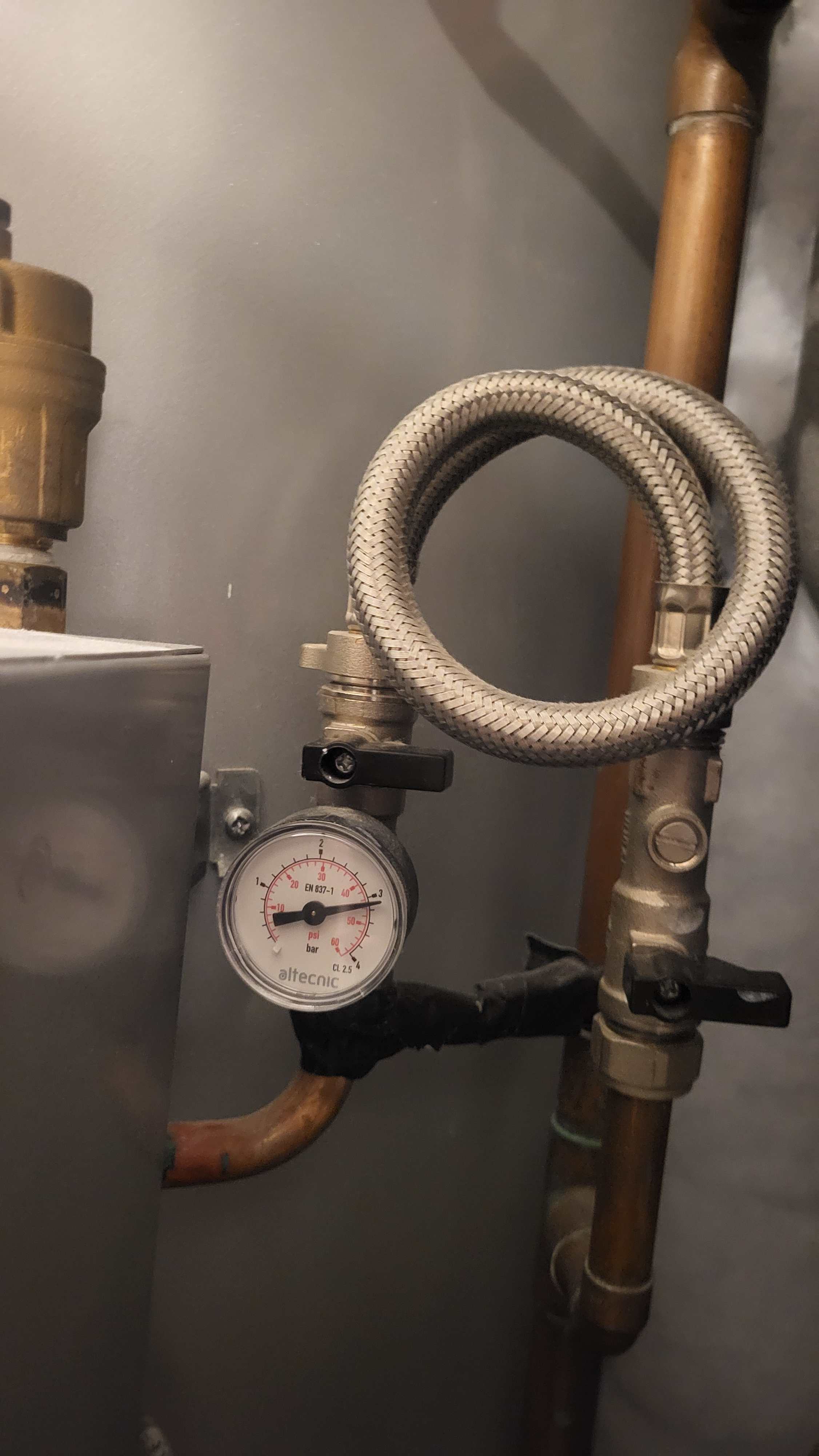

Andehh Posted September 27, 2025 Posted September 27, 2025 Trying to figure out why our heating loop is losing pressure, being dumped down tundish. One thing I noticed, is that the the systems shuts down/heat demand stops, the pressure jumps up per picture below. Could this pressure jump, cause a pressure valve to trip, dumping down the tundish?
JohnMo Posted September 27, 2025 Posted September 27, 2025 What pressure is it jumping from? What pressure is your expansion vessel set at? Has it been checked?
Andehh Posted September 27, 2025 Author Posted September 27, 2025 Jumping from about 0.75 bar (I usually keep it at 1.5bar) , A plumber came out and had a quick look, felt expansion vessels were OK, but that my pressure loss might be due to a pressure vessel being too small for the size of UFH loop (250sqm at 150 spacing, vessel is 18l)... But for me to check. I was also keeping the system at 1.5 bar, but he said drop it to 0.75 bar and see if that makes any difference. Nothing else jumped out at him got why I'm loosing pressure, but I didn't tell him about this pressure 'boost' which I just noticed.
sharpener Posted September 27, 2025 Posted September 27, 2025 I would suspect the EV pressurisation level, my installers left it at the factory setting of 3 bar, far too high. If it is too high or too low it will not be serving any useful purpose - and so appear to be too small. You cannot check it while the system is working, you need first to release the pressure in the primary circuit completely when it is all cold. Then adjust the pressure at the Schrader valve to be just below your chosen system pressure, say 1.2 bar, before re-pressurising the circuit to 1.5 bar or whatever. This ensures the bladder will be slightly compressed by default but capable of accomodating 80% of its nameplate volume in expansion and/or pressure surges.

sharpener Posted September 30, 2025 Posted September 30, 2025 3 hours ago, Dillsue said: No problem fitting a bigger expansion vessel, but if this EV is in an existing and previously working system, why do you and your plumber think its suddenly become to small?? Yes. And if he does not know how to check/adjust the pressure in the current one (see upthread) he won't know how to commission the new one so £150 down the drain and no improvement. Going back to the original post I think there is perhaps a pressure spike when the system shuts down, that's quite likely depending on where the p.v. is in relation to the pump, but correctly set up it should absorb it without difficulty.

John Carroll Posted October 9, 2025 Posted October 9, 2025 (edited) I would remove one end of the filling loop to ensure neither isol valves passing. 150L system contents assuming cold water temp of 10C and hot of 50C + a 18L EV with precharge/filling pressures of 1.0/1.5 will have a hot final pressure of 1.85bar, even if the pre pressure was reduced to 0bar then a filling pressure of 1.5bar will still only result in a final hot pressure of 2.31bar A system contents of 205L will still only result in a final hot pressure of 2.0bar with 1.0bar/1.5bar pre/fill pressures. Edited October 9, 2025 by John Carroll
Andehh Posted October 12, 2025 Author Posted October 12, 2025 Thanks John, with your estimations then, my system shouldn't be hitting 3 bar?
John Carroll Posted October 12, 2025 Posted October 12, 2025 No, it shouldn't, as suggested, the pre charge pressure should be checked first but will require a full or partial system drain down, depending on where the EV is installed, then suggest pre/fill pressures of 1.0/1.5bar.
