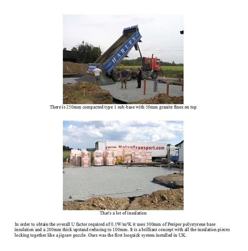

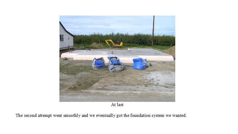

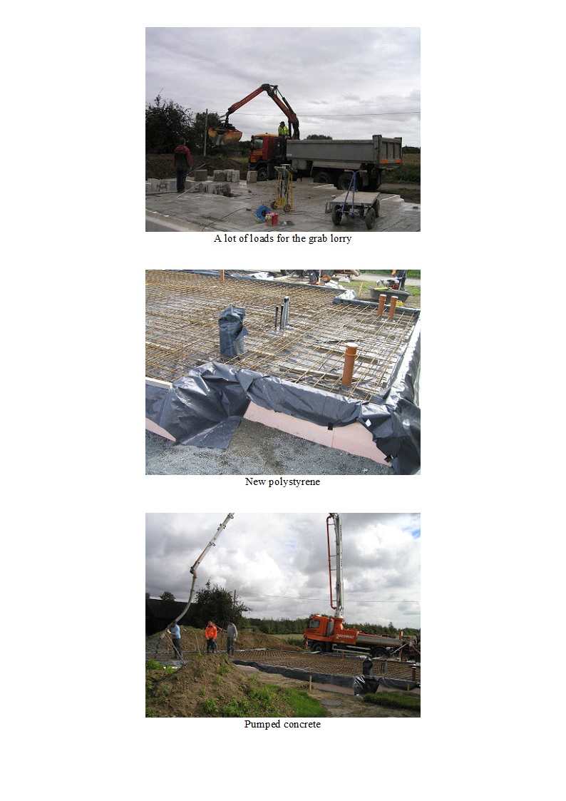

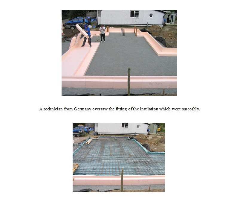

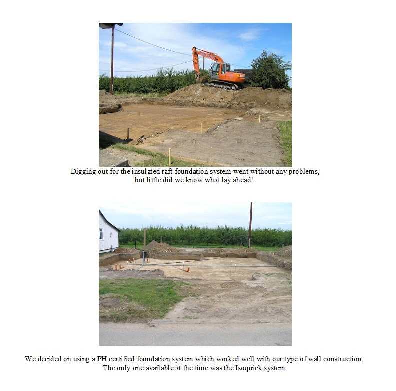

Gone West Posted September 20, 2025 Posted September 20, 2025 @saveasteading This might be of some interest. Sorry about the quality. 1 1 1

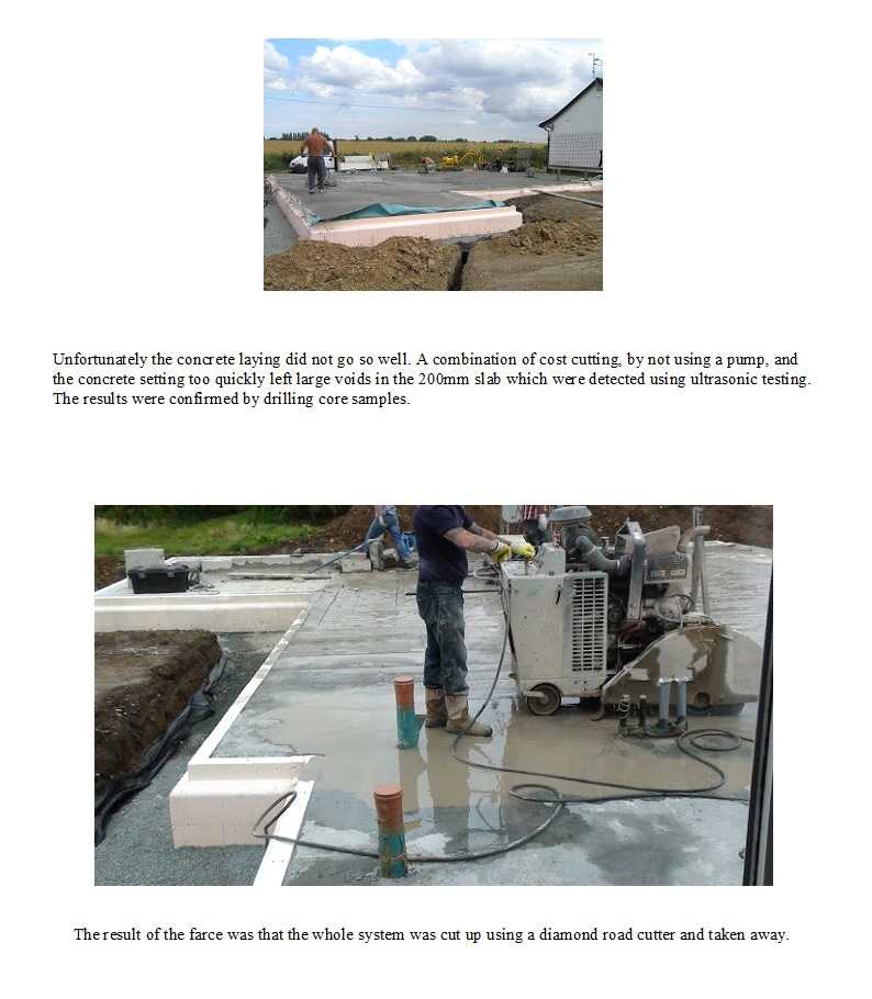

saveasteading Posted September 20, 2025 Posted September 20, 2025 Thanks. Very traumatic and expensive. What was the obvious sign that there was a problem with the slab?
Gone West Posted September 20, 2025 Author Posted September 20, 2025 54 minutes ago, saveasteading said: Thanks. Very traumatic and expensive. What was the obvious sign that there was a problem with the slab? We filmed the whole process and saw a lot of incidences of poor workmanship which made us think there were voids in the concrete. We had non destructive testing carried out over the whole slab which indicated a lot of problem areas. Those areas were core drilled which confirmed there were voids. The company accepted the results and the whole lot was replaced at no cost to us. 3
saveasteading Posted September 20, 2025 Posted September 20, 2025 The lesson learnt by the company was, I assume, to always get the concrete in quickly, ie pump. Also the recipe for a pump mix is different, so flows better even if barrowed. 1
Spinny Posted September 21, 2025 Posted September 21, 2025 18 hours ago, Gone West said: saw a lot of incidences of poor workmanship which made us think there were voids in the concrete. What sort of poor workmanship ? (I guess a lot of people like me would just assume a concrete pour is hard to get wrong.) Any idea of the cost of concrete cutting ? Did they use a specialist contractor or just hire in the cutting machines ?
Gone West Posted September 21, 2025 Author Posted September 21, 2025 42 minutes ago, Spinny said: What sort of poor workmanship ? They were barrowing the concrete, it was summer, the concrete wasn't flowing out of the barrows, it was coming out in lumps. 44 minutes ago, Spinny said: Any idea of the cost of concrete cutting ? Did they use a specialist contractor or just hire in the cutting machines ? I didn't get involved in the details of the slab removal, other than to get an assurance that there would be a different team who were competent. 1
