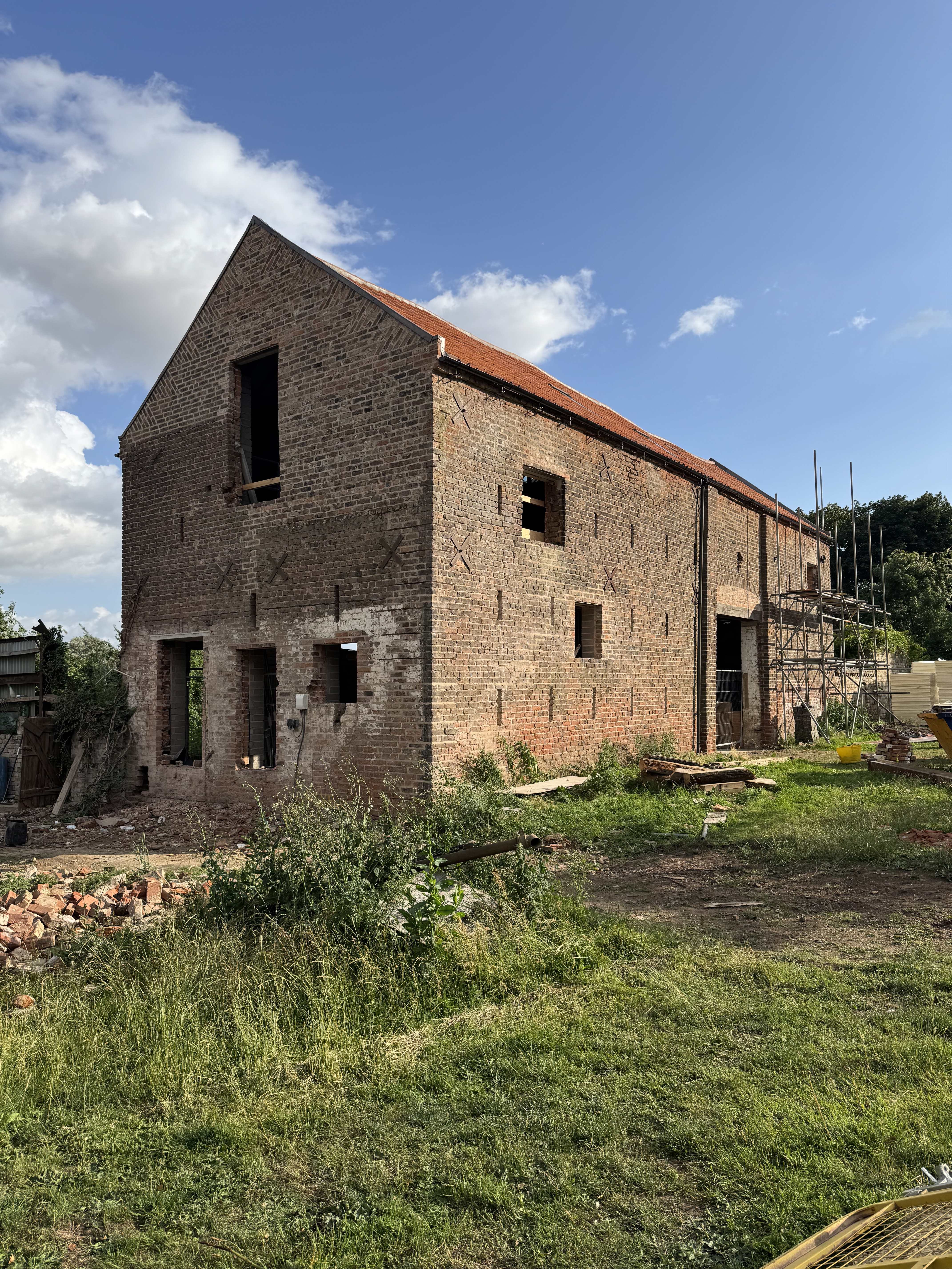

I just got alumasc heritage 125 wide (not deep) about 60m gutter and 30m downpipe -6200 plus and other bits a d bobs which cost about-30
Through local BM better rate than online.

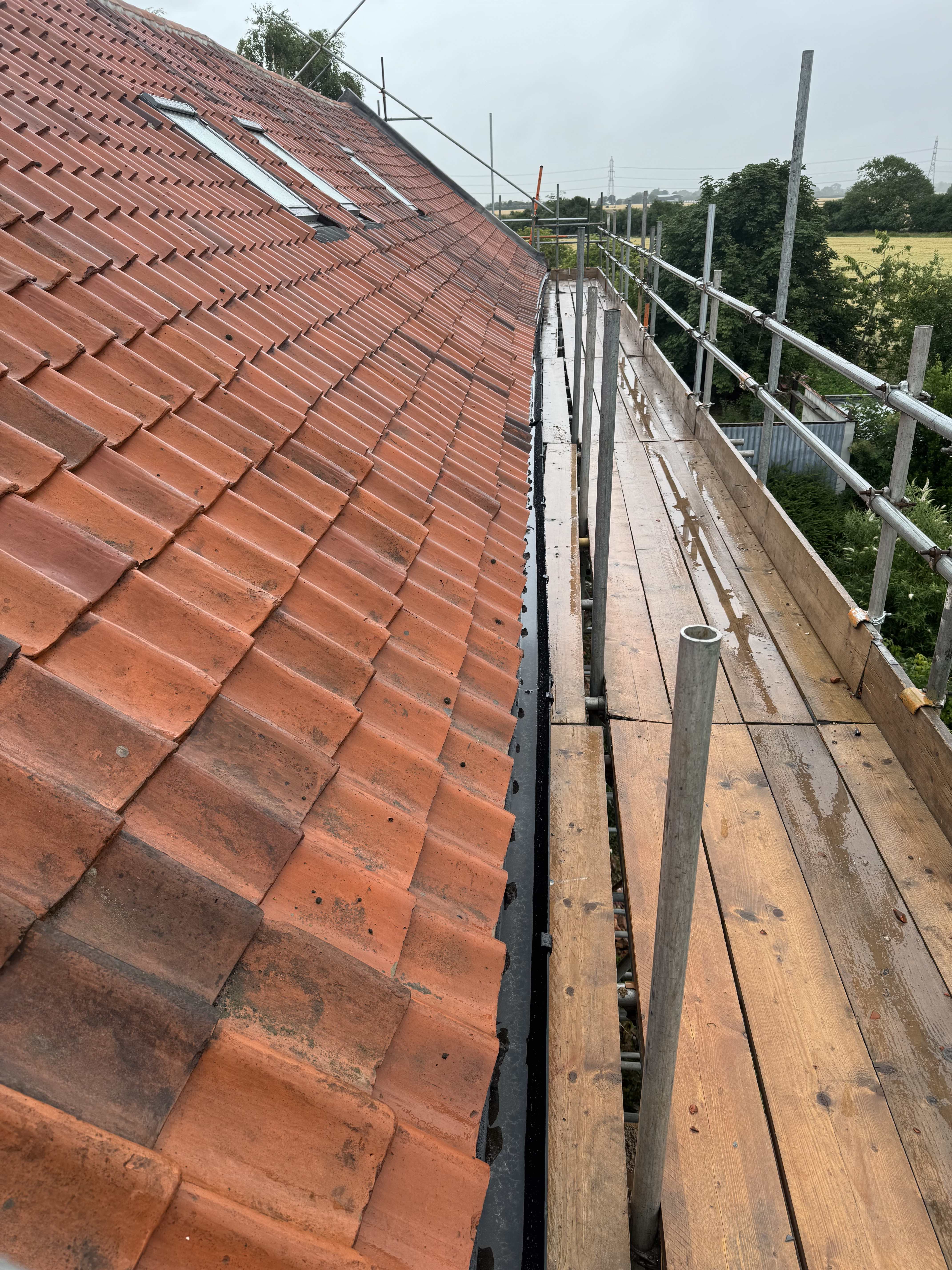

These are the best I have to hand.
The Dow pipes weren’t installed as I’d just struck the scaffold. Laid to a nominal fall (1:100)IMG_6653.thumb.jpeg.ae8df01a34d38fa99ab255d7247d444e.jpeg
Don’t mind the wonky roof. We straightened it up as much as we could but it runs out by 150+ mm. The photo was just after a heavy summer downpour which is why the gutter was full.
Quality was fine barring one section of gutter which was a different gauge but marked as the same (maybe old/new stock).
Sent off to almumasc for takeoff and did my own based on install guide. We came out roughly the same. I dropped a few things, added others.
colour is black.
