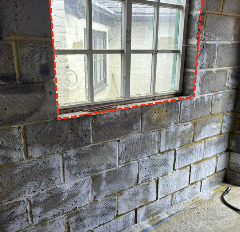

tvrulesme Posted Wednesday at 09:03 Posted Wednesday at 09:03 In the process of converting a garage to living accomodation. I'm replacing the old garage windows which were just about good enough for a shed with some high performance aluminium windows. The block walls will be insulated with insulated plasterboard mechanically fixed on to 25 x 47 battens. For the window reveals, I was wondering if it's sensible to use some 25mm PIR around the blockwork joining to the insulated plasterboard insulation layer and install the frames on top (through the PIR into the blockwork) to minimise thermal bridging. Does this make sense?

Redbeard Posted Wednesday at 19:58 Posted Wednesday at 19:58 (edited) 10 hours ago, tvrulesme said: For the window reveals, I was wondering if it's sensible to use some 25mm PIR around the blockwork joining to the insulated plasterboard insulation layer and install the frames on top (through the PIR into the blockwork) to minimise thermal bridging. Does this make sense? It does but how would you detail the 'raw' PIR perimeter on the outside - just a timber (or Alu?) fillet? Edited Wednesday at 19:58 by Redbeard Remove extraneous'n'
tvrulesme Posted Wednesday at 20:04 Author Posted Wednesday at 20:04 5 minutes ago, Redbeard said: It does but how would you detail the 'raw' PIR perimeter on the outside - just a timber (or Alu?) fillet? Outside is rendered so I was thinking of filling with render carrier board and render over it
