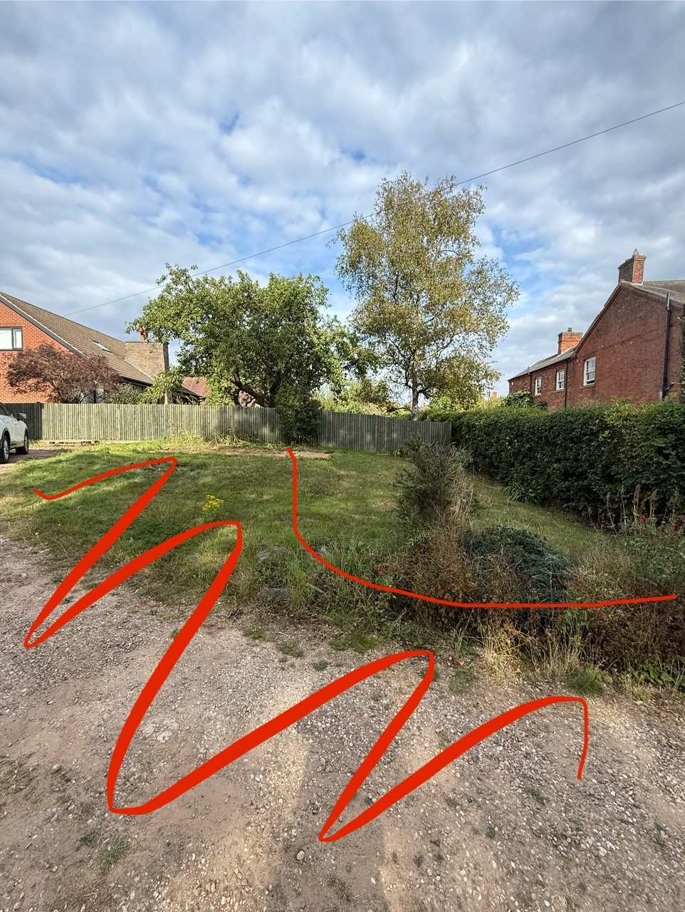

I am have finally moved onto my driveway, after going round in circles are few times we have finally decided to go with block paving (plaspave sorrento)
The main issue i have now is that the fence the driveway and path will finish onto is not straight forward and not that keen on how it looks, I don't want to spend all this money on a nice new drive and have a 'dodgy' looking edge.

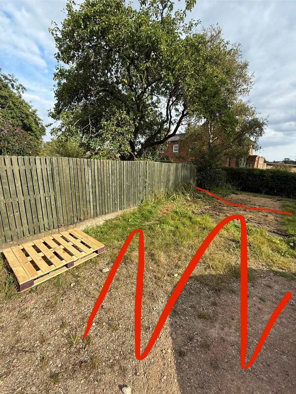

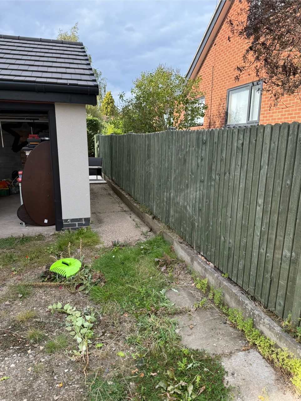

I have attached a few pictures to show this edge, there is currently slab on edge and a fence above (due to ground level of my neighbours) majority of these slab on edges are being pushed over so will need straightening up anyway. And nothing to stop this just happening again

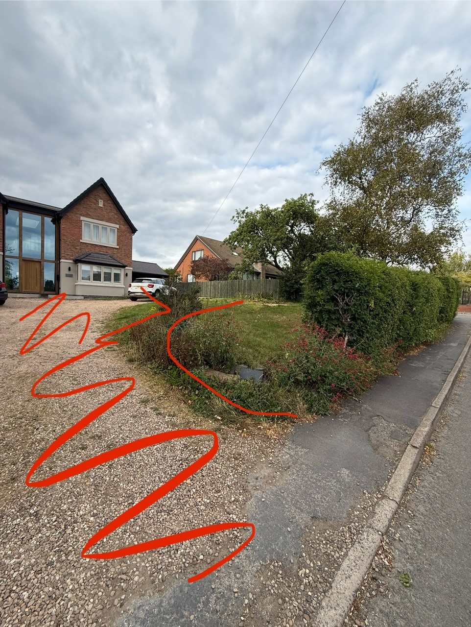

The red area is the driveway and can see where the path will be between my garage and fence
What is alternative options to these slab on edges?
I will greatly appreciated any suggestions/opinions/information on this topic

From experience I would have the drive edged (contrasting pavers etc.) then move back to a retaining wall if you need it. Taking a drive right upto a small retaining wall usually ends up with scrapes on cills, doors or wheels.

No foundation required.
Dig a small trench, put some type 1 in it and wack it down. Then lay the blocks.
The blocks have a lip on the back so they can slide over each other. The smaller ones, like you would need, are solid, the bigger ones hollow that you fill with gravel as you go.
It literally requires zero skills, and lasts forever. Though post covid, like all concrete products, they are expensive. But easy to DIY
Ive done three of these in my time. For a retaining wall, i dont know why anyone uses anything else, unless you can actually do brick laying.
They also have the advantage, which was important in my first one, is that a bit of subsidence or ground overment wont put a crack in your wall. They will absorb the movement.
These things are everywhere on motorway bridges, railways etc.
Warning though, some like the marshalls offering are NOT interlocking. Which seems completely pointless to me.
