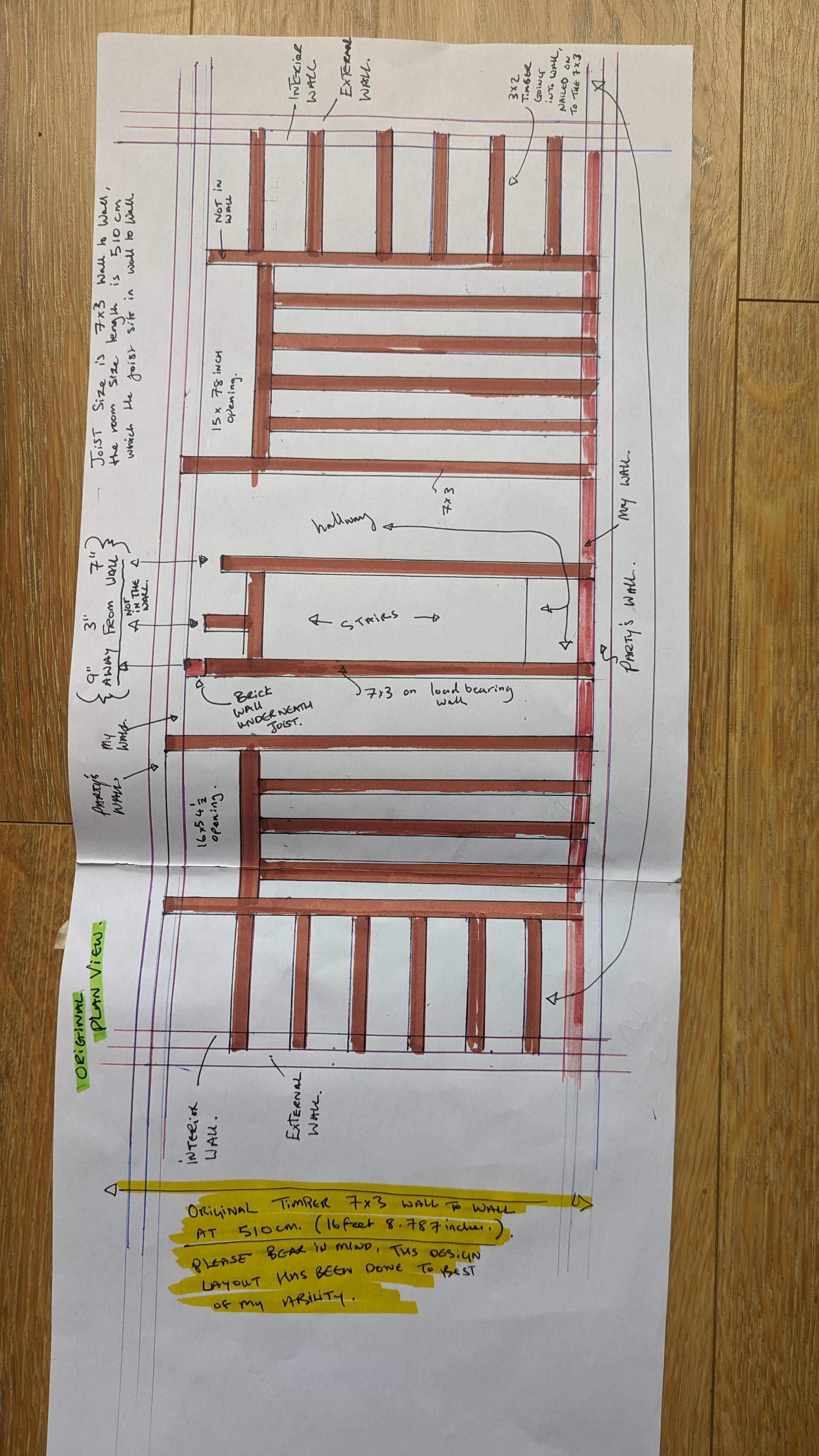

moe Posted August 20, 2025 Posted August 20, 2025 Hello everyone, I hope you are all doing well. I find myself in a bit of a bind and would greatly appreciate some assistance regarding my previous post. If any of you could lend a hand, it would really ease my mind. I need guidance on a joist that measures 7x3, spanning 5 meters, made of old timber. I've taken out the chimney breast from top to bottom, and the stack has been removed all the way down to the cellar floor. The chimney breast is on my side and isn't attached to the neighboring wall. The issue I'm facing is that when I took down the chimney breast wall, the old joist wasn't fully embedded in the wall; it was short and rested on the chimney wall. Currently, it is properly supported by an acro prop. My question is, should I sister the new timber alongside the original one? I can extend the new timber from wall to wall. Additionally, for added security, I could double the new timber, effectively creating a 7 x 6 timber connected to the old 7 x 3 timber using m12 nuts and carriage bolts. Is this the best approach? Or do any of you have a better suggestion? I look forward to hearing from all of you. I can provide a diagram of the drawing if that would be helpful. Thank you. Kind regards, Moeen.

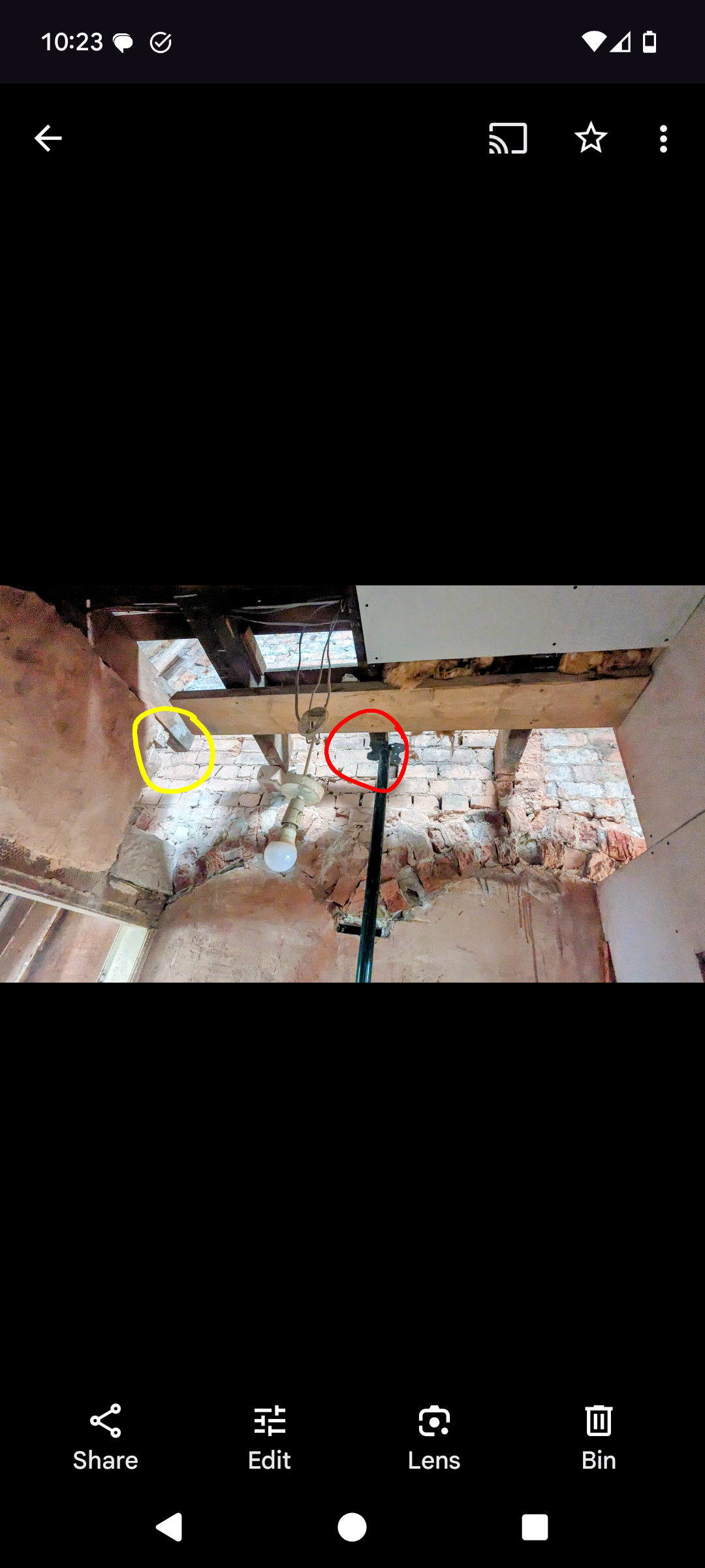

moe Posted August 21, 2025 Author Posted August 21, 2025 Hello! I've created this layout plan to the best of my skills. I hope you find it helpful. 1

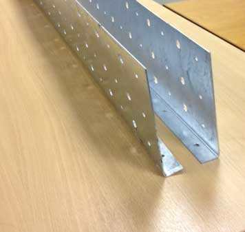

Temp Posted August 21, 2025 Posted August 21, 2025 (edited) So this is the joist that is now 7" from the wall? If this was a normal joist (eg one of a dozen similar joists crossing a room) then yes I would cut a 7x3 to fill the gap and extend into the wall. Then either sister josts both sides or use metal joist repair plates extending perhaps 2 feet either side of the joint. However I hesitate to suggest this in your case as the floor structure looks somewhat unconventional. Is this joist is supporting a wall separating the stairwell from the landing? Edited August 21, 2025 by Temp

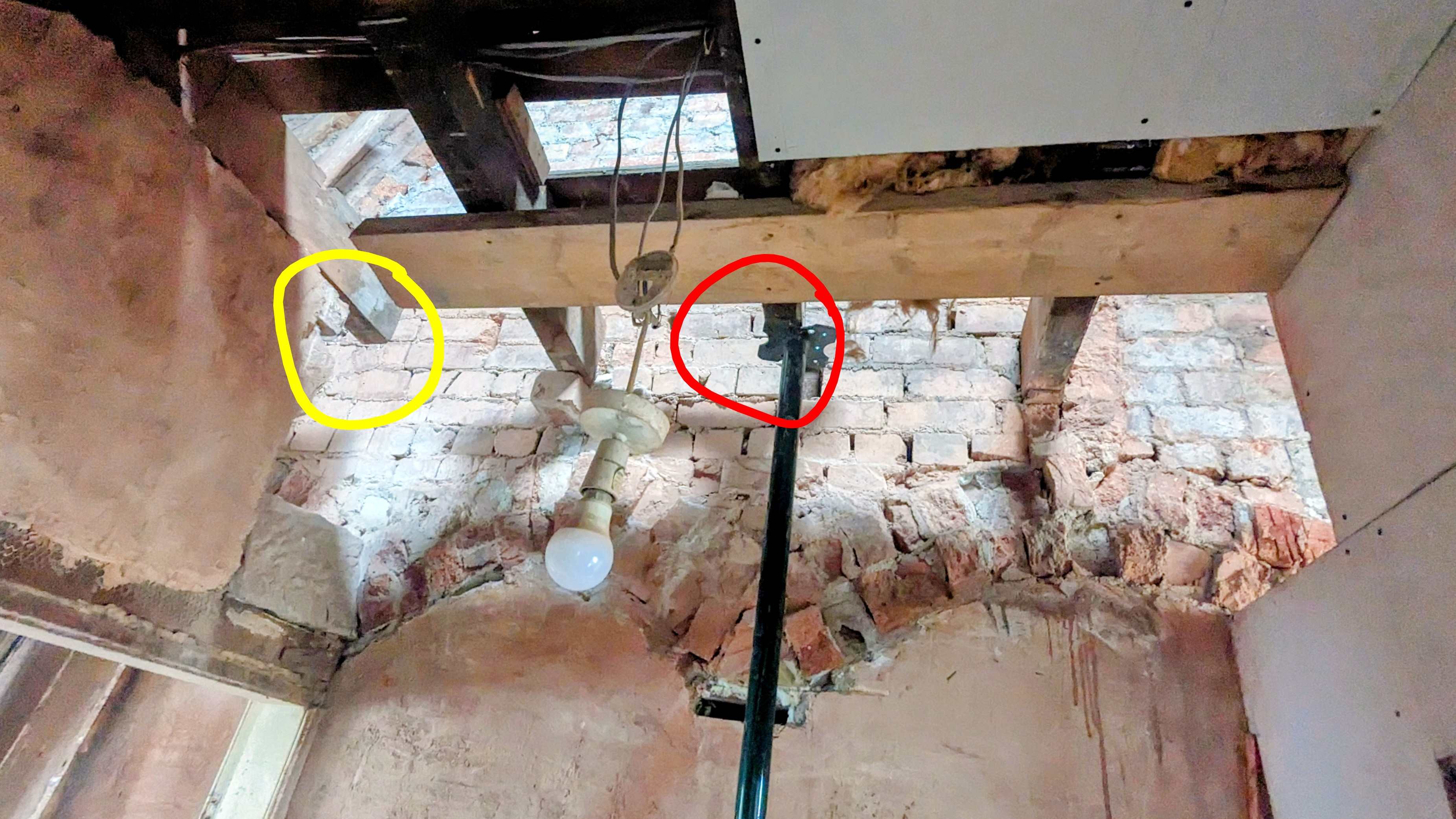

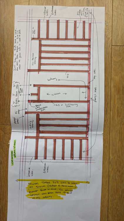

moe Posted August 21, 2025 Author Posted August 21, 2025 (edited) Hi temp, I had to rewrite this again, as I'm not computer literate. Lol The joist that is 7 inches from the wall is currently being supported by an acro prop, and there is no wall beneath it. On the other hand, the joist that is 9 inches from the wall is supported by a wall that is load-bearing, which extends all the way down to the cellar. I've attached a picture to clarify this. As you can see, the stack and chimney breast have been completely removed. The area where the joists are located was previously supported by a 'U' shaped chimney breast, which then split into two chimney breasts leading down to the cellar. In the picture, highlighted in red, you can see that the joist spans 5 meters in length—one end is anchored in the wall while the other end is not. The end that is not anchored is 7 inches away from the wall. Conversely, the joist highlighted in yellow is on a load-bearing wall, but it is 9 inches away from the wall. I apologize if I am going into too much detail; I just want to ensure everything is clear and straightforward. I hope this information is helpful, as I've done my best to explain it clearly. Thanks, Moeen. Edited August 21, 2025 by moe 1
Nickfromwales Posted August 21, 2025 Posted August 21, 2025 34 minutes ago, moe said: I apologize if I am going into too much detail; I just want to ensure everything is clear and straightforward No need! Details are what we need to be able to help you best. For the one 9" away, over the LB wall, you can simply add a section on the end, supported by say a 1800mm long new section sistered alongside, making as you sat a 6x7 there. For the other side you can do the same again, but this would ideally need to be the full length, and would be subject to the condition of the timber (at the end opposite the chimneys) being in good order. If in any doubt there, you'd need to cut a new pocket alongside the existing one for the new timber to slide into; if it were my own place I'd do this first as last to be sure. You probably cannot get a full new timber in as the new timber would be longer than the width of the room. The piece 3" from the wall is a simple swap out for a new piece afaic?
moe Posted August 21, 2025 Author Posted August 21, 2025 55 minutes ago, Nickfromwales said: No need! Details are what we need to be able to help you best. For the one 9" away, over the LB wall, you can simply add a section on the end, supported by say a 1800mm long new section sistered alongside, making as you sat a 6x7 there. For the other side you can do the same again, but this would ideally need to be the full length, and would be subject to the condition of the timber (at the end opposite the chimneys) being in good order. If in any doubt there, you'd need to cut a new pocket alongside the existing one for the new timber to slide into; if it were my own place I'd do this first as last to be sure. You probably cannot get a full new timber in as the new timber would be longer than the width of the room. The piece 3" from the wall is a simple swap out for a new piece afaic? Hello, I really appreciate your response. I can obtain a new full-length timber and wall-to-wall on both sides while sistering. I can double it, and it's feasible since I started early today on the walls, having opened them up from my side. I've done this very carefully, and quite a bit of dust came out, haha.😁😅 So, in theory, I can sister the old joist to create a '6 x 7' inch joist (C24 graded) using nuts and M12 carriage bolts. However, the new joist will be an 8 x 3, trimmed down to a 7 x 3 timber to match the original 7 x 3 timber. Since the new timber is smaller than the original, it makes sense to match them closely for like for likeness. I hope this information is helpful. Thanks, Moeen. 1
Nickfromwales Posted August 21, 2025 Posted August 21, 2025 7 hours ago, moe said: Hello, I really appreciate your response. I can obtain a new full-length timber and wall-to-wall on both sides while sistering. I can double it, and it's feasible since I started early today on the walls, having opened them up from my side. I've done this very carefully, and quite a bit of dust came out, haha.😁😅 So, in theory, I can sister the old joist to create a '6 x 7' inch joist (C24 graded) using nuts and M12 carriage bolts. However, the new joist will be an 8 x 3, trimmed down to a 7 x 3 timber to match the original 7 x 3 timber. Since the new timber is smaller than the original, it makes sense to match them closely for like for likeness. I hope this information is helpful. Thanks, Moeen. Yup. Steam on 👍👌
