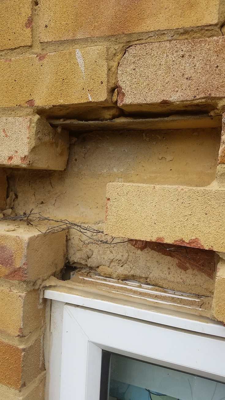

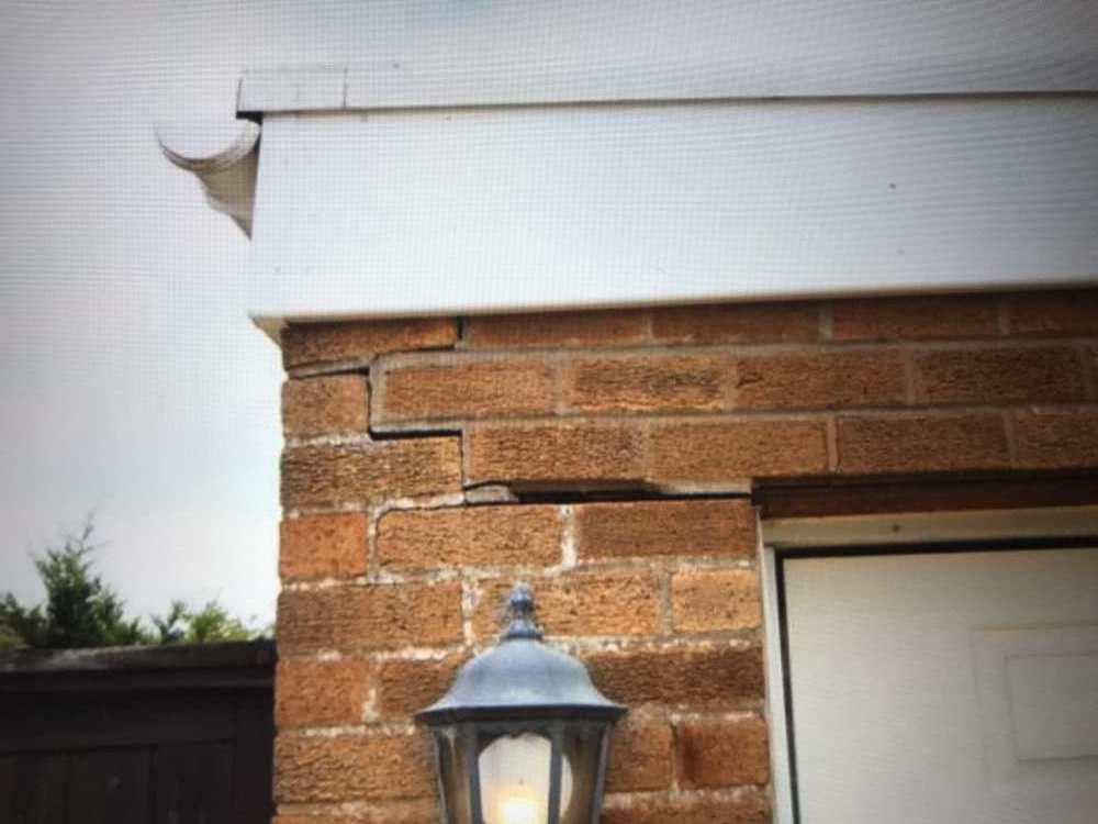

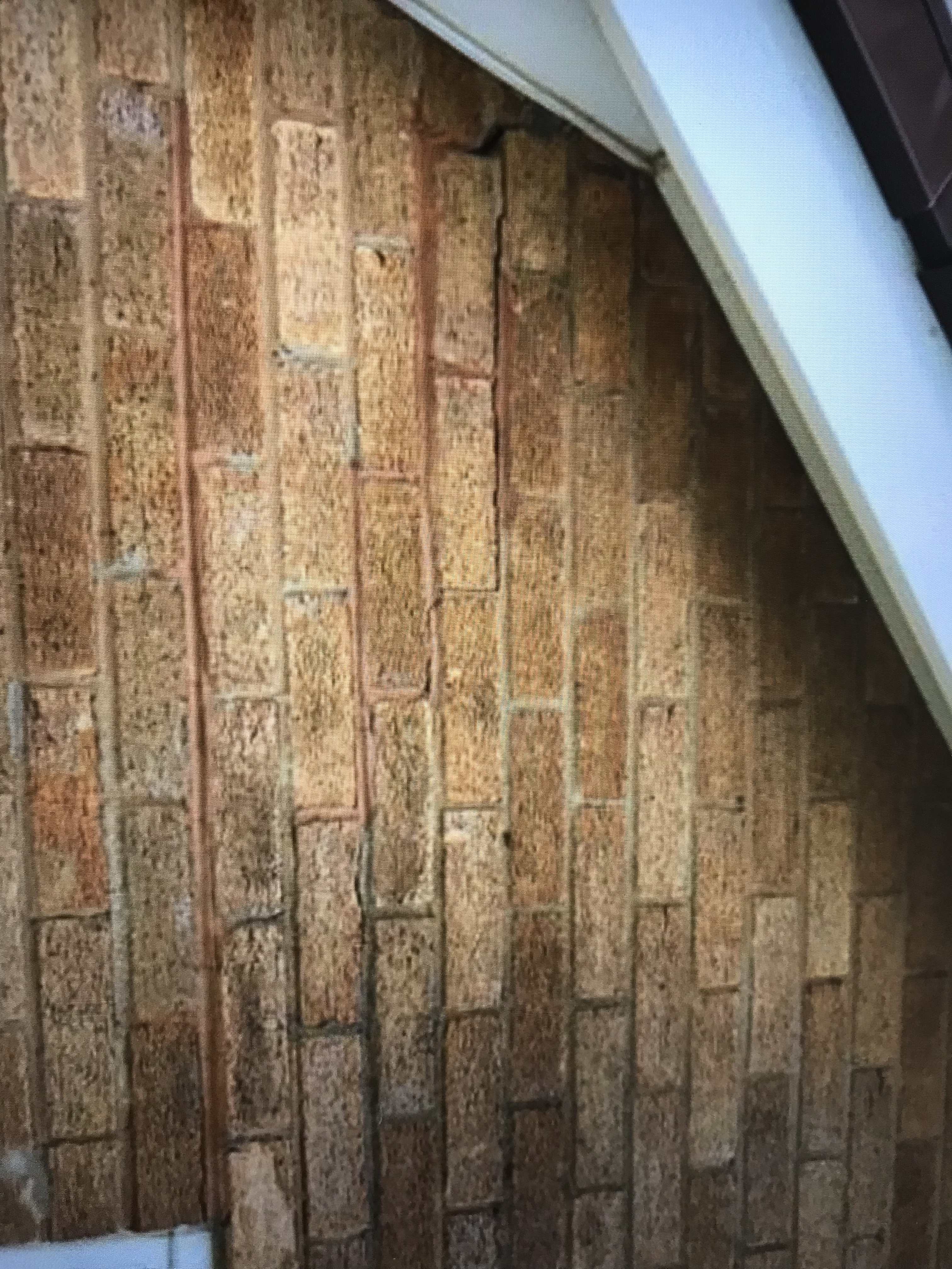

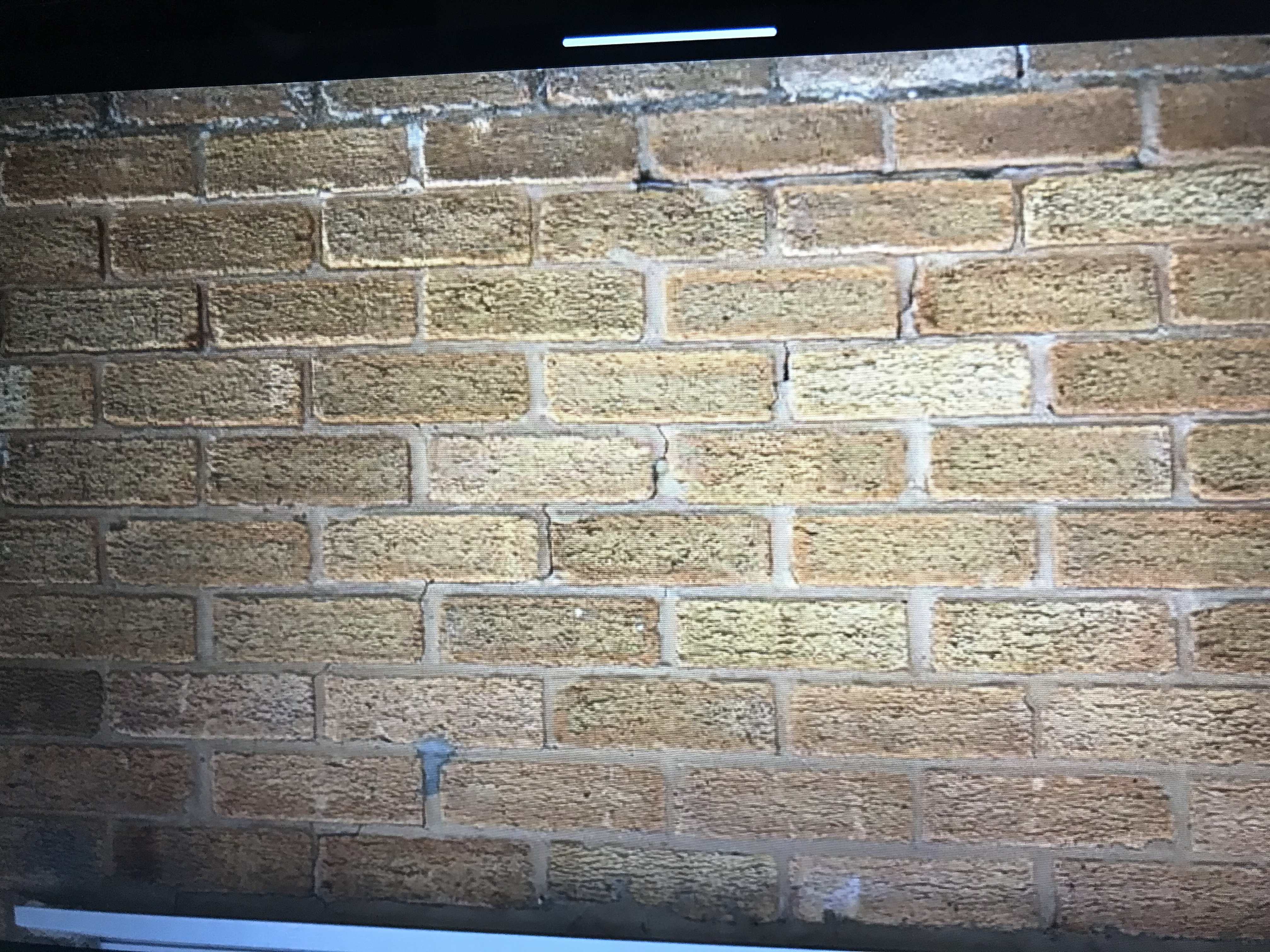

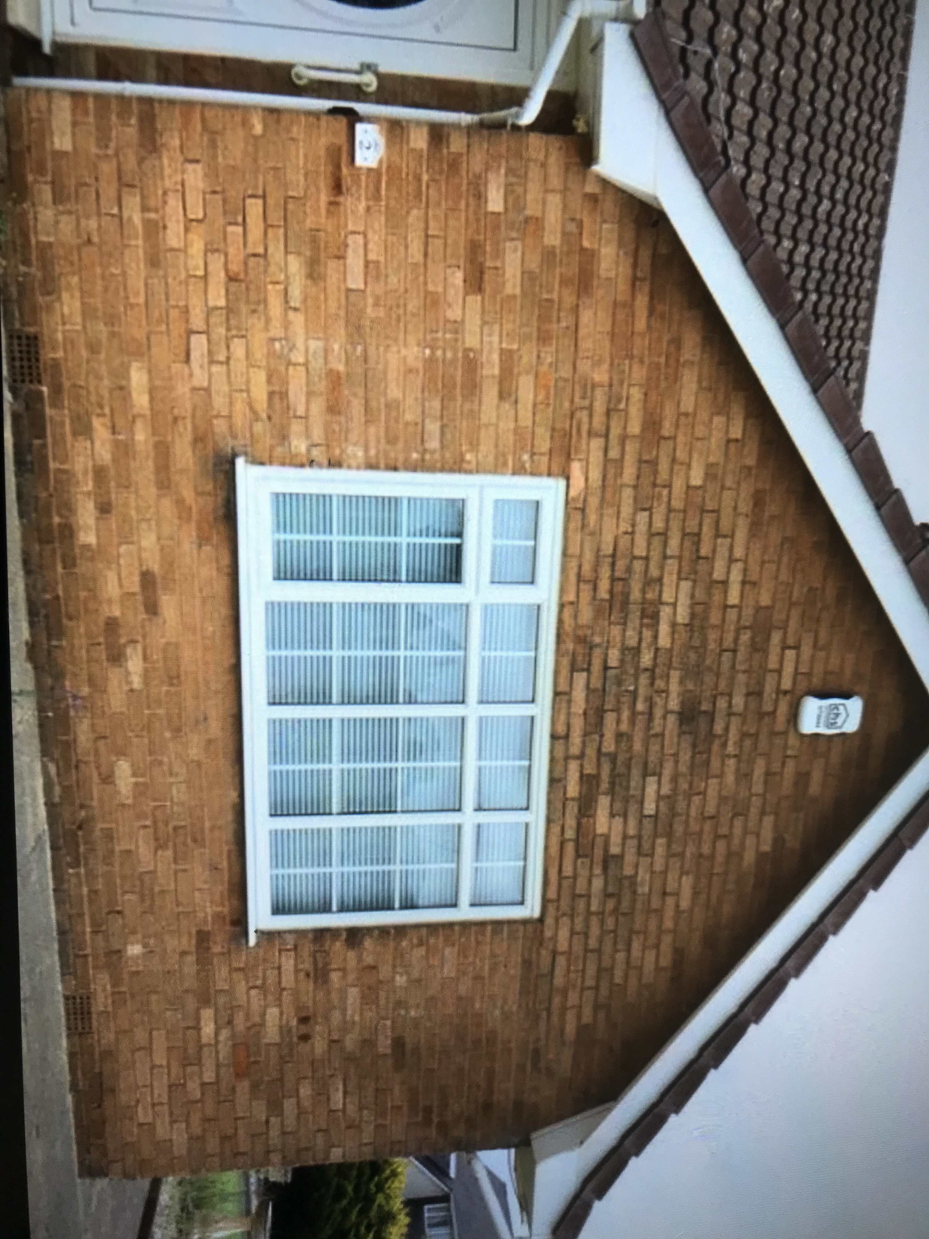

Mike Hawkins Posted August 19, 2025 Posted August 19, 2025 Hi, hoping to get some advice off you good people, any advice is greatly appreciated. The whole front of the 1960s bungalow needs seriously repointing but front bay has what I believe, and hopefully, historic settlement cracks. A couple of people have tried to tell me it is a lintel failure but it looks ok to me. It has three small stepped cracks, top left, top right and one below the window. Non are major and could only upload 2 photos for some reason,but can tell there has been a previous attempt to repoint the cracks, quite poorly. Do you think I have anything major to worry about and needs further investigation carried out or would pinning the cracks and repointing the whole lot worth trying first? Not a youngster so dont need forever out of the repair. Cheers and TIA, Mike Sent from my iPhone
Nickfromwales Posted August 19, 2025 Posted August 19, 2025 Looks to be very much associated with expansion at the lintel, so likely caused by the lintel. When these corrode and expand, they have a lot of force/ energy to get rid of, so the resultant cracks (linear) are characteristic of this type of failure. You can simply keep re-pointing this, and pass the issue on down the line. 1
Mike Hawkins Posted August 19, 2025 Author Posted August 19, 2025 Thank you so much for the reply. Does lift my spirits that you think it is the lintel and not settlement / more worrying structural issues. As you say, It must have some force to generate 3 separate cracks, not that wide but still quite long. Would you suggest getting the lintel replaced or just get the cracks pinned and pointing suffice? Cheers

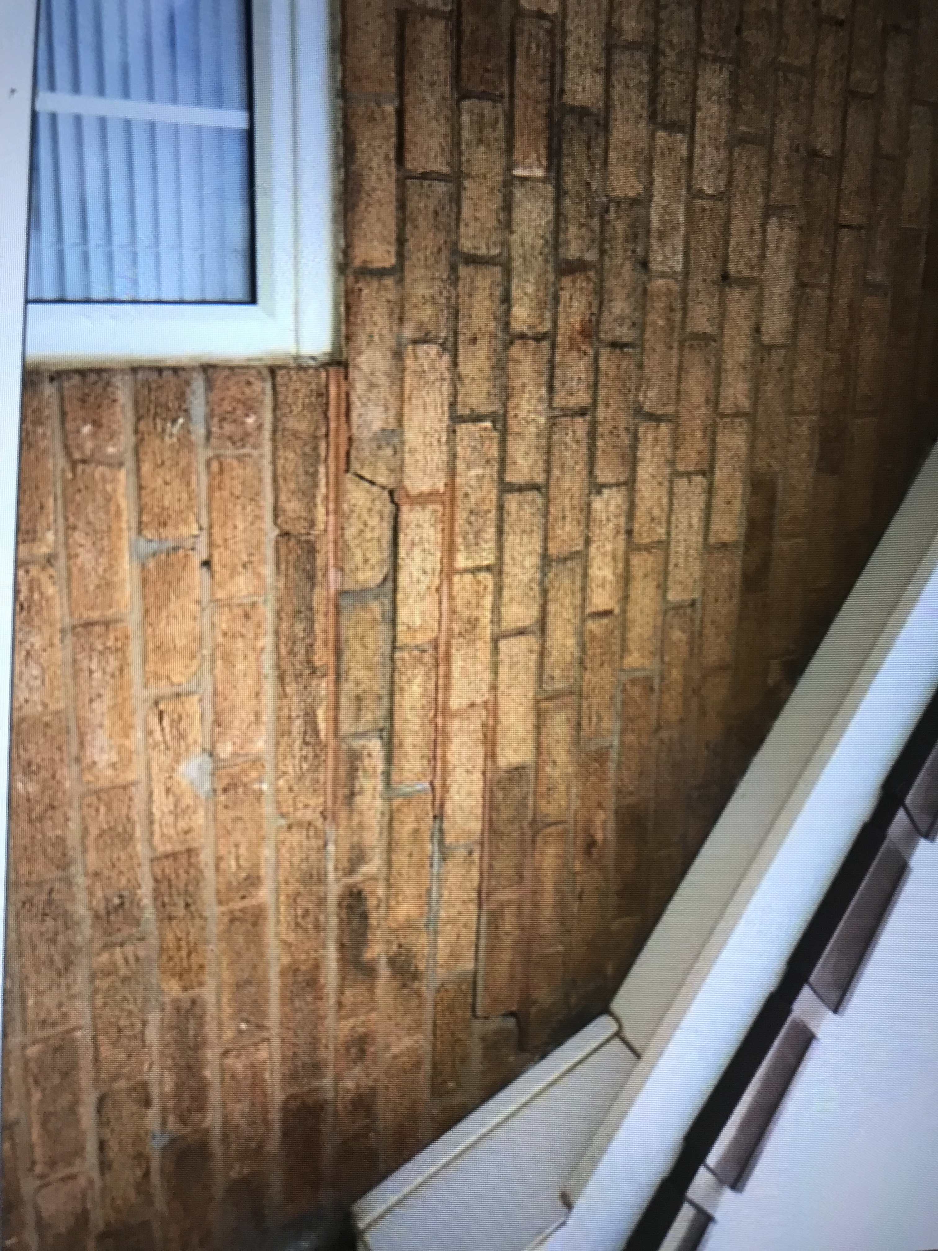

saveasteading Posted August 20, 2025 Posted August 20, 2025 How wide are the cracks? They look very small. It's a shame some have gone through bricks rather than mortar, but it looks fairly benign.
Mike Hawkins Posted August 20, 2025 Author Posted August 20, 2025 Hi, thanks for the reply,, would say about. 3mm or so not very wide but run the full length. Added a photo of top left crack.

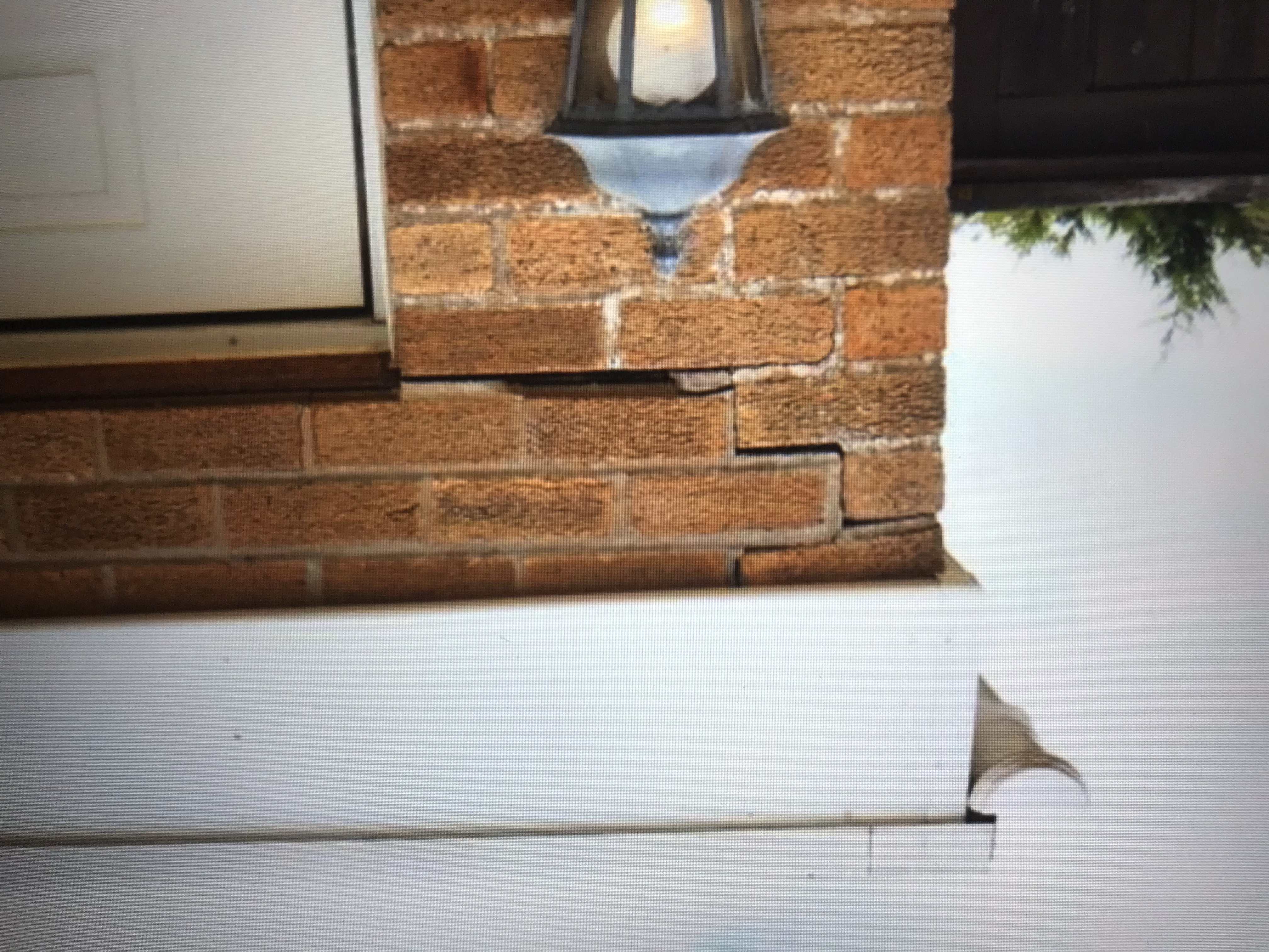

Mike Hawkins Posted August 20, 2025 Author Posted August 20, 2025 The crack below the window! Again, thanks for the advice.
Nickfromwales Posted August 20, 2025 Posted August 20, 2025 2 hours ago, saveasteading said: How wide are the cracks? They look very small. It's a shame some have gone through bricks rather than mortar, but it looks fairly benign. I’d bet the split in the brick is exactly where the end of the lintel is. Prob best to bite the bullet and get the lintel exposed and checked, and replaced if it is the offending article. Obvs it’s very hard for us to say with any certainty, over the internet, so a builder would better advise on site I expect. I’d say you’d have cracks much further down the wall if it were subsiding, and possibly inside too.
Redbeard Posted August 20, 2025 Posted August 20, 2025 (edited) 1 hour ago, Mike Hawkins said: The crack below the window! AFAICS that pic is upside down (the white moulding at the bottom appears to protrude, and the earlier pics show no top drip detail, so I think it's maybe the cill, upside-down), so maybe some of the cracks are down towards the ground (re @Nickfromwales' point). Nevertheless, if we 'park' any cracks below the window for now, can I raise a further possibility? That it is not so much a problem with the lintel, but that *there may not be a lintel*. I had this problem with a relative's house, and it was the same for (I believe) many (tens of?) thousands of 1960's and possibly '70's and '80's houses. In my relative's case the house was built with reasonably stout timber windows, the top rail of which acted as a lintel. That situation pertained perfectly until the timber windows were replaced with uPVC (and at that time many uPVC windows did not have much, if any, steel reinforcement). Then the step-crack appeared, slowly, over a number of years. On sale of the house the issue was raised and invasive work carried out to prove the 'diagnosis': no lintel on the outer skin, and no, the inner-skin lintel did not cross the cavity and 'pick up' the back edge of the outer skin, as one builder had suggested would be the case. As I type now I can look out of the window to a 1960's or 1970's house with visibly 'drooping' uPVC FF windows. I have been waiting for a number of years (and still am!) for the DGU to 'explode' when finally the weight of the masonry above comes fully onto the glass, not (as I suspect is the case still) onto an air-gap above the glass. Edited August 20, 2025 by Redbeard re cill protusion 1
Mike Hawkins Posted August 20, 2025 Author Posted August 20, 2025 Thanks for the reply.You are right about the last photo, it is upside down, the others one their side mainly. Not very tech savvy. Never even thought of no lintel. I would have expected lintel use for a 60s bungalow?? But that's why I'm here trying to get the advice, cheers.

Redbeard Posted August 20, 2025 Posted August 20, 2025 (edited) Easy? We-e-e-ll, brick removal is not difficult... If it were me I'd prop temporarily (actually probably quite difficult as there appears (again, AFAICS from the pics) to be a tiny reveal, so not much to 'get hold of') and remove a couple of bricks. In reality you may probably be able to remove 2 bricks without propping, but I am not going to recommend that on a house I have never seen, you'll appreciate). If you are better than me at 'reading' boroscope pics you could just drill a hole to look. Edit: Ahah! @iceverge was posting while I typed, and suggesting just that) Edited August 20, 2025 by Redbeard cross-posted
saveasteading Posted August 20, 2025 Posted August 20, 2025 f there was no lintel it would have fallen down a long time ago. 3mm is usually not a concern. Buildings move. I'd not be worrying. You have recorded it. Now wait for the winter and see if it gets better or worse. Do NOT fill the gaps or they may stress if there is movement back again. Moral: mortar should always be weaker than the bricks.

Mike Hawkins Posted August 20, 2025 Author Posted August 20, 2025 Hi Saveasteading. Thanks for you input. Added a photo of the corner of the garage, still working on getting photos right way up.. Fairly confident it is a lintel, prepared to be told otherwise of course. Why do you say unlikely to be a lintel in the front of the bungalow? Is it because of the thin long crack below the window? Cheers

saveasteading Posted August 20, 2025 Posted August 20, 2025 38 minutes ago, Mike Hawkins said: still working on getting photos right way up. I sympathise. the app is pretty good though in doing this for you as an attachment from a smart phone. Otherwise there are clever bods on here. The garage is indeed awful. Built by idiots who get away with it because it's 'only' a garage. What is the plan? It is much easier than it would be with the house. a couple of acrow props to support the roof. take out the bricks and the door, insert lintel and rebuild. Maybe the door can even stay? Re the house, 98% there is a good and working lintel. In the 60s it wouldn't be a sophisticated catnic type. I can't right now think of the likeliest method, but it wouldn't be to sit the wall on the window.
Mike Hawkins Posted August 20, 2025 Author Posted August 20, 2025 Hi, with the garage, i think it is a straightforward lintel replacement. My main concern is with the bungalow trying to work out if it is a lintel issue(assuming and fairly likely there is one now) and guess there is no way of finding out without digging in, my worry is possibly settlement or something else sinister, going by the lower thin crack which seems to contradict and possibly suggest something else. I do know the windows are very early uPVC, would guess 20 years old so been in a long time. These are the fears of a layman with little knowledge who resides in worst case scenario land and worries accordingly. The full front of the bungalow needs repointing so considering just having the three cracks pinned and pointing carried out as could have lintel replaced and be a waste of time or money. Again all advice appreciated. Hope it all makes sense., Cheers.

Redbeard Posted August 20, 2025 Posted August 20, 2025 Here's the one I 'unearthed'. Big conc. lintel on the inner skin and chicken-wire on the outer, a course above the window-head. The whole estate was built like this.
Redbeard Posted August 20, 2025 Posted August 20, 2025 I claim no skills whatsoever with digital pic-wrangling, but try this:
