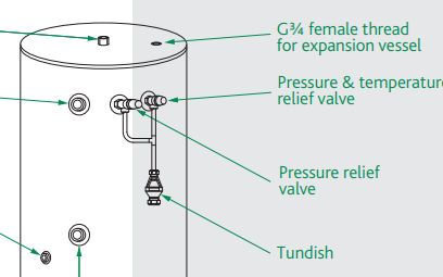

jack Posted August 15, 2025 Posted August 15, 2025 The overtemperature/pressure valve on my pressurised DHW tank has started leaking (again). This is the model: My understanding it that it's a combined temp/pressure release valve (there's a separate 3.5 bar overpressure valve connected to the same tundish). I also remember reading that these types of valves have a tendency to leak after they've been triggered, or even after testing. This is the second time this one has failed. Last time, the bladder on the expansion vessel had failed without me realising, leading to higher than usual system pressure. However, I don't now whether that was the cause of the valve failure. Our static pressure is less than 3 bar, so I doubt the system has ever seen anything like 4.5 bar, even with the immersion diverter working. I wonder whether the immersion diverter is occasionally causing the temperature near the top of the tank to exceed the trigger temp for this valve? I recently installed the relay module on our Eddi immersion diverter, which will let me control the maximum temperature better. I also have a couple of spare pockets that I could use for something like a solar mixing pump, but I'd rather avoid any more complexity. So my questions: If you had to speculate, what do you think is the most likely source of failure? If it's likely to be temperature, are there brands of valve that are better at coping with being triggered and returning to closed without leaking? What is the most appropriate pressure for my expansion vessel? Anything else I should be thinking about? Thanks as always.

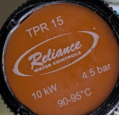

jack Posted August 16, 2025 Author Posted August 16, 2025 21 hours ago, Nickfromwales said: Give it a dozen cracks open, and slammed shut. See if that clears any debris which is what is usually the issue. Right, I've had a bit of time this morning to look more closely at this. It's actually the pressure relief valve that's failed. The 15 mm pipework from outlets of the PRV and the PTRV joins before the tundish (I assume that's acceptable?), so it isn't possible to tell which one's failed without disconnecting the pipework from the valve outlets. The failed valve is a Reliance 102-series 3.5 bar PRV. Apparently that's a "cold water only" valve. I think this was the valve originally supplied with the cylinder, but it's also possible I asked that it be replaced at the same time I had the TPRV replaced a few years back. Either way, it doesn't appear to be the correct valve for this application. Annoyingly, none of the Reliance valves designed for hot water systems come in a 3.5 bar variant. There's 107 series that is allegedly for "cold water use only", but it has a 110° max working temp. Shame I didn't realise what was going on yesterday or I could have given their technical department a call to see what the deal is there. On the assumption that I shouldn't increase to a 4 bar version, and a 3 bar version is too low given I'm already having issues with the 3.5 bar version, I may need to look elsewhere. Annoyingly, I can't see any obvious options with the same form factor, inlet fitting, and outlet fitting. If the Reliance 107 model mentioned above isn't suitable, it might be time to replace both valves with a different brand and adapt the outlet pipework to suit. Anyone have any thoughts?
Nickfromwales Posted August 16, 2025 Posted August 16, 2025 24 minutes ago, jack said: Right, I've had a bit of time this morning to look more closely at this. It's actually the pressure relief valve that's failed. The 15 mm pipework from outlets of the PRV and the PTRV joins before the tundish (I assume that's acceptable?), so it isn't possible to tell which one's failed without disconnecting the pipework from the valve outlets. The failed valve is a Reliance 102-series 3.5 bar PRV. Apparently that's a "cold water only" valve. I think this was the valve originally supplied with the cylinder, but it's also possible I asked that it be replaced at the same time I had the TPRV replaced a few years back. Either way, it doesn't appear to be the correct valve for this application. Annoyingly, none of the Reliance valves designed for hot water systems come in a 3.5 bar variant. There's 107 series that is allegedly for "cold water use only", but it has a 110° max working temp. Shame I didn't realise what was going on yesterday or I could have given their technical department a call to see what the deal is there. On the assumption that I shouldn't increase to a 4 bar version, and a 3 bar version is too low given I'm already having issues with the 3.5 bar version, I may need to look elsewhere. Annoyingly, I can't see any obvious options with the same form factor, inlet fitting, and outlet fitting. If the Reliance 107 model mentioned above isn't suitable, it might be time to replace both valves with a different brand and adapt the outlet pipework to suit. Anyone have any thoughts? Ok. Exactly where is this valve. Is it the cold mains ‘blow off’ on the control group block? If so, it should be minimum 5 bar or even 6 bar, as factory.

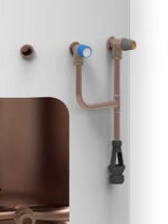

jack Posted August 16, 2025 Author Posted August 16, 2025 It's on the cylinder. To save me going and taking a photo, this is how it came from the manufacturer (McDonald Cylinders): The one on the left is the PRV, which is what's failed. Interestingly, this diagram shows a light blue handle on the valve, which accords with the 107-series ("cold only", but rated to 110° C) Reliance valve I mentioned above.
Nickfromwales Posted August 16, 2025 Posted August 16, 2025 41 minutes ago, jack said: It's on the cylinder. To save me going and taking a photo, this is how it came from the manufacturer (McDonald Cylinders): The one on the left is the PRV, which is what's failed. Interestingly, this diagram shows a light blue handle on the valve, which accords with the 107-series ("cold only", but rated to 110° C) Reliance valve I mentioned above. I’ve NEVER ever seen one of those fitted, that’s bloody rubbish. You can’t have a PRV that’s the same or lesser than the one on the CG!! That needs deleting imho.

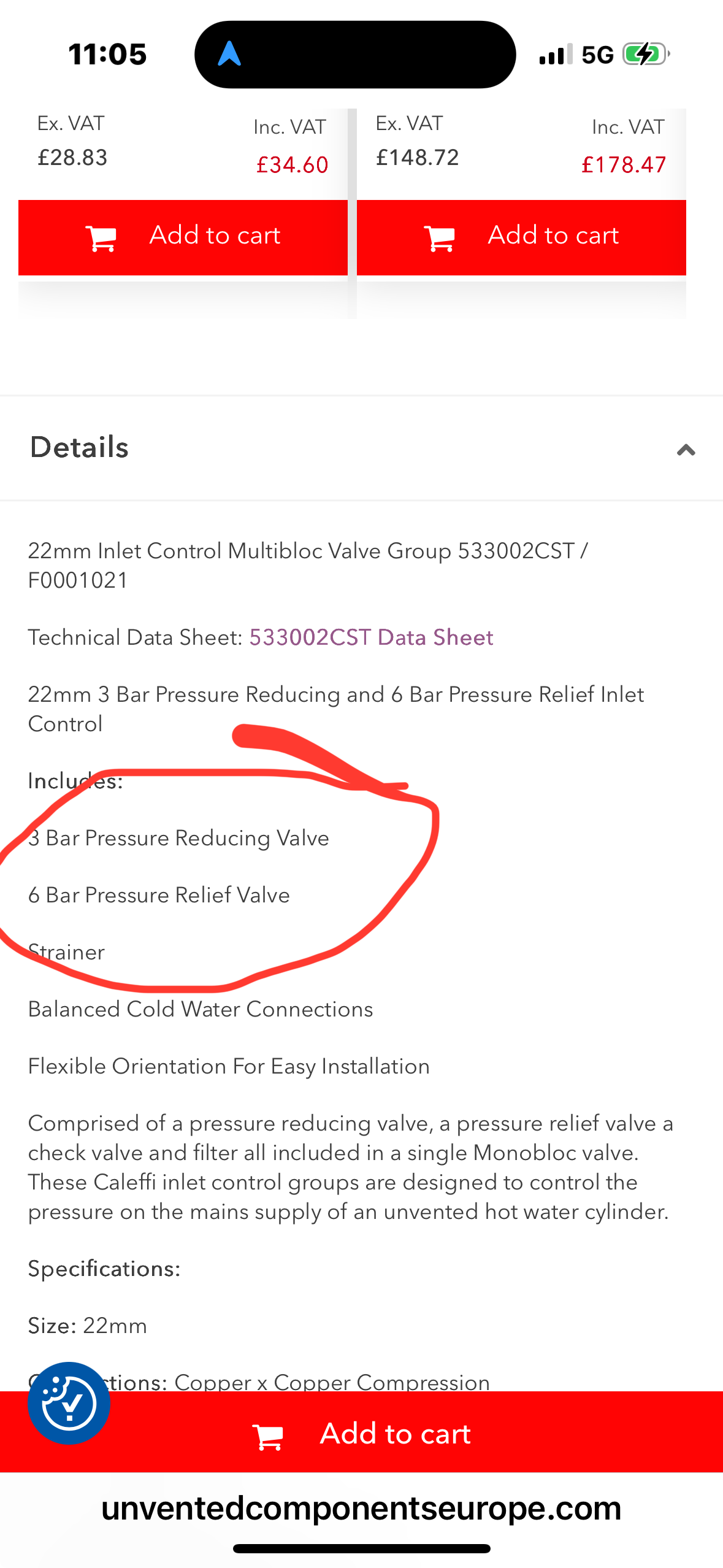

jack Posted August 16, 2025 Author Posted August 16, 2025 14 minutes ago, Nickfromwales said: Have you got a pic of their CG as installed plz? There's no control group as such. There's a pressure reducing valve on the incoming main. It's a bit hard to get to and I can't remember the pressure it's set at, but possibly 3 bar? Our static water pressure is typically around 2.8-3 bar I think. There's no pressure relief valve at that point. I'd be happy to use this opportunity to rejig the whole setup tbh. The dynamic water pressure's always been a bit shite, probably at least partly due to the pressure drop across the water softener. There's been the odd weep from a couple of the connections that I want to sort out too.

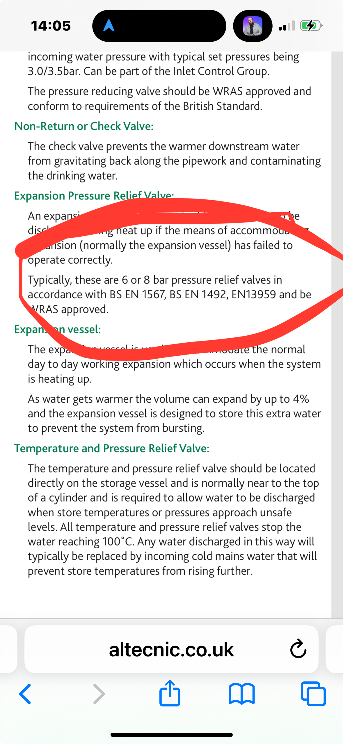

jack Posted August 16, 2025 Author Posted August 16, 2025 17 minutes ago, Nickfromwales said: I’ve NEVER ever seen one of those fitted, that’s bloody rubbish. You can’t have a PRV that’s the same or lesser than the one on the CG!! That needs deleting imho. Incidentally, this is the same setup as Altecnic (possibly rebadged? I know McDonald and another manufacturer sell exactly the same cylinder we bought from them):
Nickfromwales Posted August 16, 2025 Posted August 16, 2025 @jack From that link I think you had a monkey boy change that and he’s installed the wrong one. Just makes zero sense whatsoever. Stinks of (2nd) installer error.

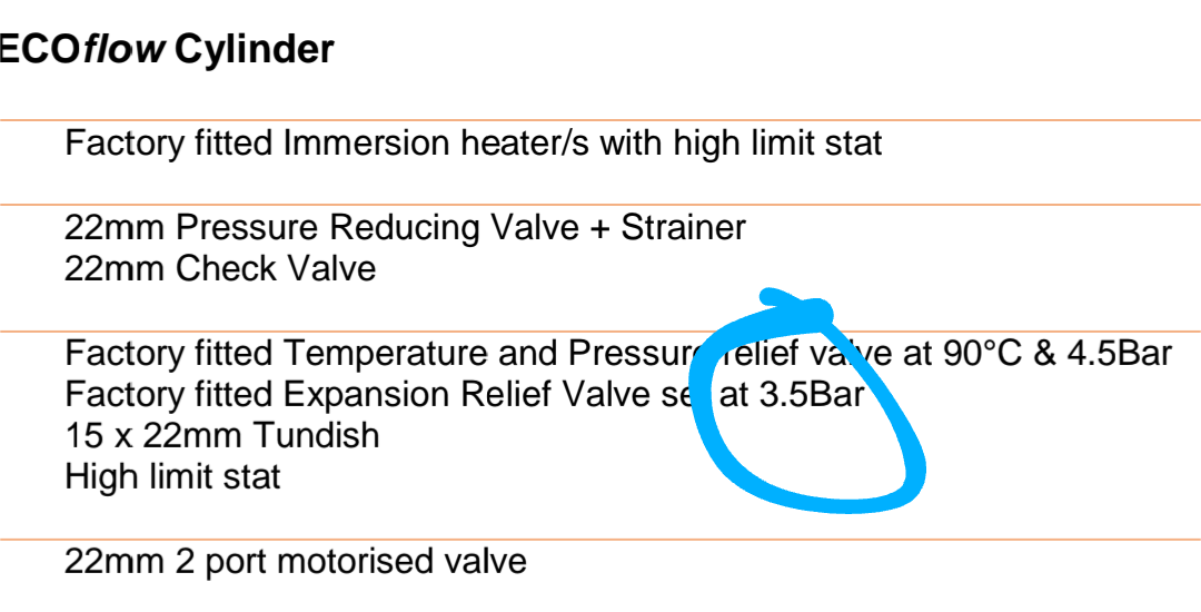

jack Posted August 16, 2025 Author Posted August 16, 2025 Nope. Cylinder manufacturer's instructions say this is supplied with a 3.5 bar PRV: (The guy was a complete monkey though. Installed the water softener isolation valves the wrong way around, so you wouldn't have been able to isolate the unit. I sorted it was wrong the second a looked at it. He failed to screw the waste trap onto its fitting when he was done, which I only learned about several months later when I found mould growing behind the tank. And the pipework he assembled for the water softener was crooked and put a lot of sidewards force onto some of the fittings. And my wife wonders why I don't just get trades in to do things that need doing around the house!)
Nickfromwales Posted August 16, 2025 Posted August 16, 2025 That 3.5bar relief is just stupid. The PRedV sorts you out at 3.0 or 3.5bar incoming, and protection against that failing is a 5/6 or even 8 bar PRV, usually on the inlet control group. What a shit design! Sorry.
jack Posted August 16, 2025 Author Posted August 16, 2025 2 hours ago, Nickfromwales said: That 3.5bar relief is just stupid. The PRedV sorts you out at 3.0 or 3.5bar incoming, and protection against that failing is a 5/6 or even 8 bar PRV, usually on the inlet control group. What a shit design! Sorry. Ha, no need to apologise, I'd rather have the honest feedback. I assume the reason for the low relief valve pressure is that this is a copper cylinder, which I expect has a lower max pressure than stainless steel?
Nickfromwales Posted August 16, 2025 Posted August 16, 2025 24 minutes ago, jack said: Ha, no need to apologise, I'd rather have the honest feedback. I assume the reason for the low relief valve pressure is that this is a copper cylinder, which I expect has a lower max pressure than stainless steel? Yup. I think the increase in expansion volume may aid this situation, and hopefully keep the cylinder static pressure in check; in an ideal design it should be away from the threshold it is living at, eg its obvious that this lives at/on the absolute limit of what the valve is set to react at. The fact it was copper is probably in amongst the trail here, I just assumed stainless, sorry again lol. Adding some more expansion volume is what I would do, if I was asked to sort this out away from here, so that’s what I’d advise you to do. Should put it to bed once and for all. 1
