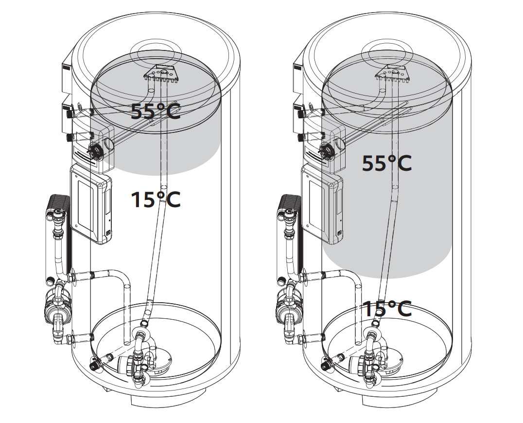

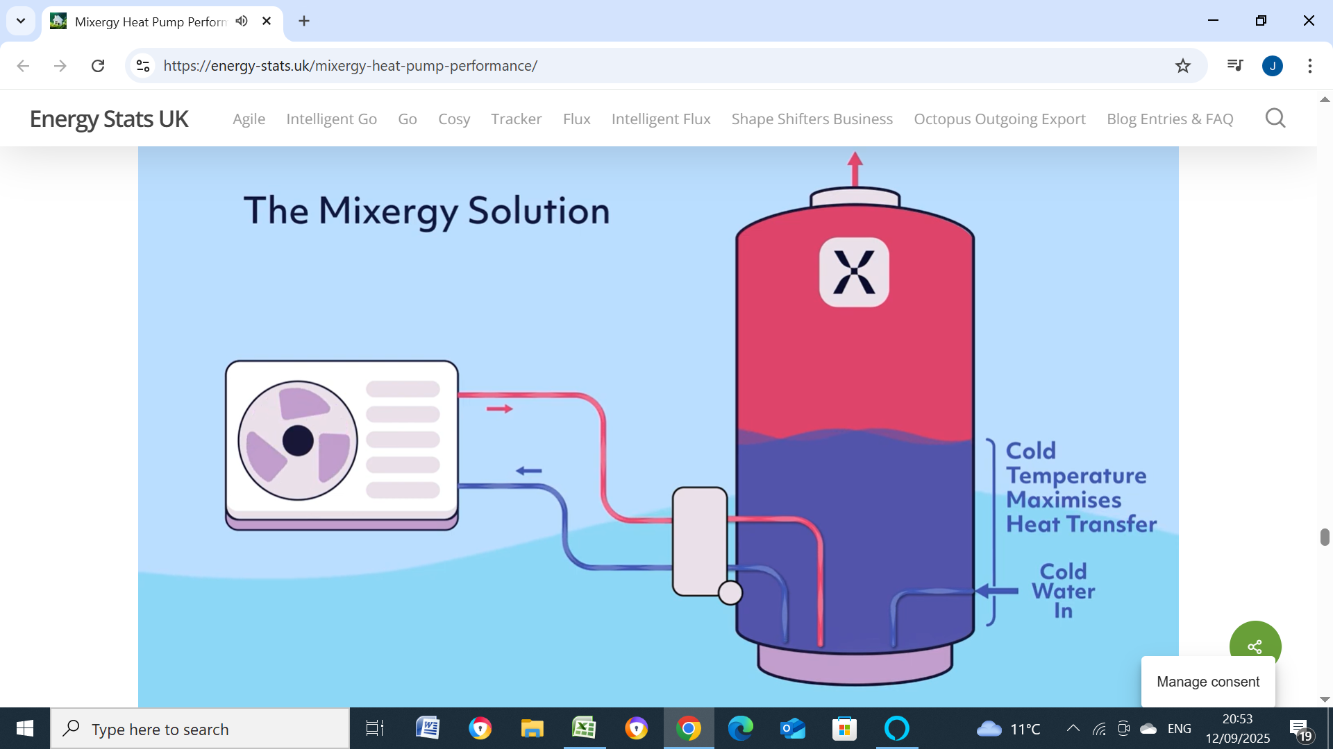

The Mixergy one isn't injecting a 1/4 of the way up, it may enter cylinder a 1/4 of the way but the pipe then drops to the bottom of the cylinder - it deliberately at the bottom, it takes water from bottom puts it back there warmed up.
Mixergy don't use a PHE setup for boilers, PHE is designed specifically for heat pumps, to give best CoP.
Posted
So how does the Mixergy manage to get HW at the top?, it shows a pipe rising up through the cylinder, if it just deposited the water into the bottom again then the cylinder should just heat up uniformly, the same as a botom mounted short coil,

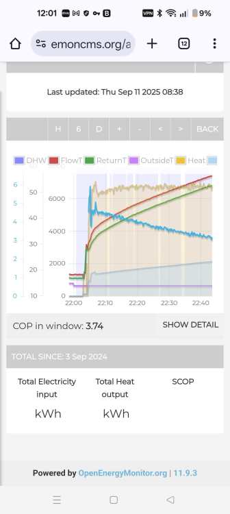

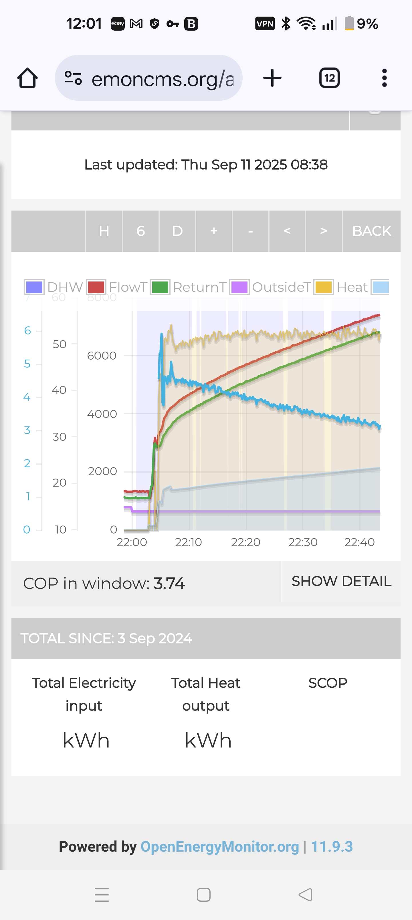

Not sure you would get those conditions with a heat pump as the it runs a low dT typically 3 to 6 doing DHW. A heat pump will slowly ramp up temp to maintain a set dT. This way the CoP stays high. The heat pump will generally keep the same flow rate through out the DHW reheat.
A typical DHW heating cycle. The CoP is the falling blue line. The grey shaded area is the input electric which increases as CoP falls.
So secondary side flow rate would remain at a fixed rate. The difference in approach temperature would drive the primary temperature rise as it maintains dT by adding to flow temp

Can someone, maybe @JohnMo, explain how this actually works?. It shows the hot outlet discharging adjacent to the "cold" inlet where one would think that the cold would actually be quite warm because of its close proximity to the hot, also how does the hot rise up (if it does) through the cold without heating it, one would think that the cold "1/2" would rise uniformly in temperature, then when it reaches the same temp as the upper 1/2, that the whole cylinder should then rise further in temperature unless its setpoint has been reached.
Posted
First thing to remember is this setup is heat pump specific. So is basically playing with the coldest water for as long as possible. As long as the water goes back into the cylinder without too much churn the cold should stay at the bottom. So say the bottom of cylinder is at room temp (20 Deg), the heat pump would start flowing at approx 25 (dT5) then slowly ramp up temp as the return temp increases. So slowly heat over 40 mins + until bottom of cylinder gets to same temp as above the thermocline. If this isn't hot enough, it will just continue heating from the bottom - similar to a bottom immersion.
Posted
Yes, I can obviously see that the hot cannot be returned into the cylinder top because of the ~ 5C dT (ASHP) it would only destratify and cool down the cylinder but thought it might have been returned higher up to give cold inlet water longer, a ASHP producing say 7kW at a dT of 5C means a secondary circ flowrate of 20LPM, so  if the hot is returned say 50L UP from the cold, the 50L will stll be heated by 5C in only 2.5minutes (theoretically) so probably no advantage in doing so and MIxergy have no doubt tested various configurations, makes more sense, at last!.
