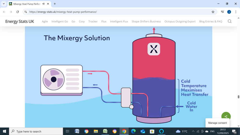

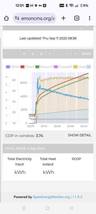

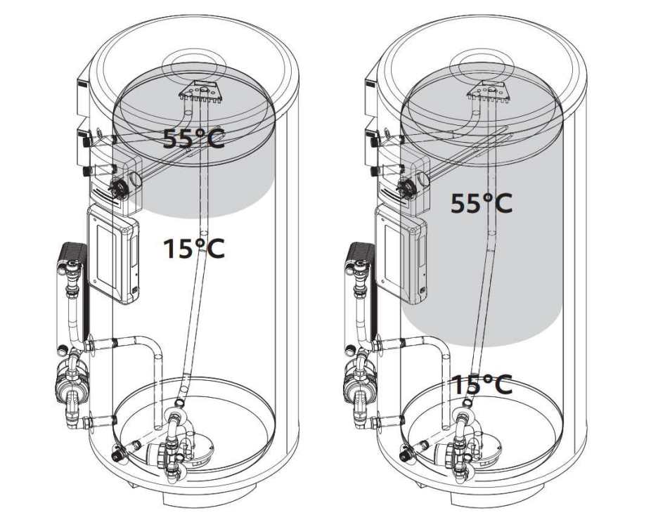

September 8, 20251 yr Discussion on plate loaded cylinder here https://community.openenergymonitor.org/t/anyone-else-with-a-monitored-heat-pump-and-a-mixergy-cylinder/23825/69?page=2 It shows a mixergy cylinder layout, it draws cold water from bottom of cylinder and deposits hot back at bottom of cylinder also. So I assume the hot water at top cylinder isn't disturbed.
September 8, 20251 yr Author 13 hours ago, sharpener said: I don't think you can do that bc of the parasitic path from cold inlet to hot outlet when the pump is not running. If you do it the other way then the NRV will stop that. Or use a 2-port valve not an NRV. Worth looking to see what Mixergy do. I think/hope that there's more resistance through the PHE route than through the cylinder so most HW draw off will be through the cylinder. Via the PHE there's 2 x 22mm Tees, the pump and the PHE but via the cylinder there's nothing but the cylinder itself. I'll leave some space for a 2 port valve just in case things don't work out. I looked at the Mixergy set up and as JohnMo says cooler water is drawn from the bottom and returned around a quarter of the way up. Would be nice to replicate that setup but I'm a bit wary of cutting a new hole in the existing cylinder and then feeding a new tank connector through the immersion boss and getting it into place and secured. Anyone successfully done that??

September 8, 20251 yr 4 hours ago, Dillsue said: I think/hope that there's more resistance through the PHE route than through the cylinder so most HW draw off will be through the cylinder. Via the PHE there's 2 x 22mm Tees, the pump and the PHE but via the cylinder there's nothing but the cylinder itself. I'll leave some space for a 2 port valve just in case things don't work out. You may be right. You might though want to restrict the flow through the HX so it slowly pushes the thermocline down rather than mixing the entire tank when the pump starts, that way the inlet to the HX will get cold water for as long as poss. You could achieve this with either a flow setter (expensive for what they are) or a simple gate valve. This would also reduce possible flow through the path you don't want when the pump is off, but any flow at all will dilute the hot water supply with a proportion of cold. Like you I would not want to try adding an extra connection to an existing tank! I have tried various heroic repairs and mods in the past, not all of which have worked.
September 8, 20251 yr Here are some proper layouts and flow diagrams - they feed into the secondary return port not the DHW out port. http://heatweb.com/literature/Amazon_HXIN.pdf Edited September 8, 20251 yr by JohnMo
