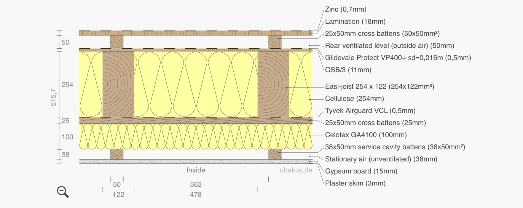

Our roof build-up is a bit complicated but below 254mm easi-joists which are filled with blown cellulose, we have:
  • Tyvek VCL
  • 25x50mm cross battens, which were required to stop the VCL from blowing off the easi-joists when the cellulose was blown in
  • 100mm PIR
  • 38x50mm vertical service cavity battens
  • 15mm PB and skim
Here's a picture (albeit the easi-joists are shown as solid joists due to the limitations of my ubakus skills).
The plan is to fix the PIR on lightly with half a dozen 120mm screws and washers, then pin it properly in place with the service cavity battens using 200mm screws through the cavity battens, the PIR and (ideally) the cross-battens, then into the bottom web of the easi-joists, by 37mm min.
Ideally, the 200mm screws will hit the 25mm cross battens on their way but it's likely that some may miss the cross battens but of course they will still penetrate the easi-joist bottom web.
If you can visualise all that, my question is: will the PIR deform if the screws are crossing a void rather than going through those 25mm cross battens?  (Bearing in mind the force of the screws will be spread on the underside by the 38mm vertical service cavity battens.)
If you can make sense of that and have a view, all responses would be appreciated.
The cross battens will be visible, and after placing the 100mm PIR you'd just run a marker to show where to put each fixing. I think this is an overcomplicated question for a simple install, and will become apparent how simple this is once these start going on. Basically, AFAIC, they can't miss?

Why not fit 25mm insulation between the cross battens?
Avoids any deformation and improves the insulation level.

Thanks Nick, take you point about micromanagement, if the chippies were putting this in I'd have absolutety no worries but its the insualtion team from Cornwall and tbh they don't inspire 100% confidence.   At one point they were suggesting pre-drilling the service cavity battens at 600mm centres to speed things up - but the cross battens are at 400mm centres 😬
I guess I was just wondering how much of an issue it would be if they did miss the cross battens.  (Obvisoutl they are not going to miss the 122mm wide rafters else the screws won't bite.)
Three reasons:
  1. It's more work.
  2. The cross battens are probably 22-24mm in reality (I'd need to measure).
  3. In places the cellulose has blown pushed the membrane away from the rafters a bit (5-10mm max) between the cross-battens - the must pump it in with some force!
Another alternative would be to put short sections of 25mm batten vertically below each rafter (where the cellulose hasn't pushed it away from the rafter) but again it's a lot of extra work.

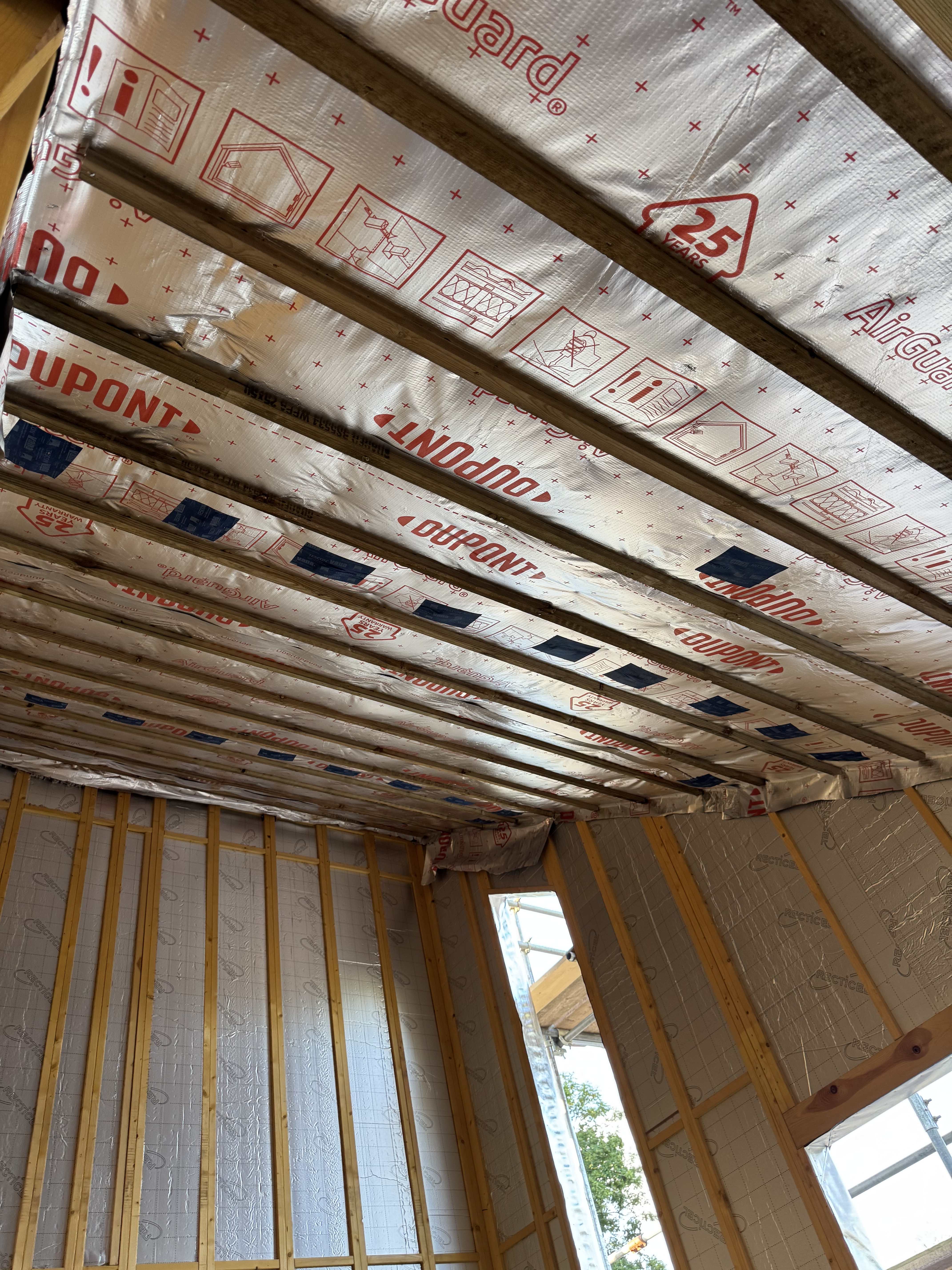

A pictura of the membrane and the cross-battens so you can see the current set-up:
Like Nick said I think you’re over complicating things just put a board up and chalk line where the cross battens are and you can’t miss! (Unless they’re screwing at a strange angle)
