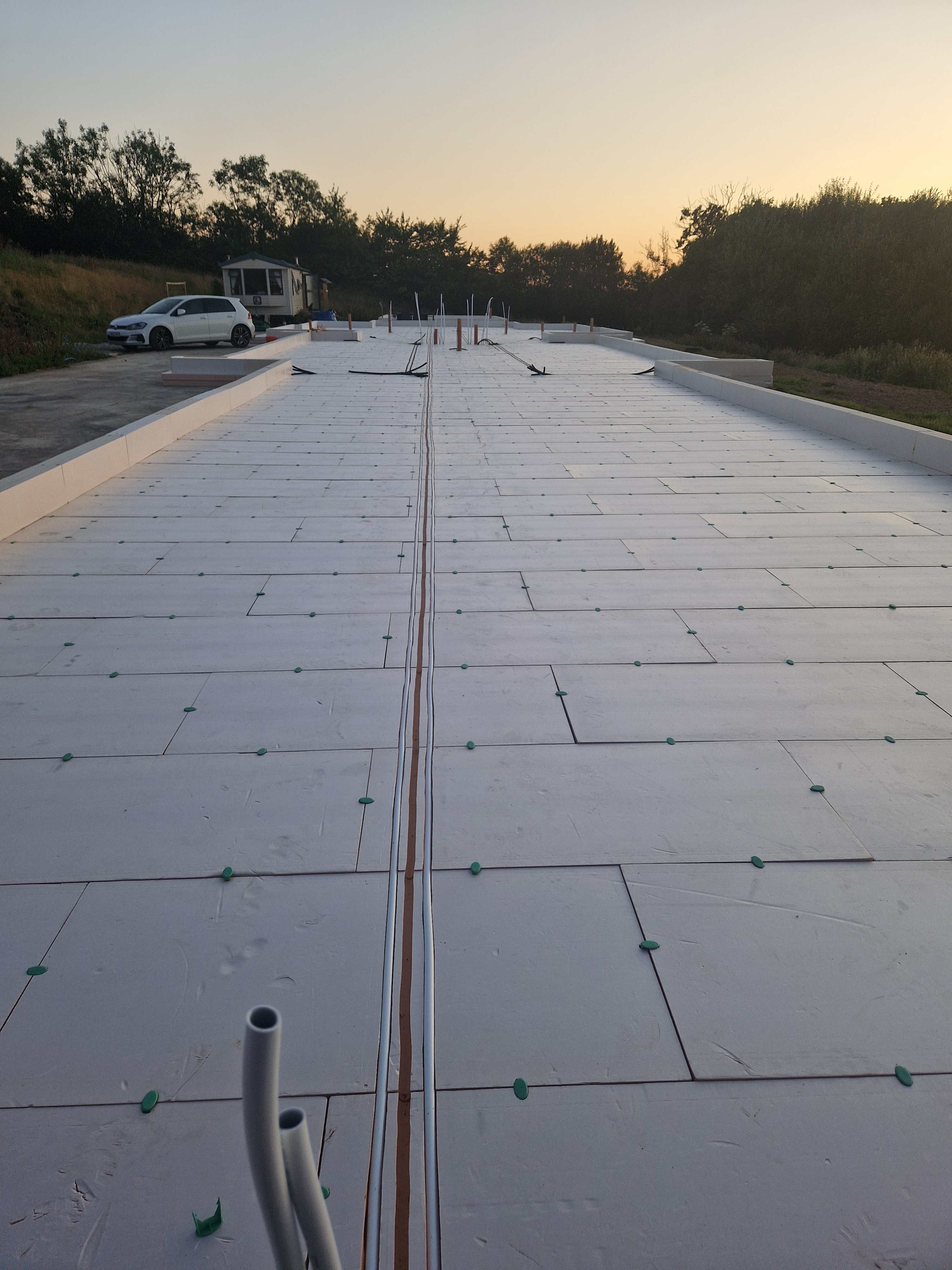

Its Sopera XPS. Interesting stuff to work with.
I've bought a hot knife gun and have routed all the first fix pipe and conduit into the top of the insulation.

Have you capped the ends of all the pipes and ducts?
Not yet, but it's a good shout.
Don't want a bit of rogue concrete blocking a water pipe and giving issues later....

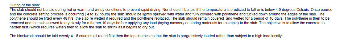

For all when I design raft slabs for the self build market I add some notes on my drawings like this: The last bit of paragraph one explains why I'm asking the builder to do what I want and the reason for doing it. If you don't let the concrete harden then it won't bond to the rebar properly. Let the concrete harden, then dry it out so the shrinkage loads are transfered to the rebar.

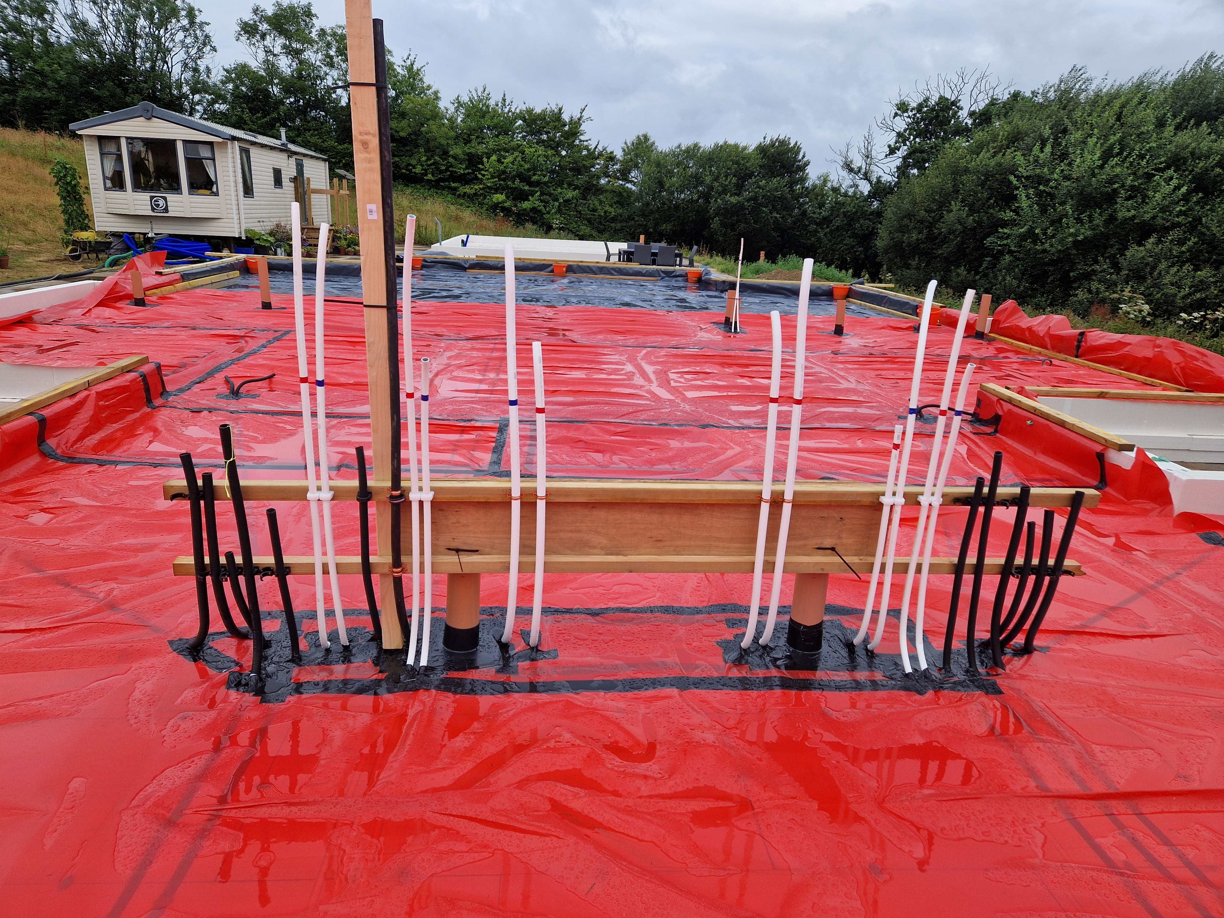

11 hours ago, Nickfromwales said:
Where are they installed?
Here. Left pipe is the hot return (from the local ensuite hot manifold) middle is the hot feed (now run in) and right is cold feed. All 20mm Pex-al-pex.
This ensures hot circulation at the main manifold (center of the house) and therefore short runs from there to each en-suite manifold.
