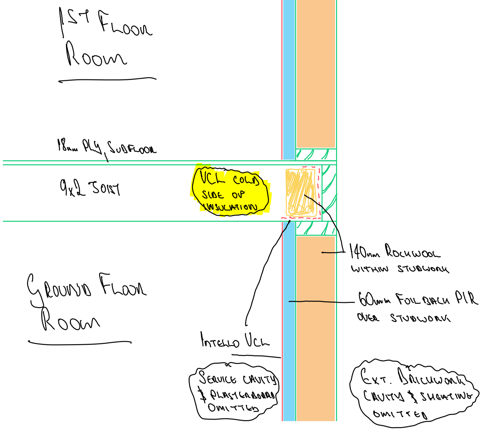

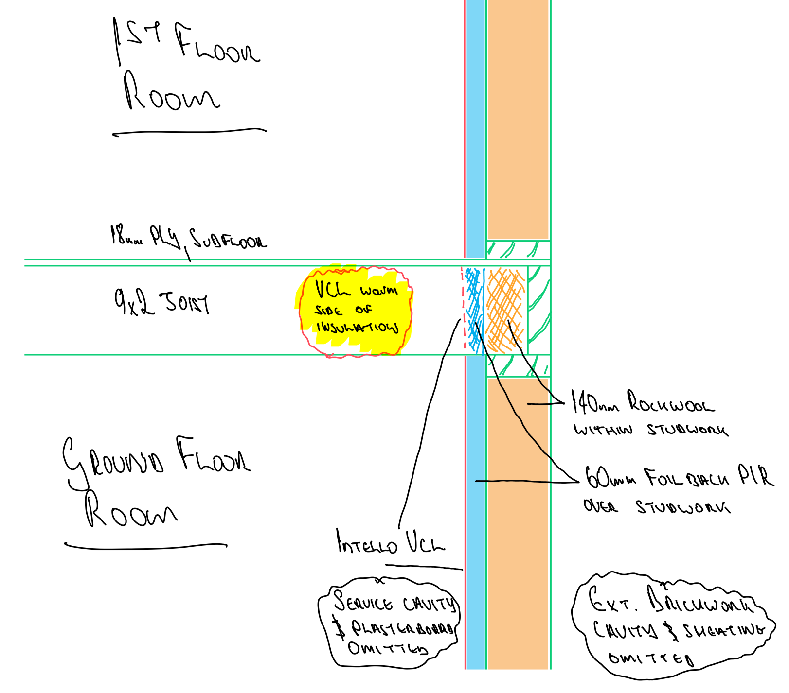

Annker Posted September 9, 2025 Author Posted September 9, 2025 I'm still trying to figure out the best option to resolve the problem of the missed VCL installation at joist level. My issue is struggling to understand the princple of where the VCL should be in the assemblage, therefore I'd appreciate any comment on the two sketched sections below. My understanding is that ideally the entire joist would be internal side of the VCL. That cannot now be achieved here, however, as per below I could continue the VCL up the wall, cut in-between the joists, taped back to the rim joist and around the perimeter of each individual joist pocket perimeter, then fit insulation within the joist pocket. In this arrangement the VCL is cold side of the insulation layer. An alternative sketched below is where the 60mm PIR board (installed over the studwork) is cut around the joists and continued to the underside of the plywood subfloor, then similarly the VCL is continued to the underside of the plywood subfloor and taped accordingly around the joists. In this arrangement the VCL is warm side of the insulation layer. The first arrangement seems to closely mirror other details I have seen online, however does it not pose a condensation risk, where internal born warm moist air may condensate on the VCL behind the insulation? The second arrangement seems a safer in terms of at least limiting the amount of internally born warm moist from entering the insulation layer, and what does get through can still dry into the cavity. However I have not seen any similar detail online. So thats my hurdle in a nutshell, any comments are greatly appreicated!
Iceverge Posted September 9, 2025 Posted September 9, 2025 Airtight layer placement isn't as important as making sure it's continuous. It's drafts that carry vapor laden air, not diffusion etc. I would just do what's easier to install at this stage. Probably something like FM330 foam to fill any big gaps in every "box" at the end of the joists and then some airtight paint over the top. Airtight tape is also an option. The important thing is that is joins the layer above and below the ceiling. I'm slow to rely on the foam long term for airtightnss as it shrinks.
Annker Posted September 9, 2025 Author Posted September 9, 2025 @Iceverge Once again thanks for your response. I like airtight paint, I had its inclusion in mind for the first option above and I think it would be the best option to confidently seal all gaps. The joints in the timberwork are all tight (my own work) so FM330 would not even be necessary to fill any gaps. "The important thing is that is joins the layer above and below the ceiling." If I understand you correctly, joining those two layer together will not be possible as the plywood subfloor runs continuously between the lower and upper stud wall, thus physically separating the VCL above and below the ceiling. I can ensure that the separate VCL below and above the ceiling are fully sealed & bonded to the respective underside/topside of that plywood subfloor but short of cutting a track through the plywood they wont be physically connected to one another.
Iceverge Posted September 9, 2025 Posted September 9, 2025 6 minutes ago, Annker said: I can ensure that the separate VCL below and above the ceiling are fully sealed & bonded to the respective underside/topside of that plywood subfloor. This will work perfectly. Controlling vapour is largely nonsense. The aim is to control the flow of air and in doing so not create any vapour traps. 1
Annker Posted September 9, 2025 Author Posted September 9, 2025 2 minutes ago, Iceverge said: This will work perfectly. Controlling vapour is largely nonsense. The aim is to control the flow of air and in doing so not create any vapour traps. Great thanks for clarifying. I'll update the post with photos in due course for anyone following with a similar issue, 1
