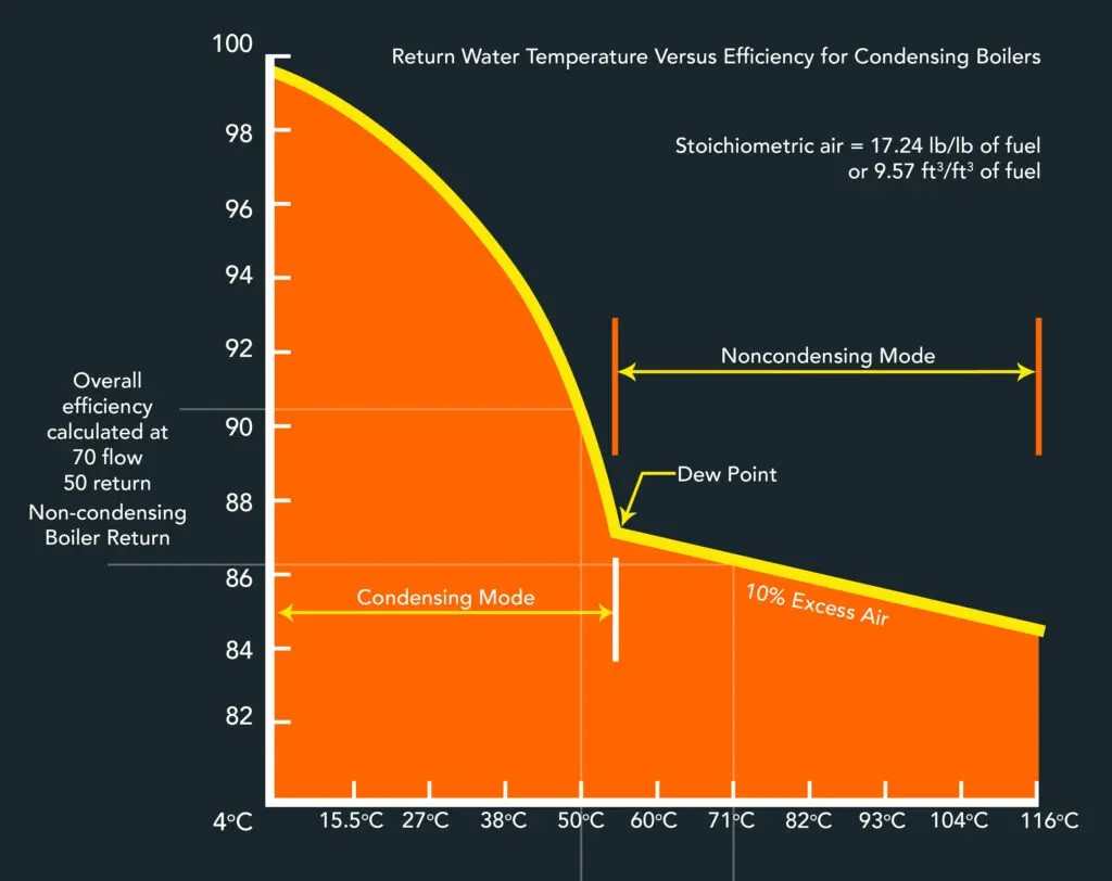

Is a normal way plumbers install boilers with hot water cylinder and it's the least efficient, so everything is run at a set flow temperature. They use either two normal closed valve or a mid point valve.
Priority domestic hot water, uses a diverter valve and runs a higher temperature with DHW and with a decent boiler can then run weather compensation for the UFH without mixing valve.
Effect of flow temp on efficiency

Sounds like you are making it up as you go. Get a free trial of Loopcad and design it so each room is balanced correctly before you start.
Sorry 100mm centres and 17mm pipe and then running your boiler at 50+, to then mix the flow temperature down to supply UFH makes zero sense.

Pretty much don't agree, constructive comments about balanced design via Loopcad, you never explained you had it. 17mm pipe is just a waste of money 16mm is more than adequate.
Running at low temperature from boiler, gains quite a bit of efficiency and therefore is cheaper to run. Being able to run without mixers saves a fair amount from costs to purchase and additional pump cost extra to run.
to expand on ^
if your boiler can run low flow temps for CH and flip to higher temps for HW (ie with Weather Compensation and DHWP) then running at fixed flow temps with mixers and additional pumps for UFH make no sense
my max flow temp for CH at -2.5 outside is 34 deg C (weather compensated system) return temp is in mid to high 20’s so condensing all the time with a boiler efficiency of 97.5 % (validated because I found out how to calculate it)
my max HW reheat temp is 80 deg C - efficiency is probably not much more than 86 % - I don’t care because I run the CH 24/7 on low flow temps at max eff and only heat HW tank for 20 - 30 mins a day. So the efficiency gains on CH cover off the poor eff on HW
