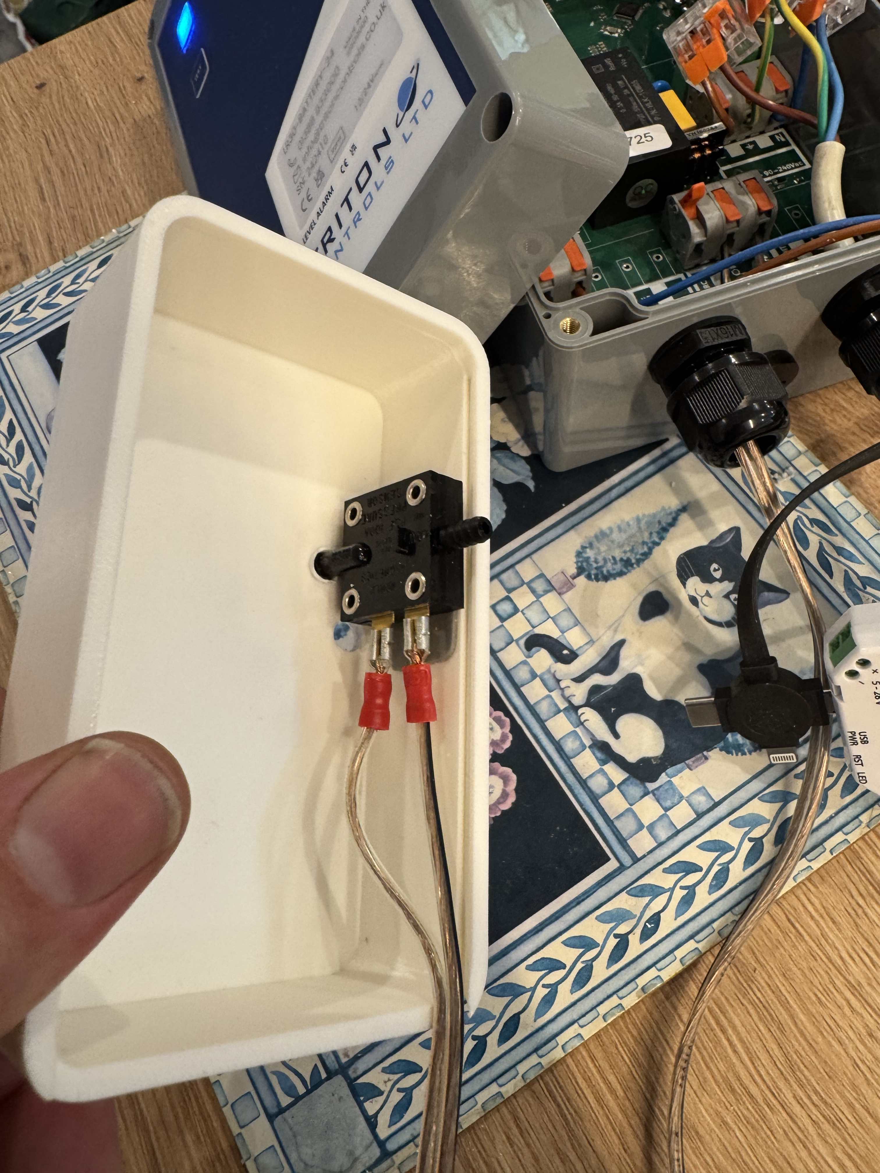

Pocster Posted July 15 Author Posted July 15 Great website ! https://www.silicon-ark.co.uk I found https://www.silicon-ark.co.uk/PSF100A-0-5-Pressure-switch-by-multicomp?search=Pressure

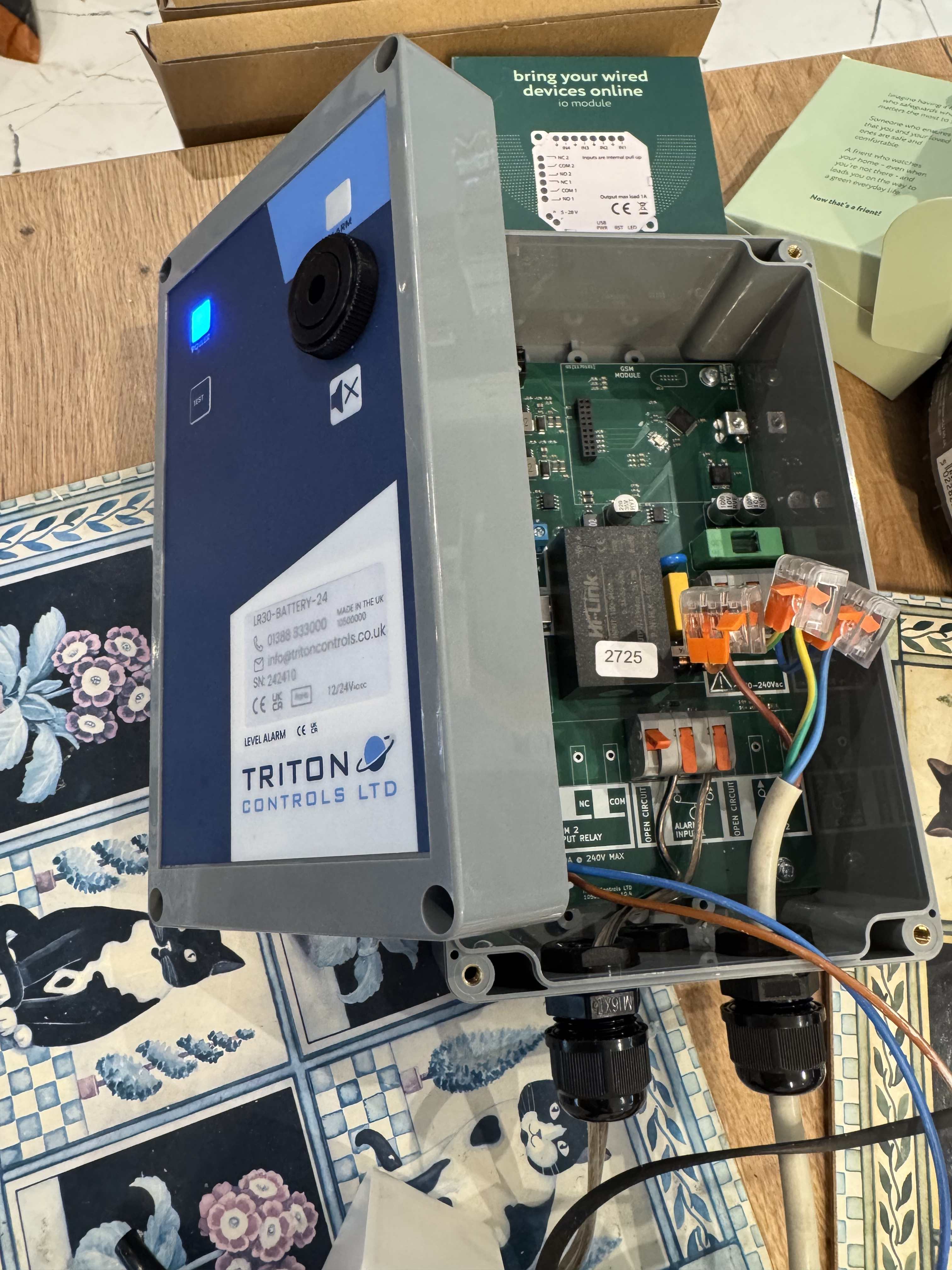

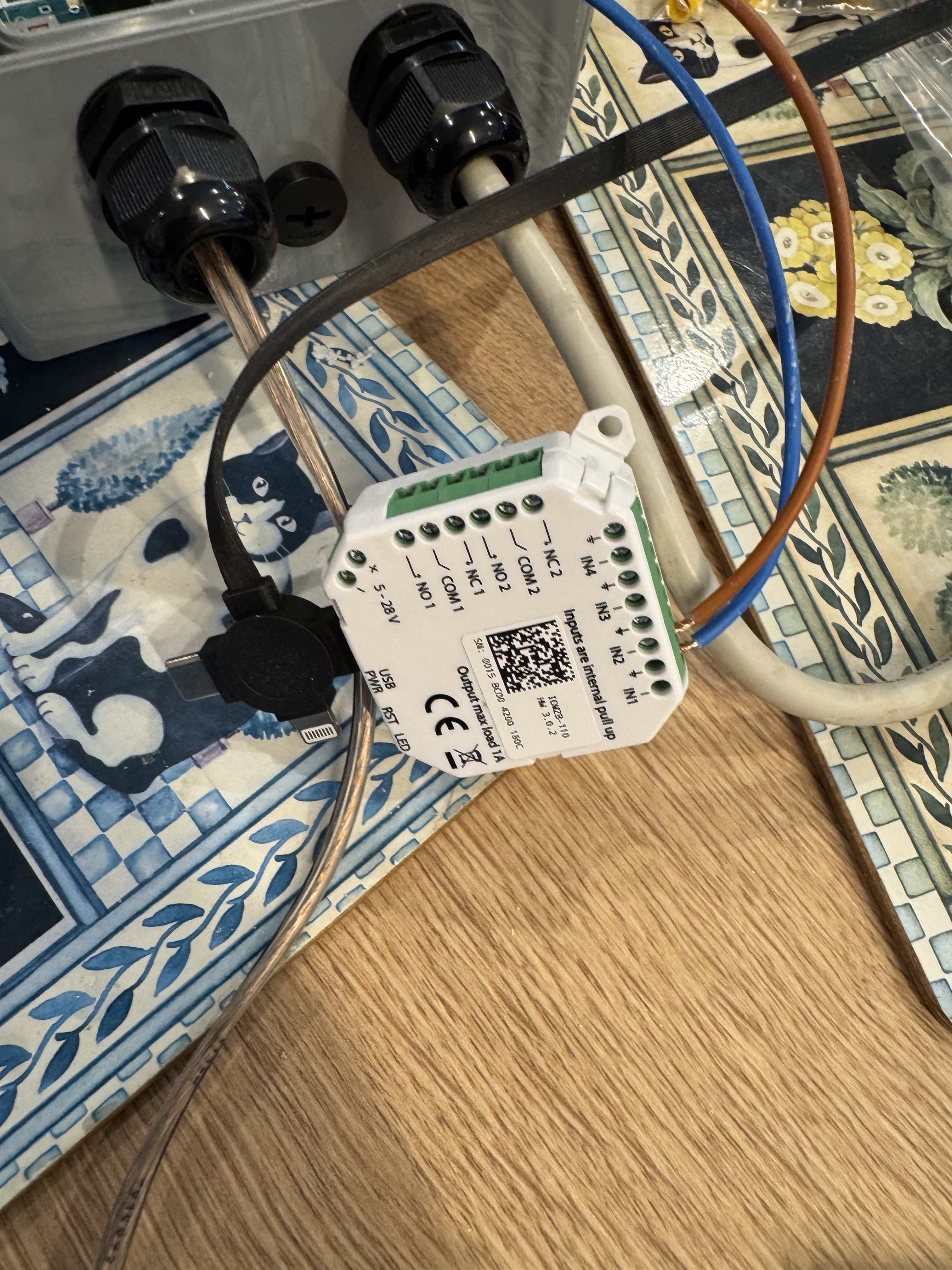

Pocster Posted July 24 Author Posted July 24 Got the alarm type box - seems good . Tested with the pressure switch - think it will work . I soldered to the pressure switch and busted it 🙄 ; getting a new one and will crimp . Assume heat melted the diaphragm maybe ? Opened up the zigbee relay - no chance of soldering anything as microscopic. So will get a mains powered zigbee relay with dry contact support .
Pocster Posted August 2 Author Posted August 2 Success ! The alarm box presumably to save power will only audible alarm for 10 seconds . But with the zigbee dry contact input I get HA to get voice assistant to repeat 10 times to annoy and a notification to my phone .

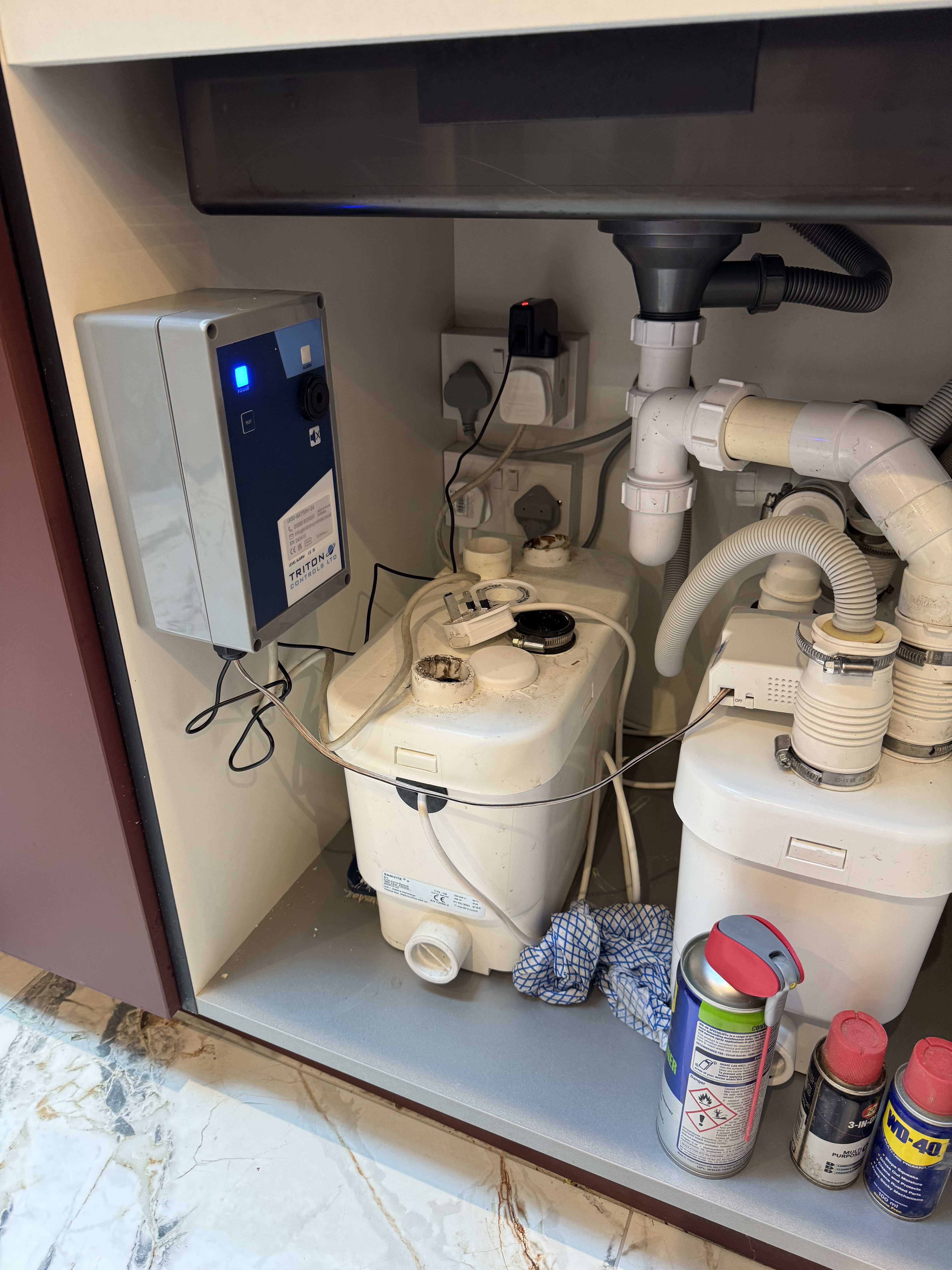

Pocster Posted August 2 Author Posted August 2 It seems to work ( in test mode ) pretty good . So as a final test ; put it under the sink . Turn off pump and let tap run ( I preliminary tried this before and it worked ) . So not expecting any issues . (expletive deleted) you Saniflo for your bullshit crap alarm junk
Pocster Posted August 3 Author Posted August 3 Ok ! Almost works in situ The pressure switch is WAY too sensitive. I tried during the tube length it sits in etc - but it triggers when the pump is in normal use . Ordered a less sensitive version
Pocster Posted August 7 Author Posted August 7 What a rabbit hole I went down ! Purchasing various pressure sensor switches and sending them back . Too sensitive / not sensitive enough etc . In the end butchered the saniflo dry contact switch - answer was staring me in the face 🤣. Added some tube to vary the sensitivity and it seems good . Triton alarm loud enough ( but automatically seems to stop when it wants on the audio ) . But triggers HA aswell ; gets voice to talk and a notification to my phone . So that’s a win ! 👍

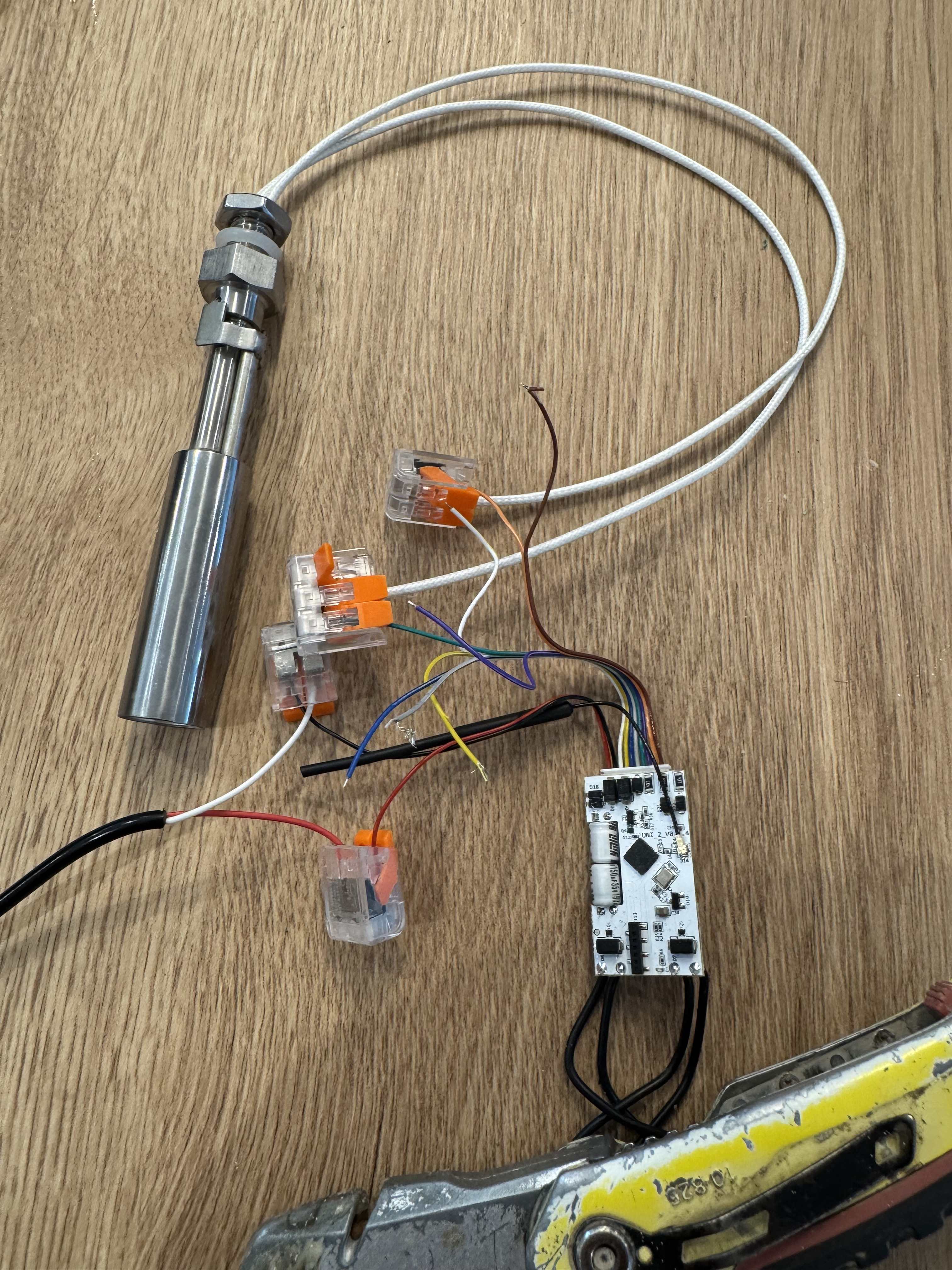

Pocster Posted August 12 Author Posted August 12 (edited) Inspired by my success I want a similar system but for when the outdoor rainwater pump fails and also the not in use yet sewage pump ( for swmbo’s tiny underground wc ). So 1 control box ( as before ) but 2 float / lever devices trigger the alarm but also HA though using WiFi as no zigbee outdoors . The very fiddly Shelly uni does the trick . But those (expletive deleted)ing hair thick wires…. oh yeah - needed 2 dry contact inputs - which seems to be a big ask Edited August 12 by Pocster My PIN code 5734
