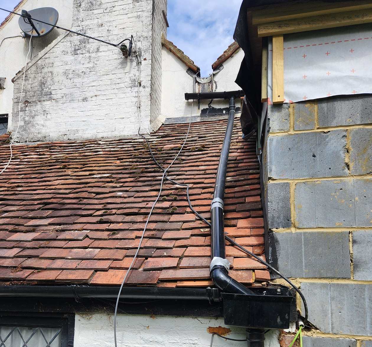

Hi All - As part of my work I was hoping to replace the pvc gutter with some nicer looking galvanised steel. The lean to roof is 38 degrees so a non standard size. I was hoping to find some kind of simple adjustable bend but this doesn't seem to be a thing. My next idea was to step it out slightly and then run it down the wall using a standard angle, however this will not look great as it will be at a different angle to the roof. In all honestly I am probably the only person that will ever see or notice this given that it's kind of hidden away. I thought I should ask if anyone was aware of any options for an adjustable bend. I did speak to someone from a reseller who said there are companies that will make custom ones but this will propbably cost a fortune and I am trying to stop myself doing stuff like that.
The final downpipe will be fixed to the return wall on the extension.

I'd be gluing a 45 deg bend to the down pipe and then firing up a hot air gun and heating the downpipe just after the bend to make it form to the required 38 deg angle - you are never gonna see it from ground level and the water is going to want to flow along the bottom of the down pipe anyway
Alternatively - if you get some solvent weld adhesive and it melts the down pipe fitting you might be able to pie cut a fitting and then solvent weld it??
Can't two 45 bends be joined and rotated to give the required angle with a slight side step.
Or even one 90 deg to the right and then another 90 deg that can set the angle to whatever is required - good plan
it would have to be tight to the wall to stop it being forced apart - depends on how much water is expected?

Thanks all. I'm going to try the joining angles together to make it work.
