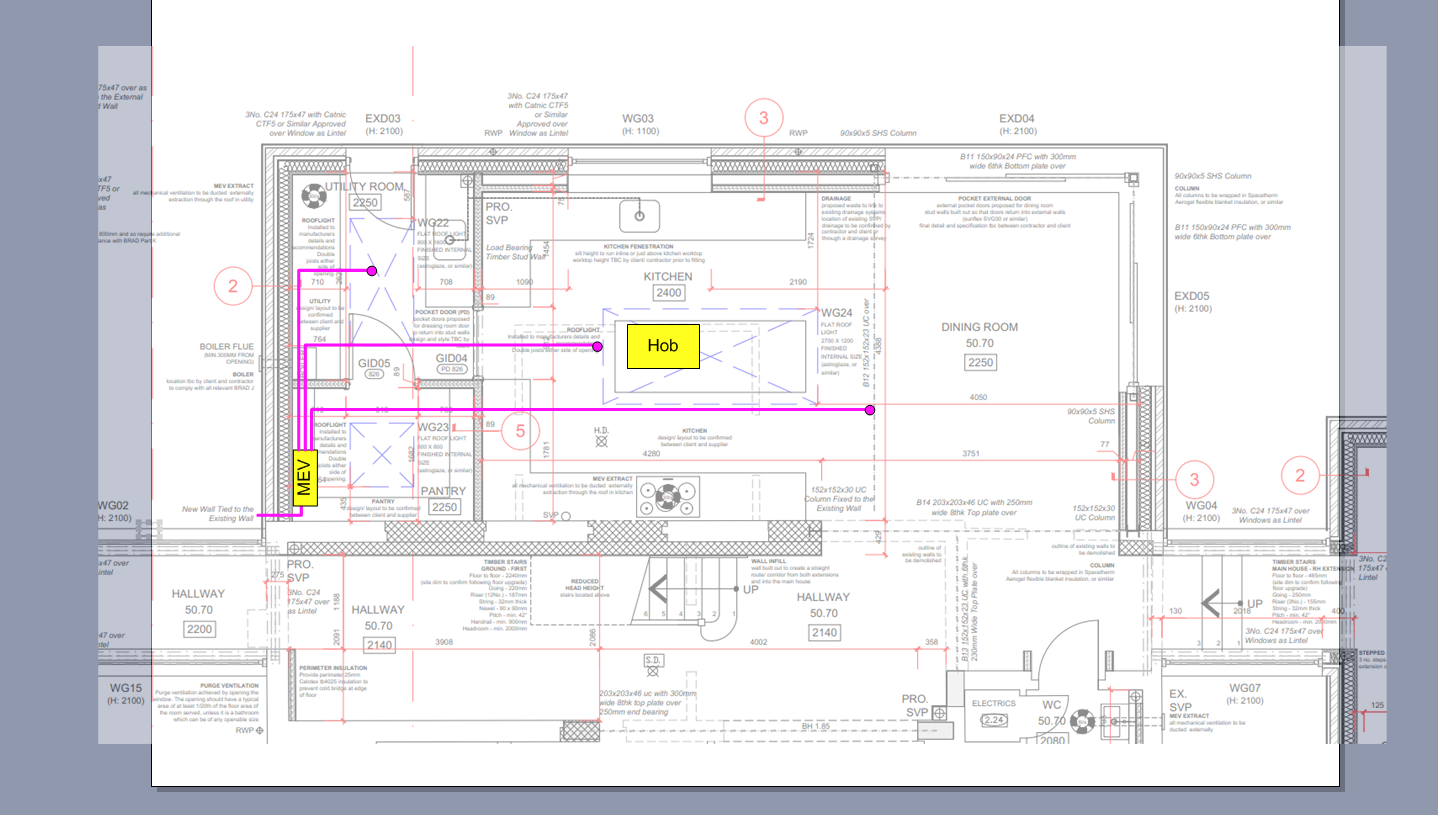

paro Posted July 8, 2025 Posted July 8, 2025 Hi All - I'm trying to figure out how/where to install the flat ducting from an island hob extractor to outside. I can't find anything useful on what is an acceptable way to pull this through the floor. The build up for the floor will be a 80mm PIR with 50-65mm screed + hardwood floor. The flat ducting needs to be 90mm so not sure how best to install. I was originally thinking about going as close to the block and beam as I can but the concern becomes whether the air flow would be stifled by the temperature change it meets when colder. Either way it is going to be in both parts of the substrate just not sure which one gets the lions share and why. If anyone can point to an example someone doing this that would be appreciated. Thanks, Paul

Nickfromwales Posted July 9, 2025 Posted July 9, 2025 9 hours ago, paro said: The build up for the floor will be a 80mm PIR with 50-65mm screed + hardwood floor. The flat ducting needs to be 90mm so not sure how best to install. I was originally thinking about going as close to the block and beam as I can but the concern becomes whether the air flow would be stifled by the temperature change it meets when colder. Either way it is going to be in both parts of the substrate just not sure which one gets the lions share and why. You could stack 2 lots of 225x25, you’d just need to get inventive on the connections to/from, but doable. As far as temp is concerned, flow rates won’t suffer but you will get condensation I expect. That means the ducts need to run downhill to the outside wall so they can drip dry. With 2 lots of 225, you’ll have space for some insulation under the lowest one so that issue would be reduced significantly if avoiding using the full depth of the insulation to fit the duct.

paro Posted July 9, 2025 Author Posted July 9, 2025 1 hour ago, Nickfromwales said: You could stack 2 lots of 225x25, you’d just need to get inventive on the connections to/from, but doable. As far as temp is concerned, flow rates won’t suffer but you will get condensation I expect. That means the ducts need to run downhill to the outside wall so they can drip dry. With 2 lots of 225, you’ll have space for some insulation under the lowest one so that issue would be reduced significantly if avoiding using the full depth of the insulation to fit the duct. Thanks. I like this idea as an option. Need to check my levels for the though with the telescopic air bricks.

Nickfromwales Posted July 10, 2025 Posted July 10, 2025 2 hours ago, paro said: I may just be making more complicated than needed. So just been looking at the environvent 160/300 MEV. The space I'm covering is a kitchen/dinner with a utility and pantry. If I run ducting from MEV to around the hob location as well as the utility room and tie that in with a humidistat voc sensor it should automatically increase the flow when cooking or it smells bad stuff (not sure how accurate and smart these sensors are). I'll call them tomorrow to find out. It's a really old cottage and leaks like a sieve I am not really concerned about being too airtight yet. The extension opens directly into the main cottage as well. Adding so indiscriminately to your extraction setup will make it a very cold house during winter. I'd steer away from mechanical centralised ventilation and just go for fans where you want them, used when you need them, only. Having the above arrangement means you're extracting from the utility regardless if there's any need to or not. Having 1x extractor on at any one time should allow the cold air in > heated air from the whole house out to become diluted enough for the cold air infiltration to be of negligible impact.
