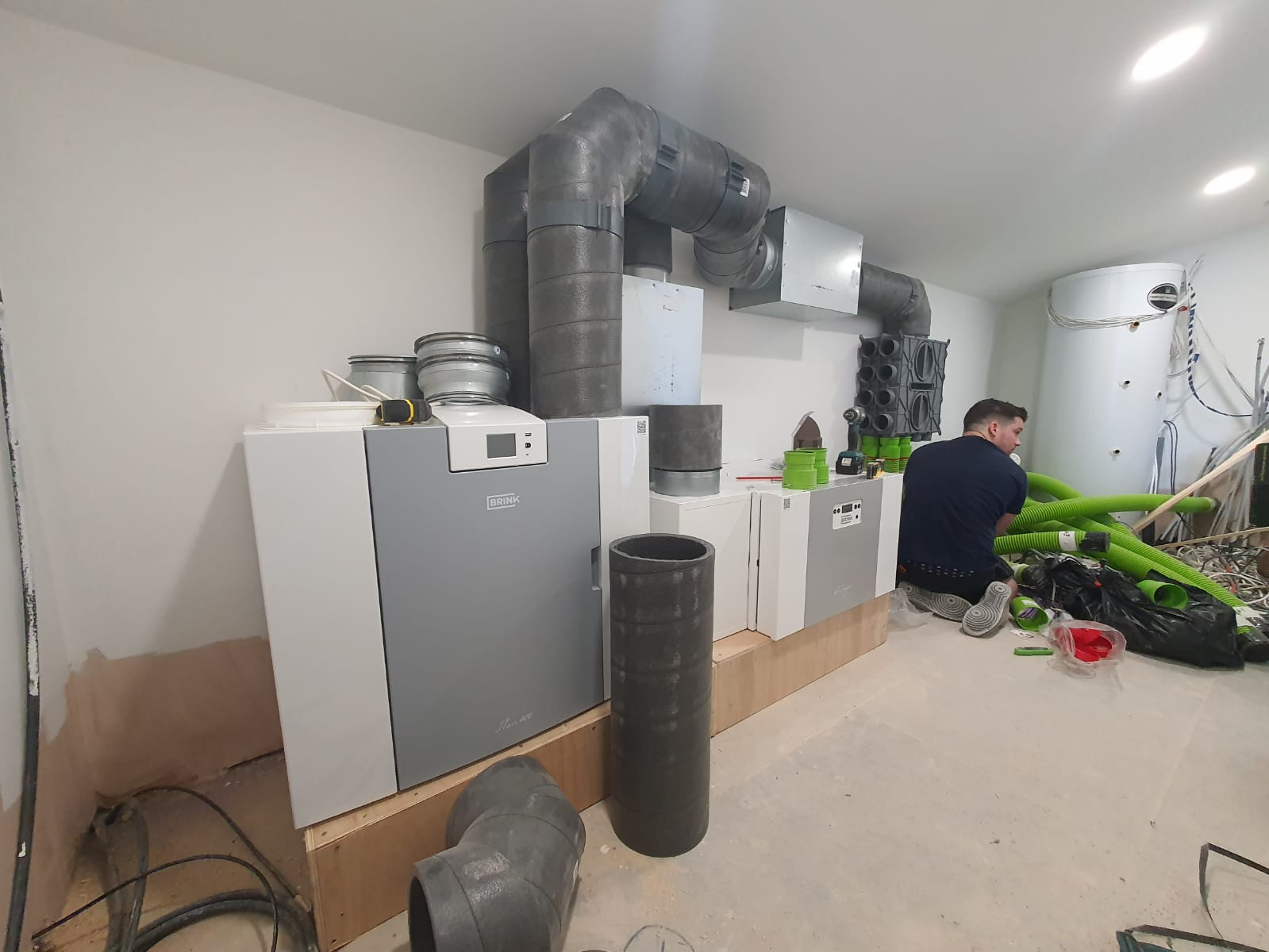

Nickfromwales Posted July 4, 2025 Posted July 4, 2025 Here’s one we installed in Oxford. The unit to the left is the Flair 400, and the air comfort is the unit to the right of it.

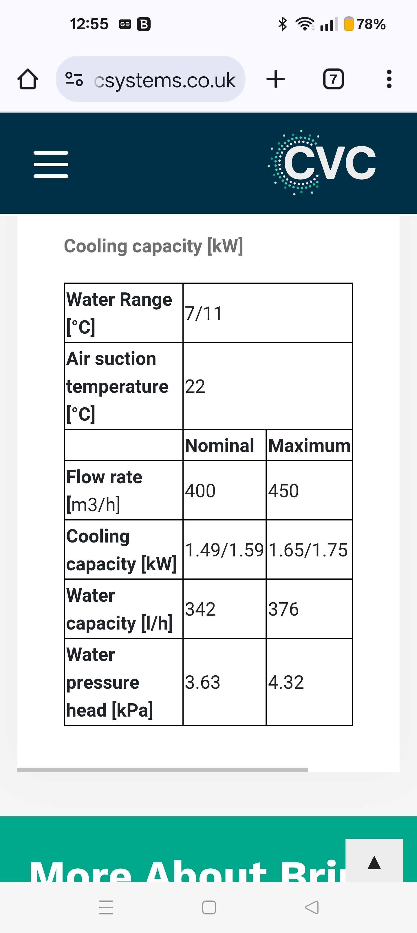

JohnMo Posted July 4, 2025 Posted July 4, 2025 We have exactly the same overheating issue. Prime reason for finding a reasonably price ASHP, and cool via the floor. According to data sheet at a water flow temperature of 7 degs, and 400m³ h you get 1.5kW cooling - pretty much a waste of time in my opinion. Not sure it does evaporation cooling according to reading the data sheet, it needs cooled water. 1
Nickfromwales Posted July 4, 2025 Posted July 4, 2025 1 minute ago, JohnMo said: We have exactly the same overheating issue. Prime reason for finding a reasonably price ASHP, and cool via the floor. According to data sheet at a water flow temperature of 7 degs, and 400m³ h you get 1.5kW cooling - pretty much a waste of time in my opinion. Not sure it dies evaporation cooling according to reading the data sheet, it needs cooled water. Yup. The air comfort is an active heat exchanger, and requires a hydraulic connection to the ASHP for cooled or warmed water input.

JohnMo Posted July 4, 2025 Posted July 4, 2025 46 minutes ago, Adsibob said: Brink Air Comfort unit simply to add moisture to the air How? from reading up on it, it doesn't do it it's a heat exchanger in the air stream. Just AI says yes, doesn't make it real. Download the manual and have a read. If I am wrong I will happily eat my words. I did look at an evaporator unit (different make) for the MVHR you need very dry incoming air for it being if any use. UK humidity made as good as useless. 48 minutes ago, Adsibob said: little confused by the reference to ASHP That's how it works needs cold water through a heat exchanger to cool the air.
