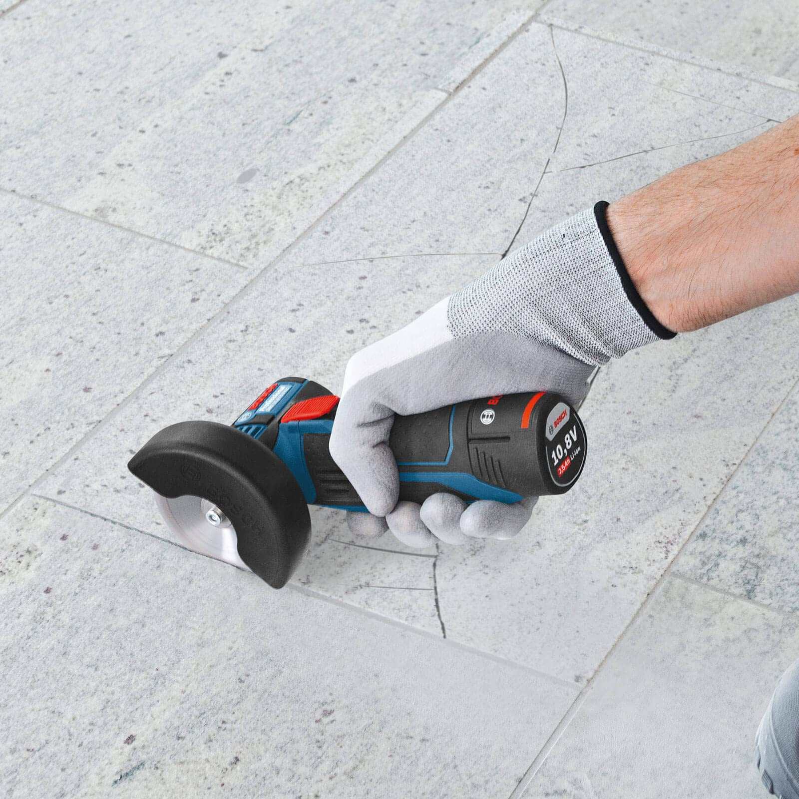

Nick Laslett Posted July 1 Posted July 1 (edited) I did not get on with Electric Hot knife at all. For conduit runs and back boxes I just used the multi-tool. Plunge cut little cubes and pop out with painters tool or other flat edge. If I was in a hurry for a long conduit run, I used the Bosch mini grinder to do the tram lines and then plunge cut with multitool to make the cubes. My electrician just used his chaser tool, with dust extraction. Very neat and quick. Just a reminder that EPS will degrade the PVC jacket on standard electric cabling. LSZH or use conduits. Edited July 1 by Nick Laslett
