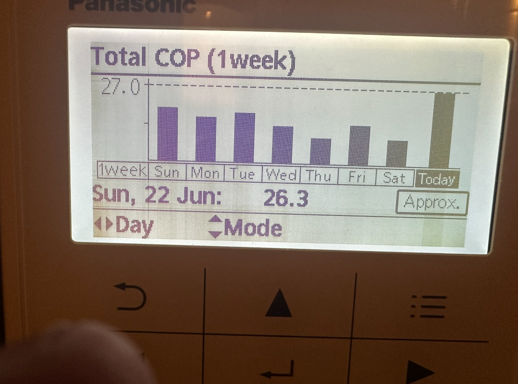

36C outside yesterday. The aquarea purring away at 16c (ramping up/down automatically to keep the right side of the wet bulb). walking into the ground floor is like walking into a fridge even theough its 21, the ufh loop does its work.
The bedrooms though with the panasonic fan coils are sitting at 21 while the bathroom and landing are 26/8.
CoP is reported as 27, although i guess its not setup for cooling ? Free anyway with the mega excess of solar.

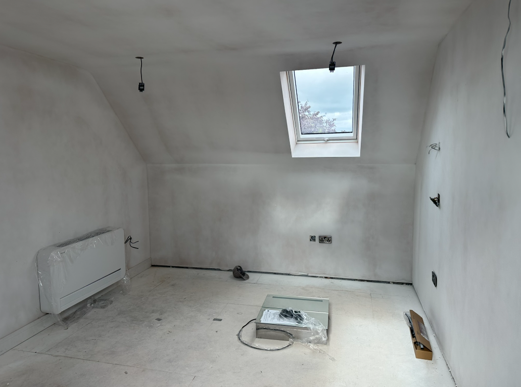

added the new 2025 model into the loft and also included the condensate drain, this is the largest unit they do and the heat exchanger is about 80cm wide so should  be a beast for cooling.
