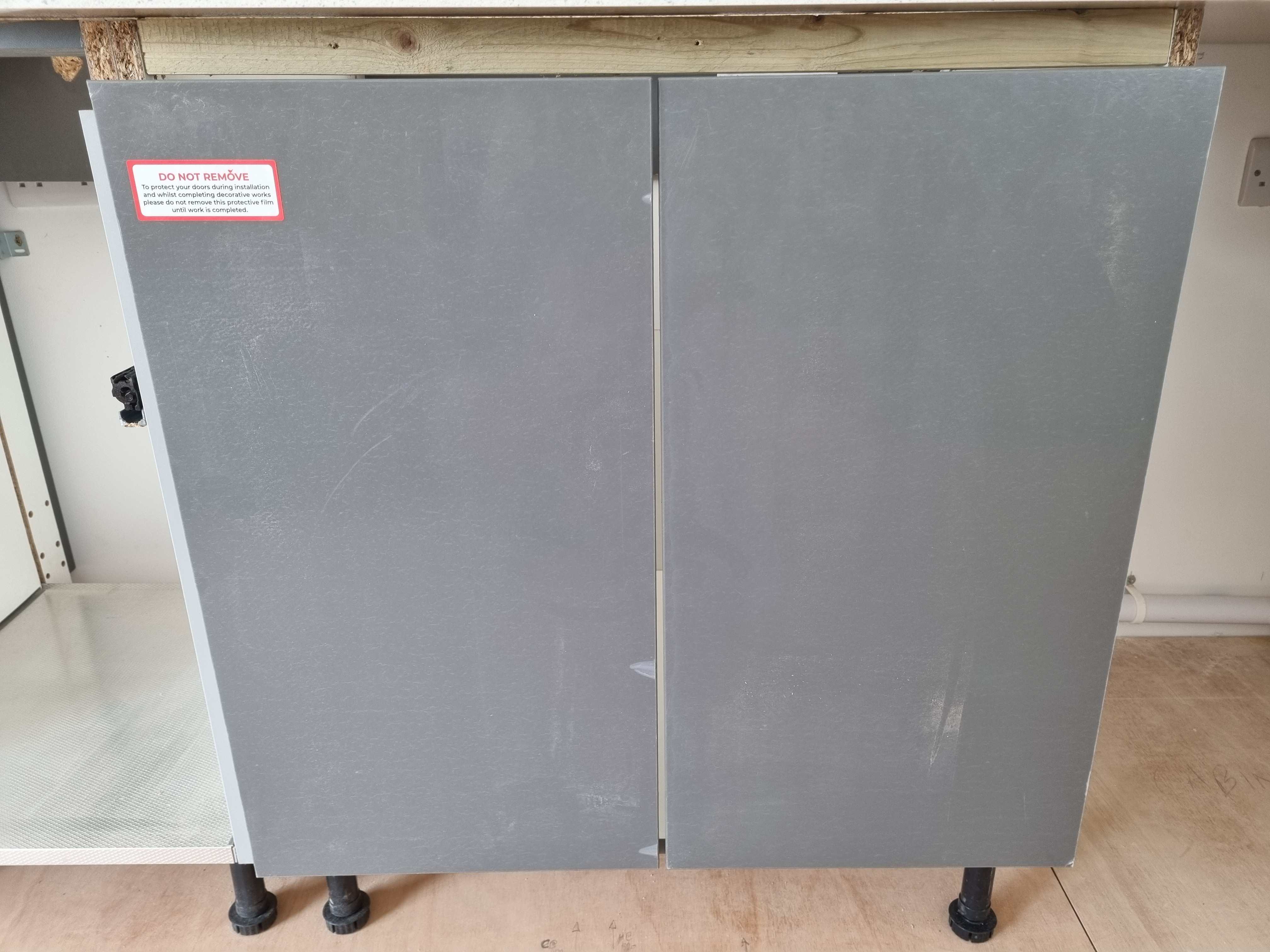

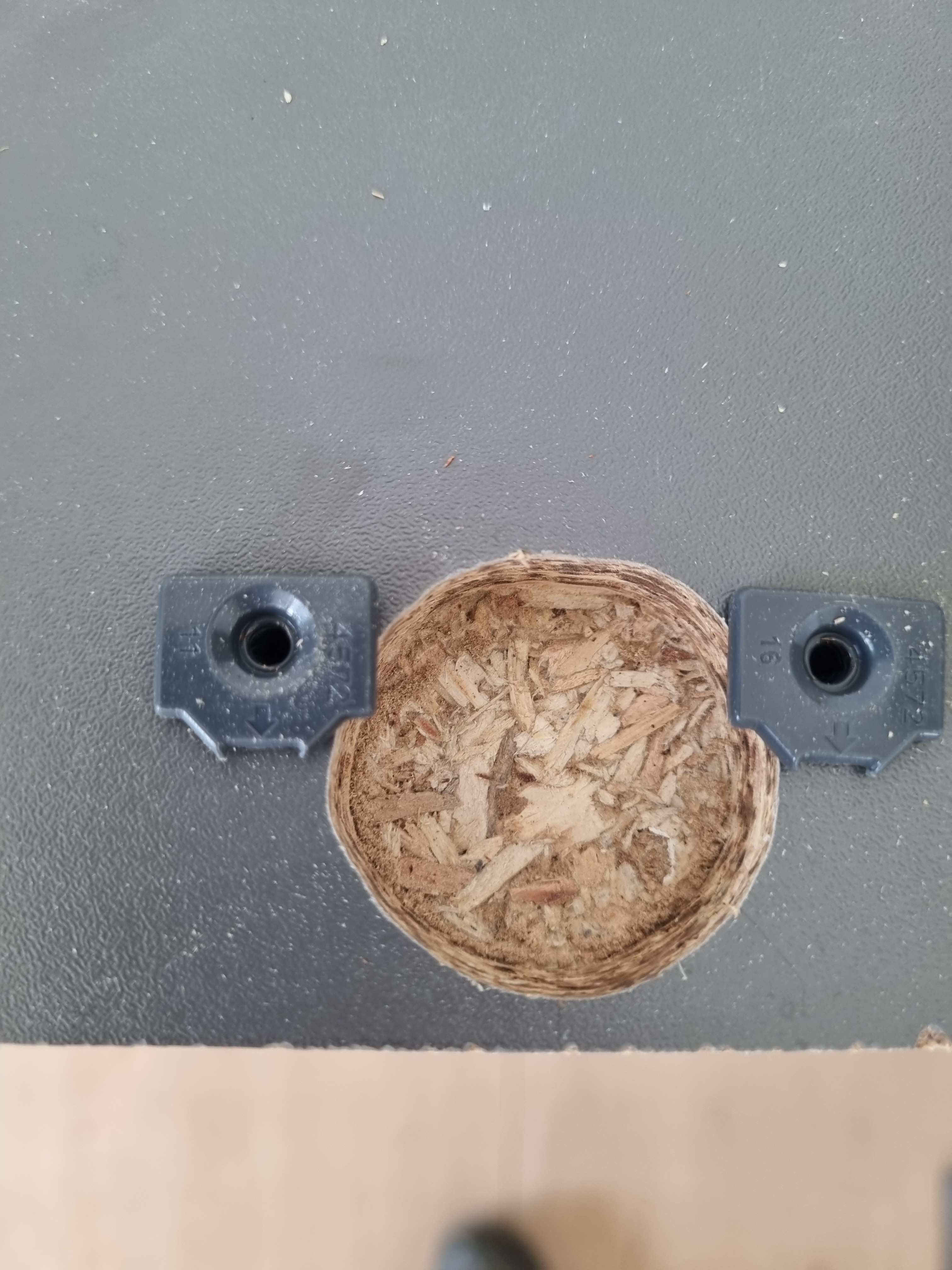

BotusBuild Posted June 26, 2025 Author Posted June 26, 2025 Follow up. Cabinet cut down and fitted, but now of course I have the trouble of the doors, which both need trimming down equally. Note: these doors of course match all the doors in this brand new kitchen. Initial option was to trim the centre edges, were they meet, bit that means apply new edging colour matched. Has anyone tried to remove edging and reapply it? Maybe heat it to melt the glue, then clean it up and glue it on the newly cut edge? Second option is to cut the hinge edges which means cutting those lovely big holes which I don't have a jig for. Bit that still leaves the cut edge without edging 🙃 Damn, I love DIY 😬 Any other options out there?
Super_Paulie Posted June 26, 2025 Posted June 26, 2025 Id deffo try to have the cut edge the one that you dont see when opening the door, so hinge side, how often do you see that edge, almost never. I applied the heat edging before and it worked pretty good to be fair. My new doors are painted so it's stressful cutting the fillers, I just use a track saw with a 40t blade and then touch up paint along the raw edge if needed. 1

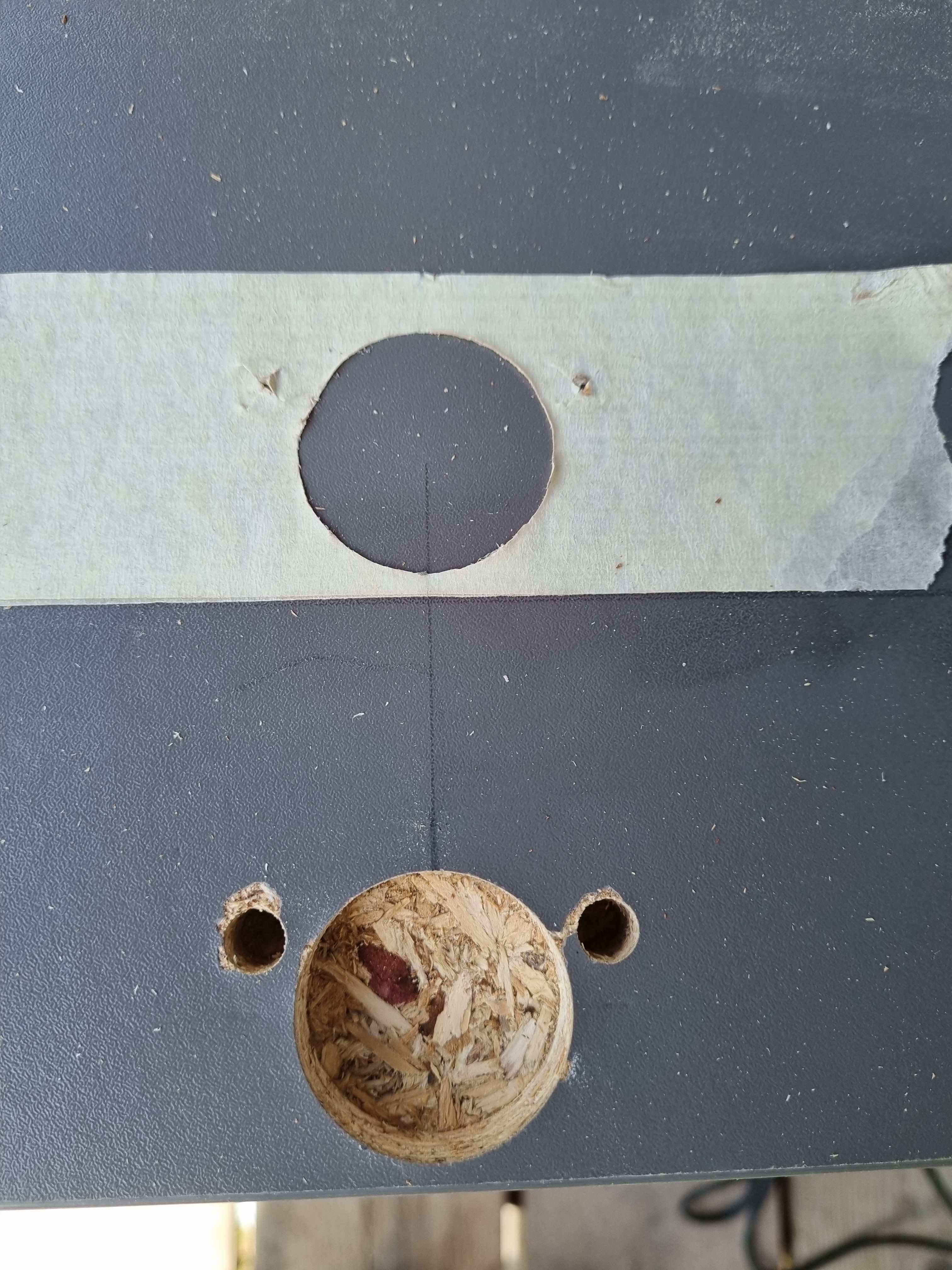

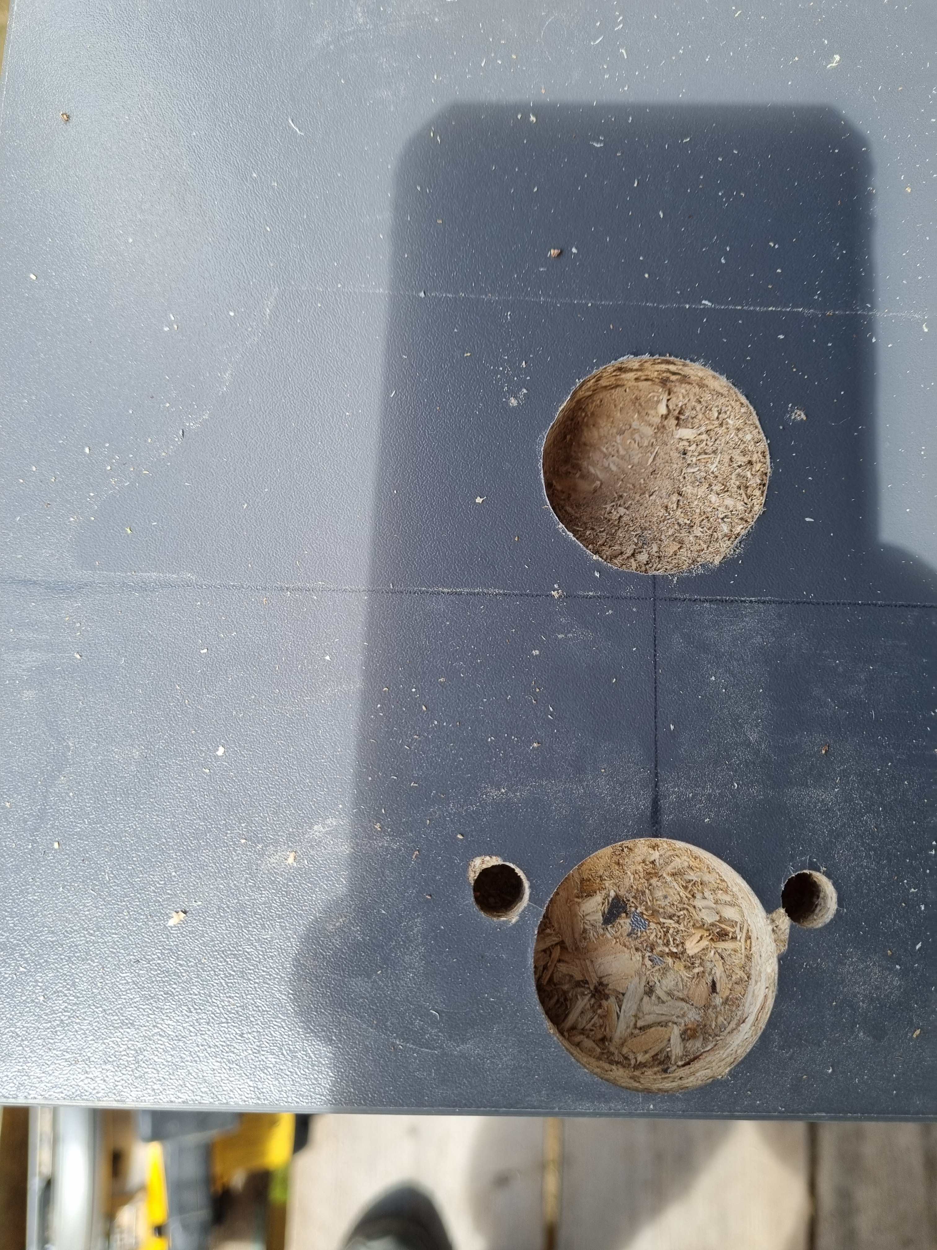

BotusBuild Posted June 27, 2025 Author Posted June 27, 2025 (edited) template made of three layers of wide masking tape. Original hole below Using a router freehand created the new hole. Note, door not cut to new width in case of a cock up, and it also supports the router Door cut to width and screw grubs refitted. And finished doors fitted. Worth a 🍺? Edited June 27, 2025 by BotusBuild 1

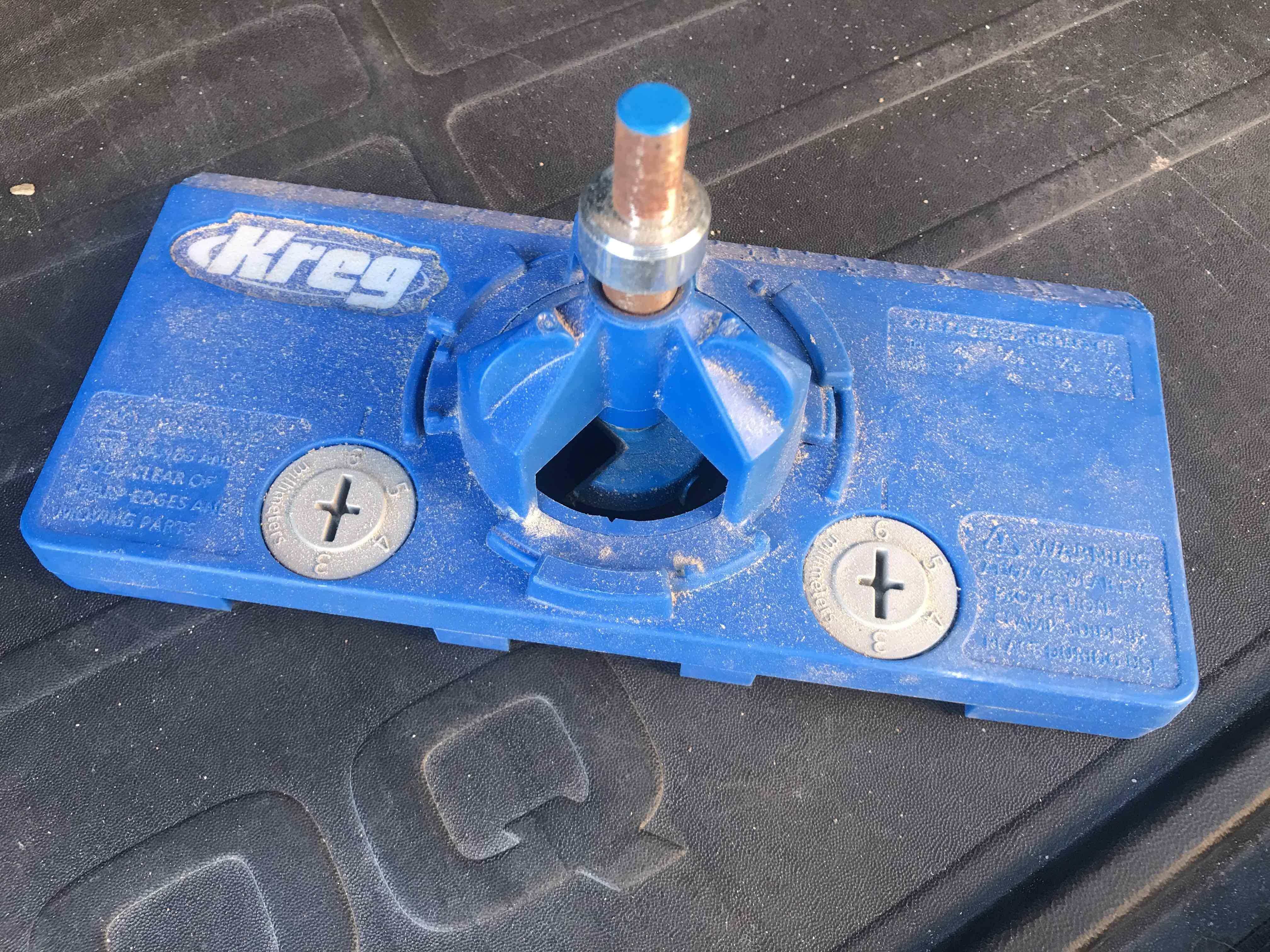

Nestor Posted June 27, 2025 Posted June 27, 2025 4 hours ago, BotusBuild said: Worth a 🍺? Definately deserve a beer but careful now as you will be asked to make fitted wardrobes next! It happens. The Kreg is a bit unnecessary as cheaper tools for hinges are available.
