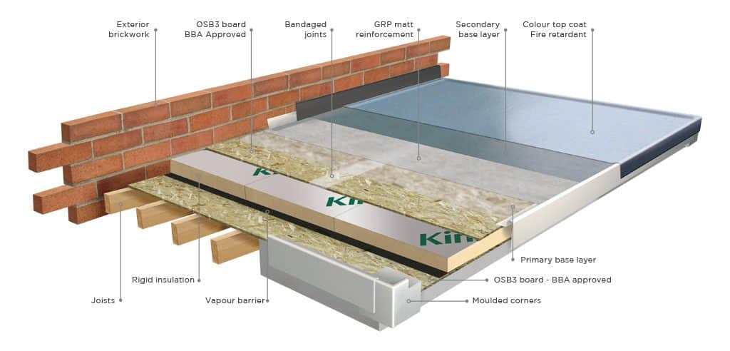

I would far prefer something like this.
GRP/EDPM
18mm OSB
25*75mm battens across the joists.
25*75mm battens up the joist with the void fully ventilated at both ends.
Breather membrane
Rigid insulation.
Furring strips.
18mm OSB diligently taped as airtightness.
Joists .
Plasterboard
I would also happily install insulation between the joists if I was doing it myself for a hybrid roof. However I  understand the issues and am picky about details.

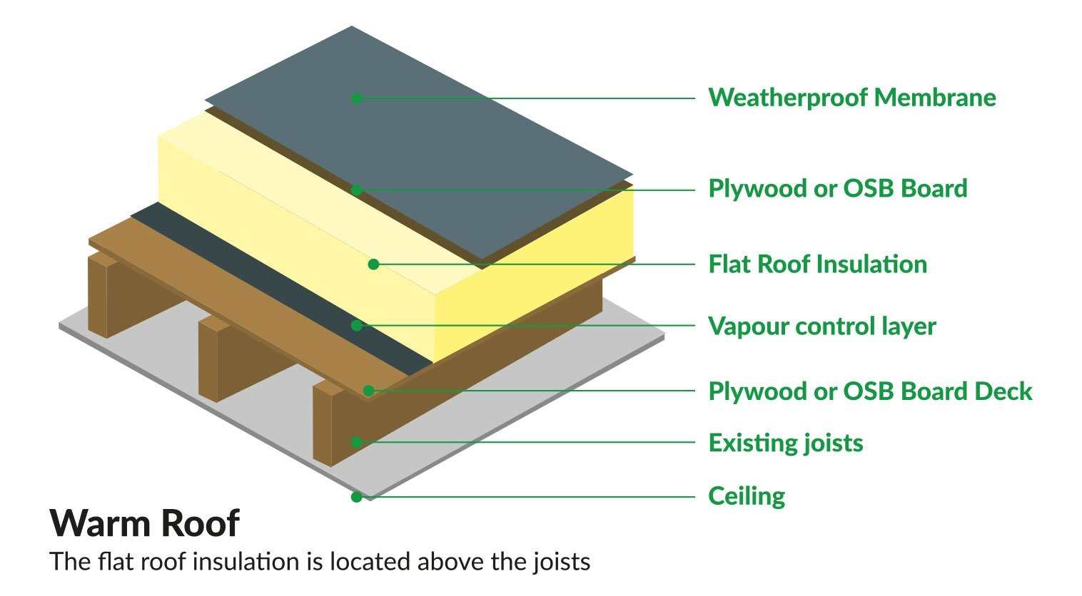

Also I would prefer something like metal cladding as instead of EDPM or GRP as it isn't weather dependent for install and as vulnerable to imperfect workmanship.
Posted
1 hour ago, Iceverge said:
The layer of OSB under the is GRP is the ultimate stopping point for the internal vapour to condensate. I think these will start to rot out and nobody will know until the roof leaks.
That should not be there on a proper warm roof.  No timber on the cold side of the insulation.
Posted
what's a proper alternative though, in the instance of EPDM or GRP, im not convinced straight onto PIR is a good move.
I would rather have EPDM or GRP on OSB or ply personally.
assuming the VCL is a good one and fitted properly, assuming the PIR is foil faced and taped, and assuming the fixings holding it all together are thermally broken where is the moisture coming from to cause the interstitial condensation that is going to rot the top layer of treated wood?

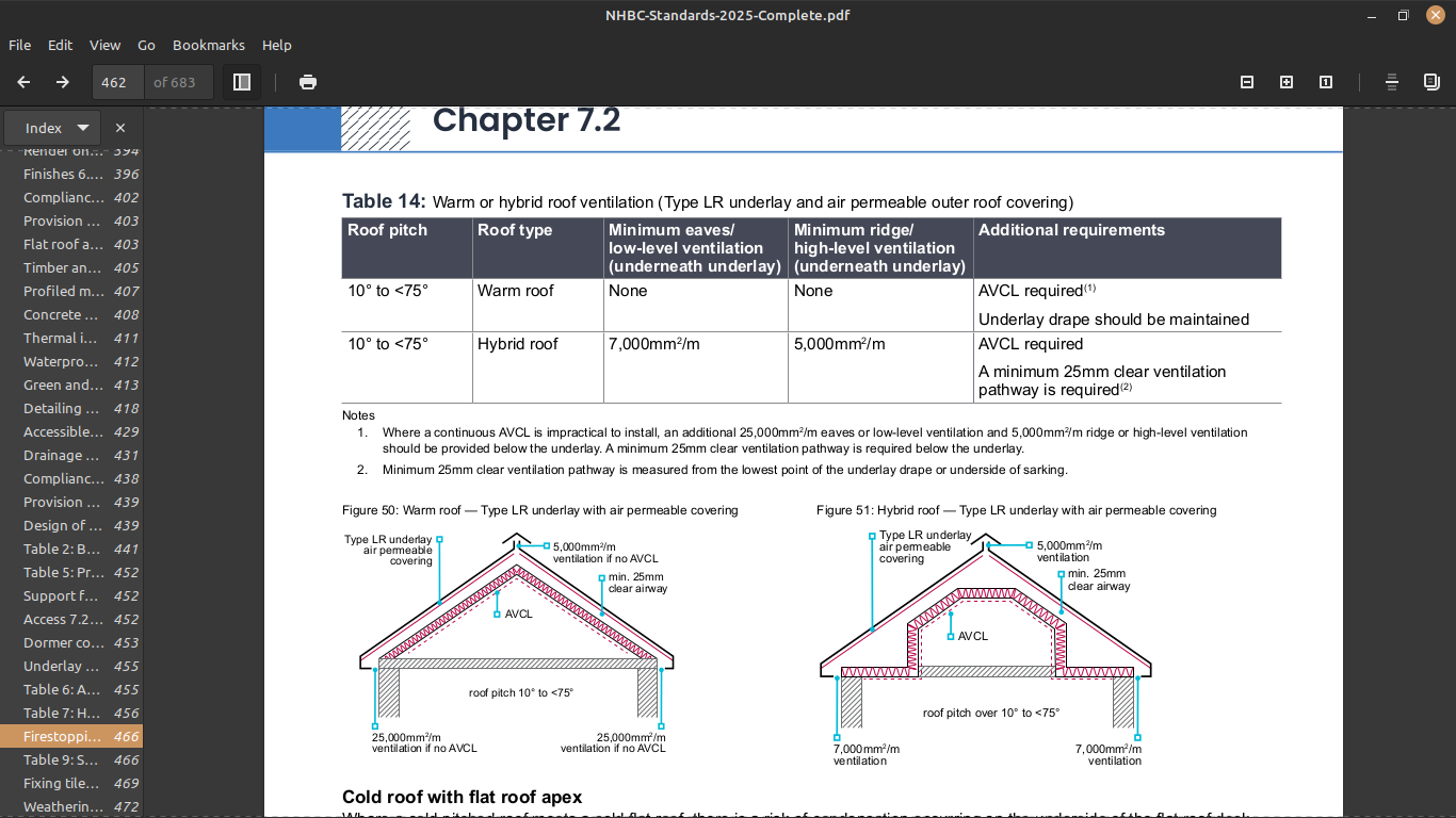

NHBC chapter 7.2 deals with ventilation for pitched roofs.  Table 14 (see attached) suggests that where a VCL cannot be used then ventilation is acceptable.
Admittedly it seems worded in favor of a VCL but doesn't seem absolutely necessary if have ventilation.
It's there in pretty much every detail. That comes up on Google so I assume that's how the majority are built too. Ply or OSB above the insulation.
I think you can get some types of insulation with specific fleeces bonded to one side to take grp/EDPM.

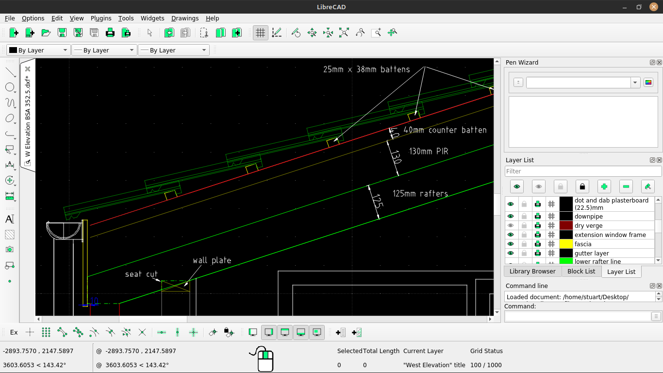

I've attached a section showing the roof build up:
Renown concrete tiles
battens
underlay (HR or LR?) draped over counter battens but with a clear gap above the PIR for airflow.  (Underlay not really visible on drawing attached)
40mm counter battens
130mm PIR
125mm C24 battens
Regular plasterboard on underside of rafters (not shown)
Guess any VCL would have to sit either immediately below the PIR or perhaps above the plasterboard...  That said many reckon foil-backed and taped PIR basically is a VCL.
Full plans are being drawn as we speak so excuse the total lack of detail shown at the eaves.  Indeed, I'm not even sure if I can possibly set up a good air flow with the way its currently drawn, what with the air needing to get into the low>high channels formed by the counter battens, this would be difficult given the vertical distance from the air entry point (tiny 10mm gap between rear of fascia and wall) up to the counter battens.
I'm starting to think a VCL with no low>high ventilation may be the easiest way to go.

You have a very thick roof profile with minimum insulation. Have you looked an outer membrane that requires no ventilation air gaps, then use a deeper profile rafter, and full fill with 250-300mm of mineral wool? Then underdrawing with 25mm PIR or insulated plasterboard? Way more simple to construct and less reliance on the workers doing a good job of installing the PIR into all the gaps.
Posted (edited)
Top down,
Tiles
38mm Tile Battens across the rafters
25*75 Battens up the rafters
Glidevale VP400 membrane.
11mm OSB taped at all joints.
200*44mm rafters at 600cc full fill with blown cellulose ( or mineral wool batts)
Airtight membrane,
45*50mm battens at 400cc across the rafters with 50mm mineral wool in the service cavity .
12.5mm plasterboard a skim.
U value about 0.17.
Edited by Iceverge
