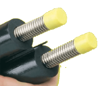

newbuild upnorth Posted June 19, 2025 Posted June 19, 2025 Does anyone know the specifications of the flexible hoses used on ASHP. is it just 10 bar epdm lined hot water hose with a stainless braid? Basically im looking for longer hoses so i dont have to go from flexi to pipe to flexi to pipe and in doing so reduce fittings and connections.

Nick Laslett Posted June 19, 2025 Posted June 19, 2025 (edited) 58 minutes ago, newbuild upnorth said: Does anyone know the specifications of the flexible hoses used on ASHP. is it just 10 bar epdm lined hot water hose with a stainless braid? Basically im looking for longer hoses so i dont have to go from flexi to pipe to flexi to pipe and in doing so reduce fittings and connections. Spec of the Intatec ashp flex hose you can buy from BES. https://www.intatec.co.uk/product/heat-pump-hoses/ I think the MCS MIS 3005 requirements might dictate the specification of the flexible hoses, but I could be mistaken. Here is a thread with discussion on this topic, with links to other threads. People seemed pretty relaxed about the exact flexi pipe requirements. I think the main part of the spec to worry about is suitability for high temperatures. There is a minimum bore to match the amount of heat you want to put into the system. This thread has some good details about a DIY insulated ASHP pipework including flexi hose joined to other pipework. Edited June 19, 2025 by Nick Laslett 1
newbuild upnorth Posted June 19, 2025 Author Posted June 19, 2025 35 minutes ago, JohnMo said: The Flexi is just there to break any carried over vibration that could be transmitted through solid pipe. Why would you need multiples. Various lengths here https://www.bes.co.uk/heating-ventilation/renewable/air-source/hose-fittings/?gad_campaignid=21010157190&gad_source=1&gbraid=0AAAAAD9gc2nUit89wBNyhSlbWINtellFp&gclid=CjwKCAjw6s7CBhACEiwAuHQcko06ksxFJVc4OnBQtzTzjmFROda-qjnPCdSxWj2tc56-A6t3EU11fBoCwTYQAvD_BwE Well if i can get long ones i wont need multiples. I need flexis off the unit then also flexis up my ducts. if i can be confident in the spec i dont see any reason not to run hose from the unit to inside the house, potentially less heat loss, less joins, less turbulence? I dont see any negatives.
newbuild upnorth Posted June 19, 2025 Author Posted June 19, 2025 Thanks for that @Nick Laslett thats just the info ive been searching for. looks very similar in spec to this stuff which i could get by the meter and get hose tails for, ill search some more to make sure theres no max guideline for hoses but i cant see why there would be. Im not planning on going crazy just 1.5 - 1.8 meters maybe.

Nick Laslett Posted June 19, 2025 Posted June 19, 2025 Secon Renewables an ASHP supplier to installers does a very long insulated flexible pipe that is from their Solar Thermal installs. They talk about it being used for ASHP installations and now list it in the ASHP ancillary section of the website. https://www.seconrenewables.com/flexipipe-coils-8463-p.asp 1
