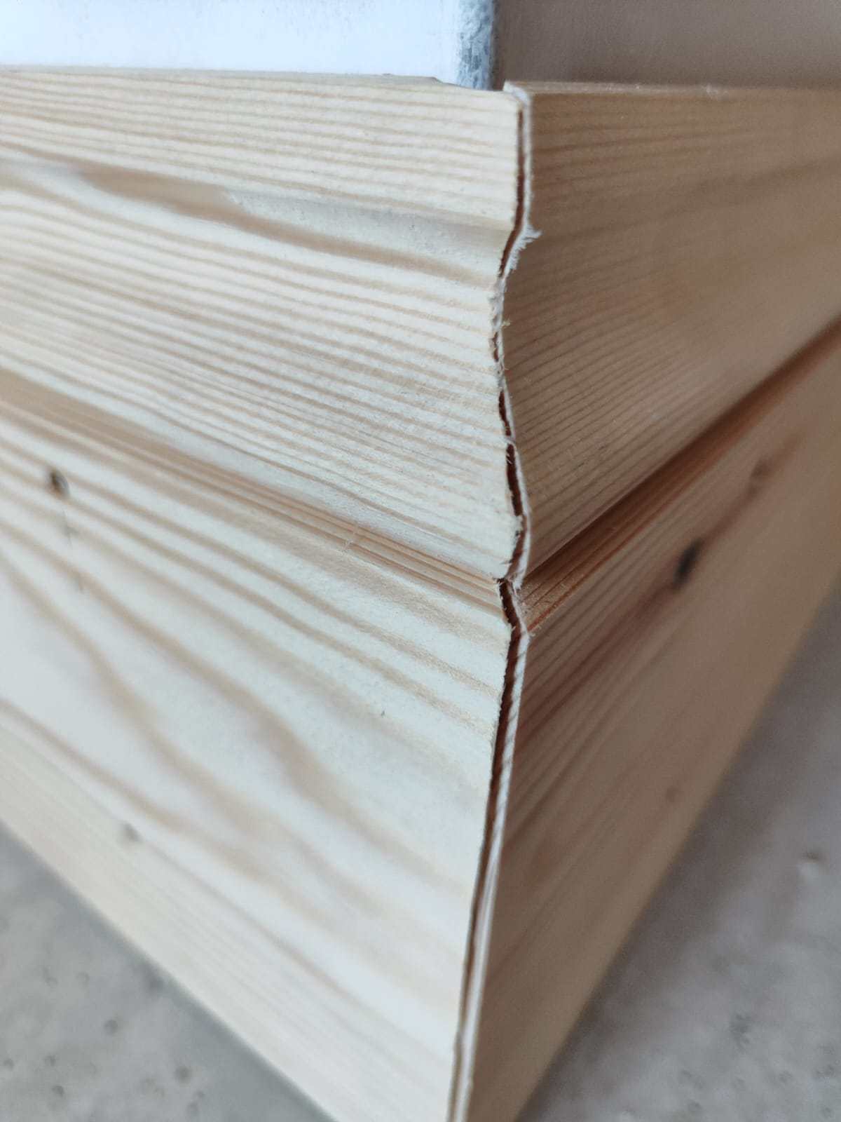

Do you know the trick for cutting the scribe? Eg you cut it with a mitre saw and then run the coping saw along the line?
I use the mitre saw to cut up the vertical line first and stop short of the detail, as that gets a nice clean edge, but this method also allows you to correct an angle if you’re meeting up with a previous piece they’d not perfectly plumb.

The benefit of a scribe is you can be tight or a few mm loose and it doesn't usually matter as it gets caulked in at top of skirting. Try to keep scribes all to the same side of the skirting so you work 1 way round room.

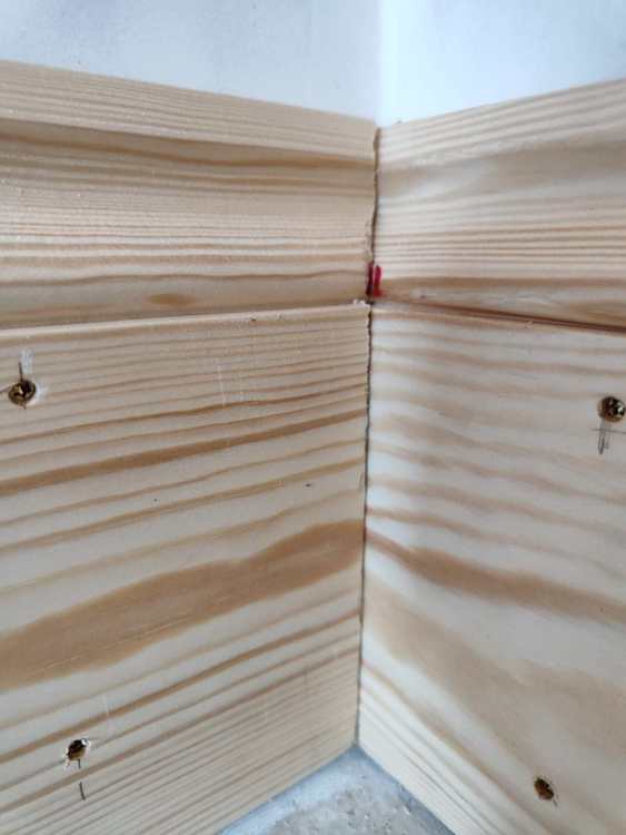

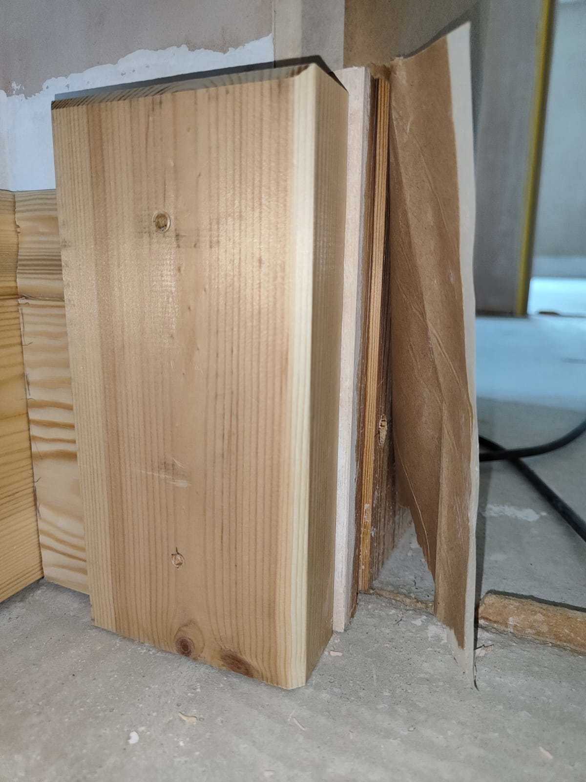

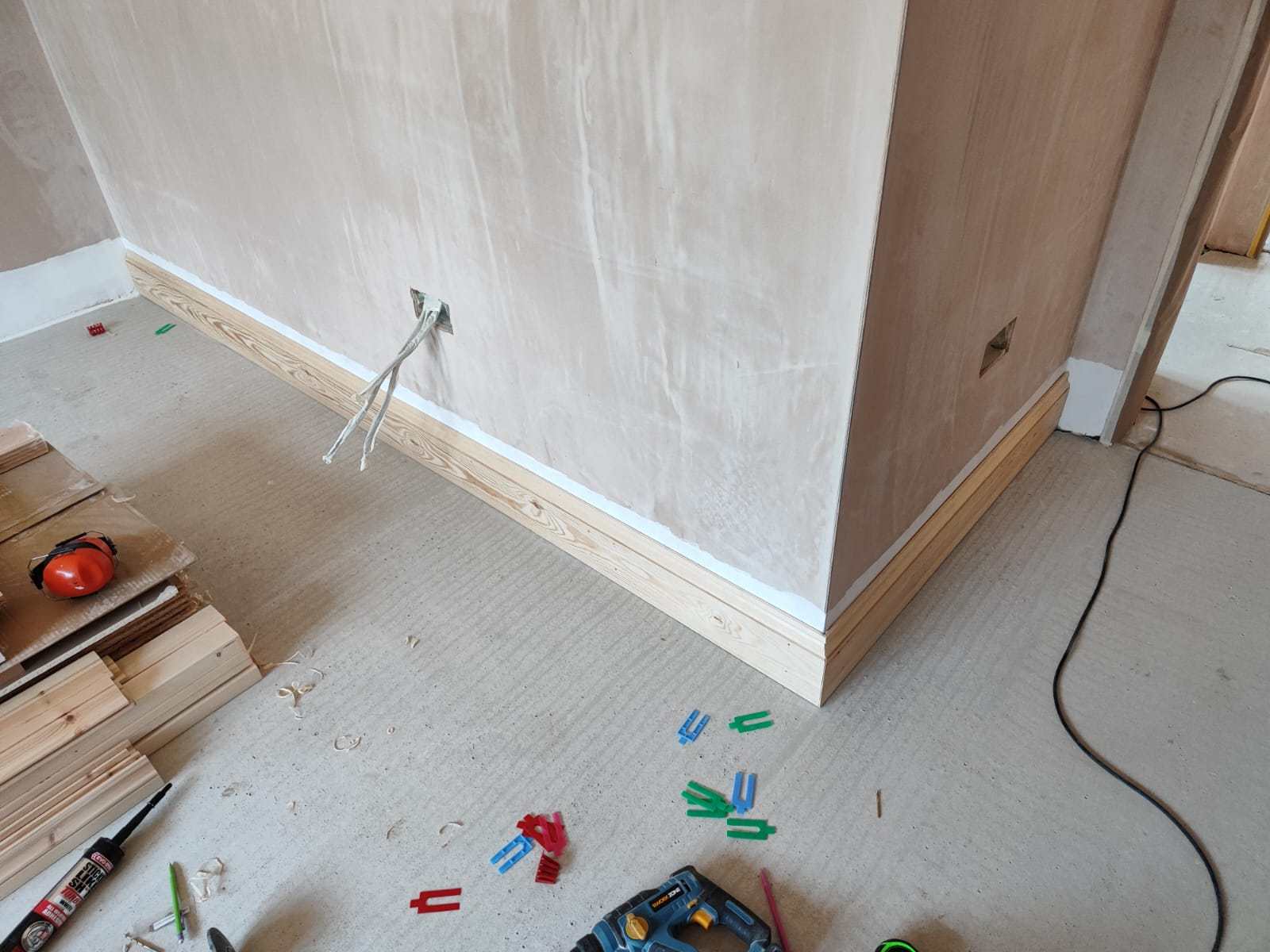

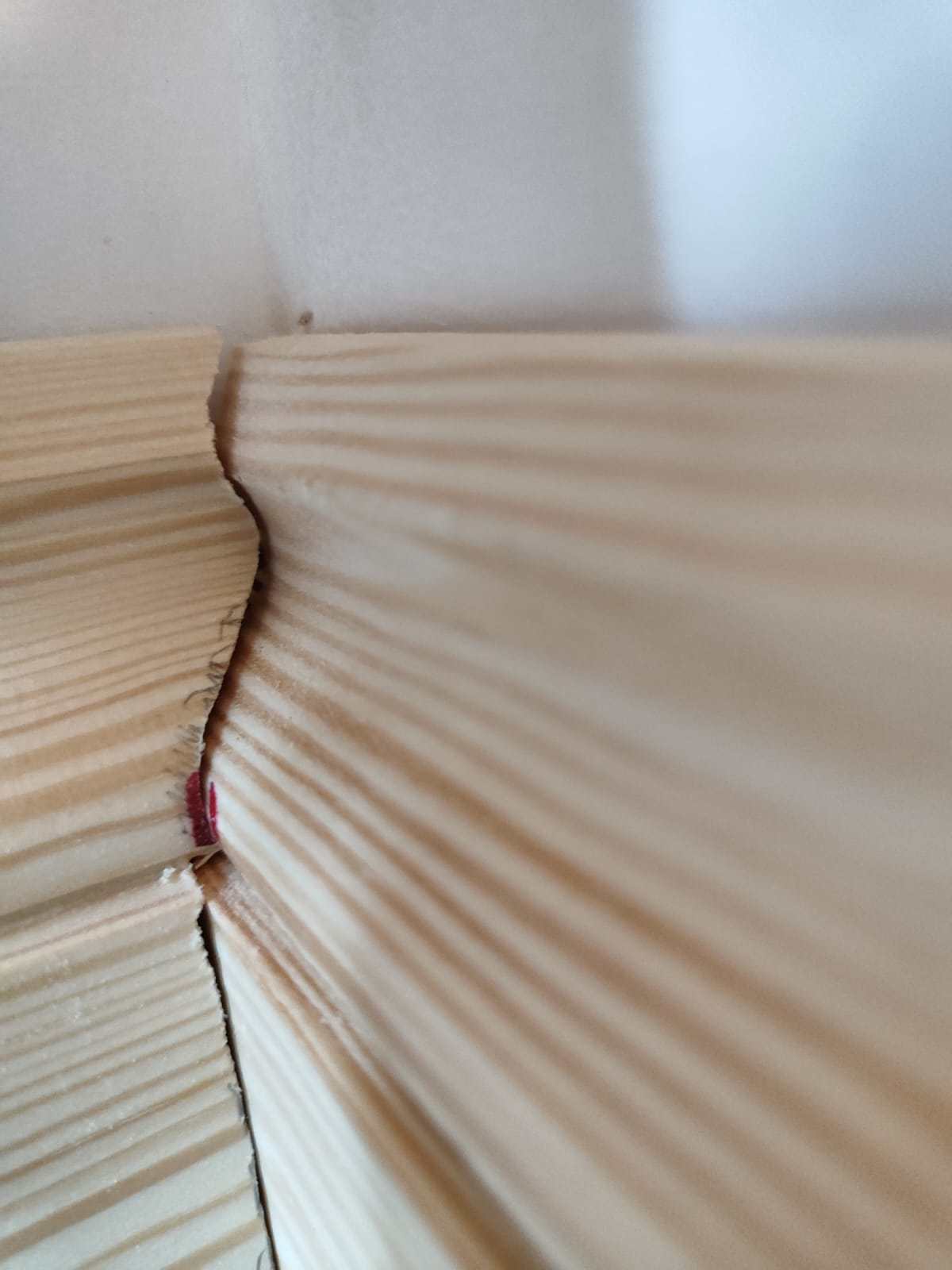

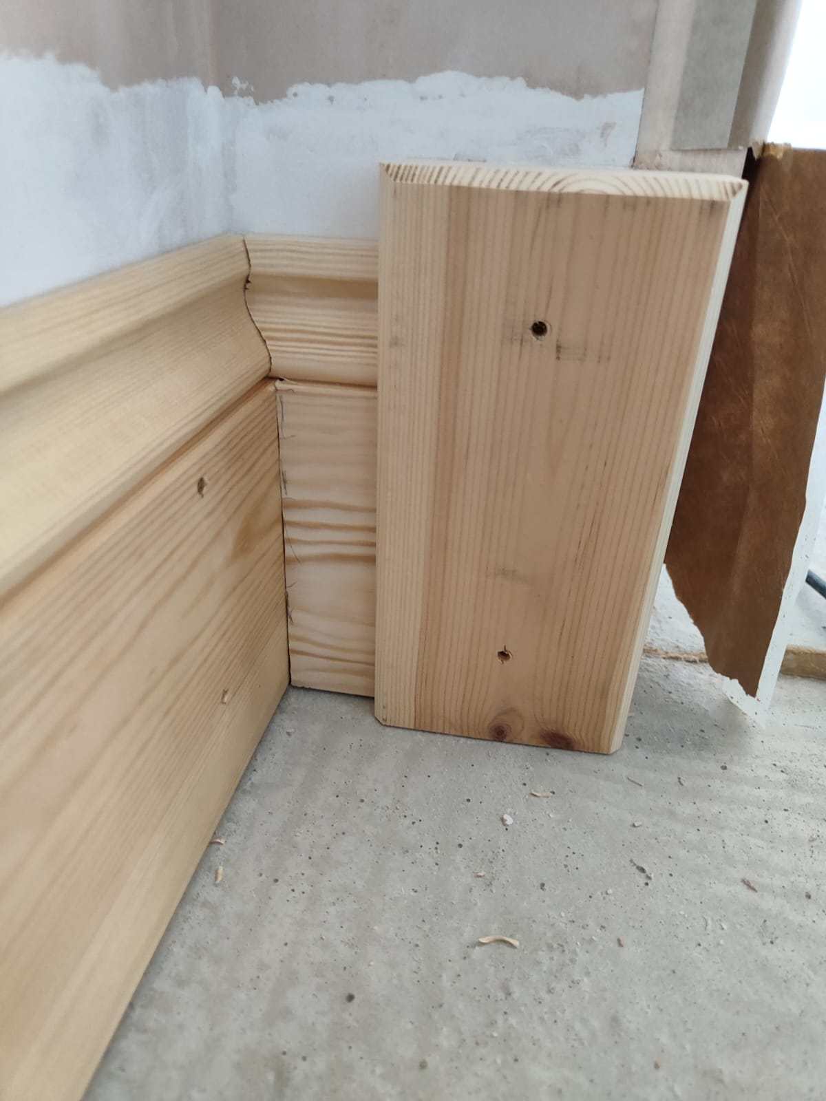

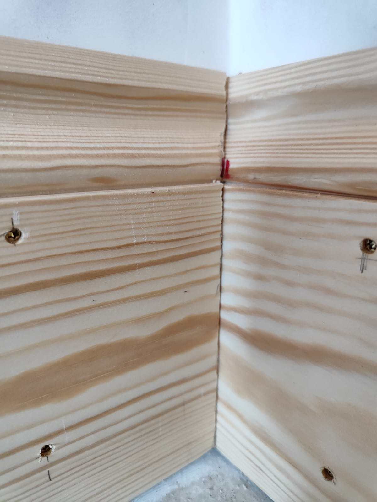

First room done, all to be filled and painted. CT1 and Lost-Tite screws. My external joint wasn't very good but I prioritised the detailed portion. Also, not very good at coping but hopefully filler will hide my sins.
170*20 ogee skirting with 90*32*190 chamfered plinth blocks.
External corner:
Coping:
Plinth block:
