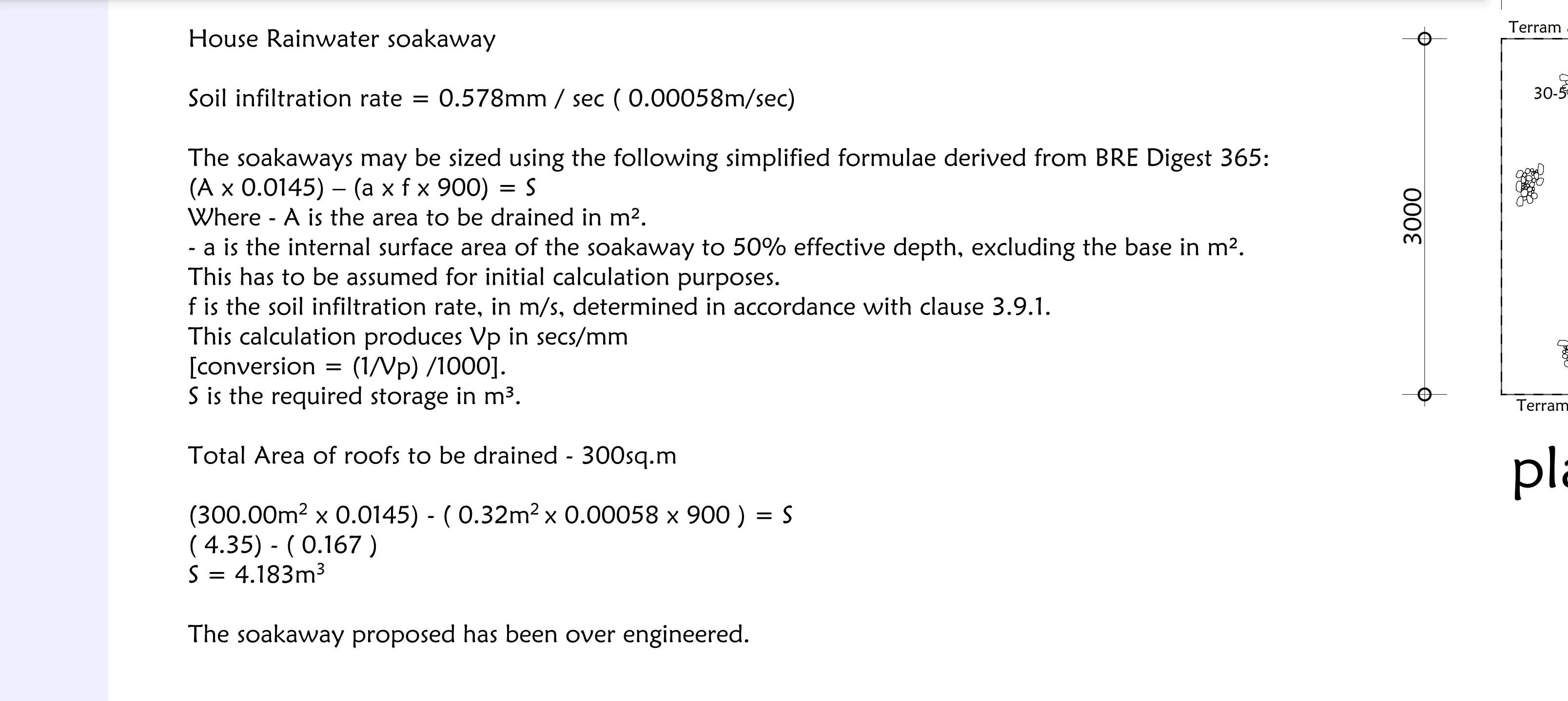

Posted
That sounds huge for a rain water soakaway, thought the size was for a treatment plant soakaway.
Our roof area is about 300m²
This what our drawings show, with the calculation
Screenshot_2025-06-18-18-13-03-03_e2d5b3f32b79de1d45acd1fad96fbb0f.thumb.jpg.c1a098f0dbe02cddad907c6d27afa2a9.jpg

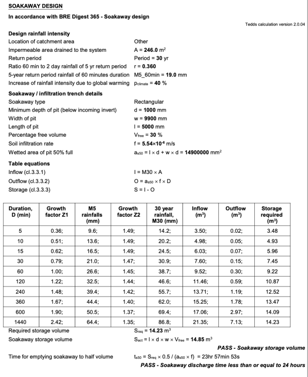

Posted
Here's the engineering calculations. I might try resubmitting them tomorrow to see if this is over engineered.

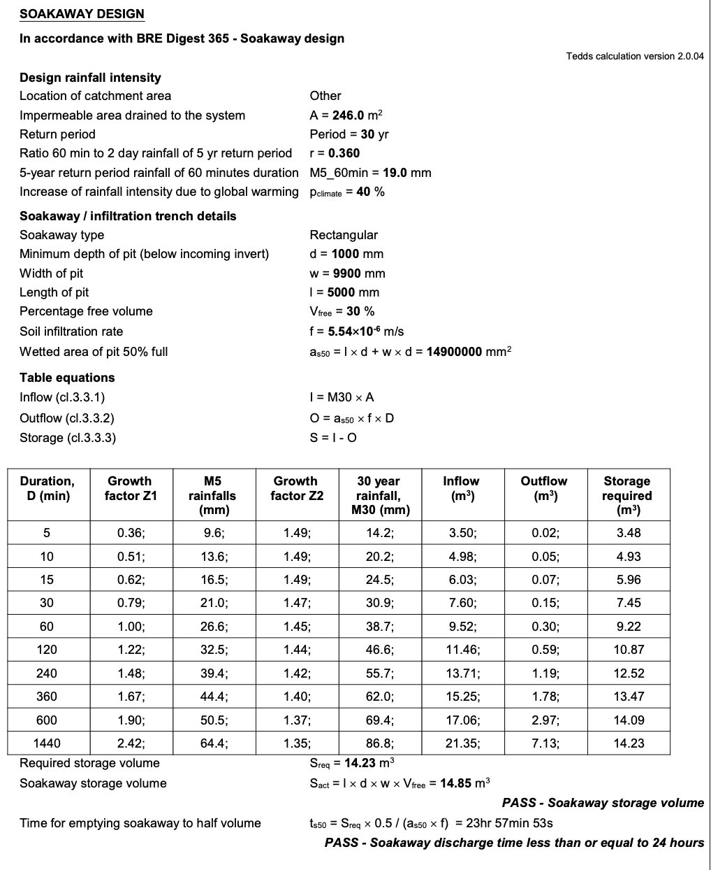

Posted
Unless I'm missing something those calculations state that the required soakway volume is 14.85m2 - your proposed dimensions: 6.2 x 8.7 x 1.0 give a total volume of ~54m2

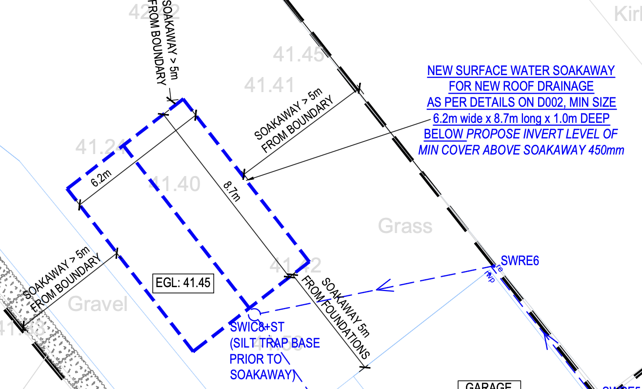

Posted
Here's the warrant drawing. I think that it is far too big. But the calculations above say 9.9 X 5 X 1m, pretty much the same. Adapted to be 5m from all boundaries, apparently hence 8.7 X 6.2 X 1m.

Posted
In anticipation of getting our own soakaway sized, I've been trying to put together a spreadsheet based on the methodology set out in BRE Digest 365 (2016), so I can do it myself.  It's a work in progress and I've gone down the rabbit hole with it over the last few days.  I've noticed that the soakaway construction type has a huge influence on the size of the hole you need.  Your calculations note a 'percentage free volume' of only 30%, i.e. 70% of your hole is taken up by your gravel fill. Plastic soakaway crate are mostly void - about 95% free volume, so less of your hole is taken up by the crate material itself so you can get away with a smaller hole.  If your 15m3 hole is costing £3k in gravel, a smaller (say 10m3?) hole might cost £2k in crates (e.g. 10 x 5 crates/m3 = 10 x £40).  Plus there's the difference in excavation cost and muck away.
Posted
Correction: your current design is for a 50m3 hole filled with gravel to obtain 14.85m3 water storage. By my rough calculation you may only need a 15.5m3 hole to get the same storage from crates. So you might spend £3k on crates but much less excavation.
