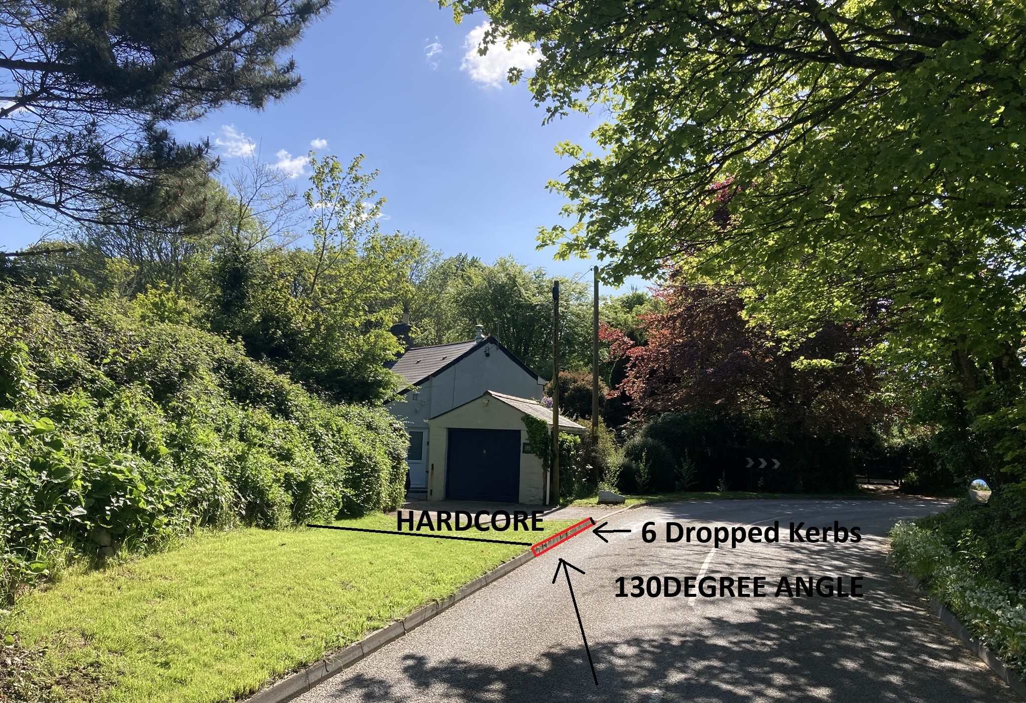

Hello, I submitted a planning application to drop a further 6 kerbs outside my property. My local council has come back and asked me to add existing and proposed site levels to my Site Plan.  I cannot afford to approach a surveyor, so I have been researching how to measure site levels. I believe that once I have established a datum point, i can simply use string and a spirit level to take measurements on how the site levels increase or decrease in relation to my datum point.
Can I just place a brick on the centre of the site and measure levels out to each of my boundaries in a 360 fashion and measure and plot the site levels in relation to that brick?
I have attached a photo showing the site to provide some context. I would be grateful for any responses.

If it does not specially state ordnance datum levels, then set your own starting with 10.000m for example.
Thank you. I have just seen a plan that I think it using a 10,000m scale as you suggested and it using a BT box as a Datum point. I will try and attach the file to see if it is an example I should follow. Thank you for your help.

Road=100.00.
Dropped kerb=100.025.
Grass=100.150.
Thank you ETC, so I set a datum point as the road in front of my property and set that as 100.00mm then I measure up from that, to the top of my dropped kerb say 100.05mm and then the grass as 100.15
Very simple - set your road as 100.00 and measure everything from that datum - up for dropped kerb, higher for the grass. Keep it simple.
