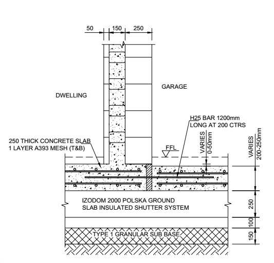

le-cerveau Posted December 22, 2017 Share Posted December 22, 2017 7 minutes ago, Nickfromwales said: How would one go about that ? Our slab has one, this is the cross section of it from the SE drawings, it separates the house from the garage. As you see the garage has thick ICF as an internal wall against the house. The Garage also has a variable level (slope to the garage door) to cover Building Regs requirements, as we have a level access into the house. Link to comment Share on other sites More sharing options...
Nickfromwales Posted December 22, 2017 Share Posted December 22, 2017 2 minutes ago, le-cerveau said: Our slab has one, this is the cross section of it from the SE drawings, it separates the house from the garage. As you see the garage has thick ICF as an internal wall against the house. The Garage also has a variable level (slope to the garage door) to cover Building Regs requirements, as we have a level access into the house. That's all fully supported from underneath, but I doubt it could be applied to @LadyBuilder 's slab as its unsupported at the junctions where the thermal break would have to be. . Link to comment Share on other sites More sharing options...
le-cerveau Posted December 22, 2017 Share Posted December 22, 2017 Re looking at it surely you would want the slab that is over the basement enclosed in insulation so the break would be where the slab is on-top of the basement walls, if the slab extends beyond that. So insulate over the slab to the Ground Floor Walls, so the slab contributes to the "Thermal Mass" (I will be shouted at). Then only put UFH pipes in the appropriate sections of slab. I suspect it will end up being precast concrete spans as cast in situ could be difficult for that! 1 Link to comment Share on other sites More sharing options...
